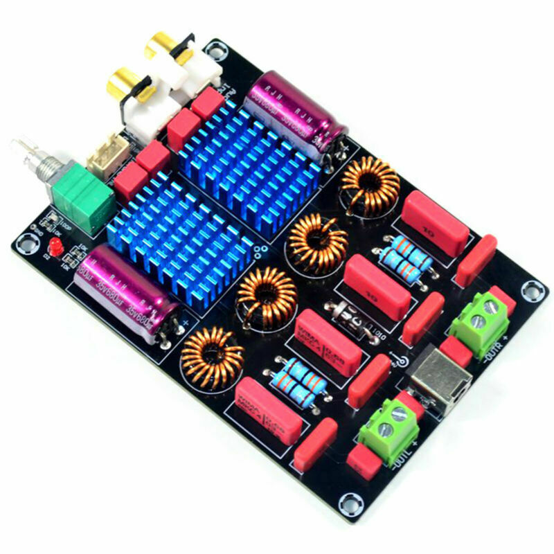

Hi. Does anyone have an opinion on this board (see attachment), have you tried it for sound quality, how does it compare with rival tpa3116 boards. It has been mentioned on this thread but no feedback.
You are right, it would be nice with someone who has experience with this board (I do not).
Looks nice but I have two less appreciating comments:
The heatsinks seems to be glued to the TPA3116 chips and the power line decoupling capacitors are 2x680uF which is little for a PBTL-coupled amplifier (for low impedance loads).
I am liking the lack of components in the signal path, perhaps giving a cleaner sound.

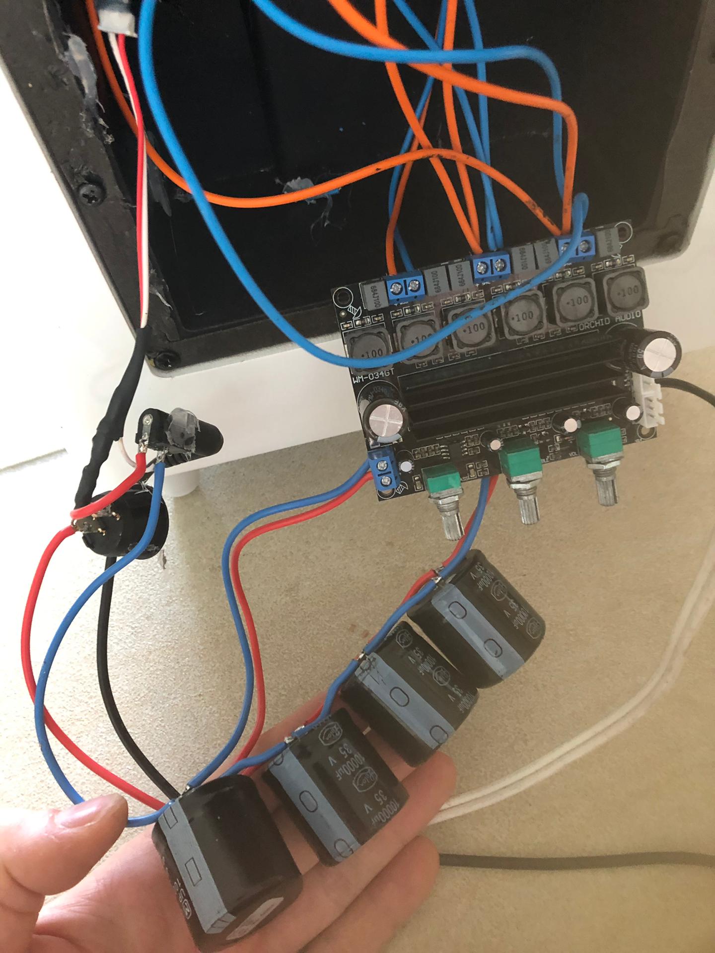

I'm back. I had always the same stops at high volume. I just soldred 4 10000uF caps and yet no problem.
I think my powerbank has to high impedance :-(
Powerbank is 4P5S Panasonic CGR18650 2250mAh so its 18V 9Ah. Thins one I had two pieces :-D
I had another powerbank with Panasonic NCR18650 2900mAh with bigger 11.6Ah capacitance.

So, with the 4x10000uF caps in parallel with the batteries, it works?
I recall someone, perhaps Turbowatch, mentioning that batteries have a delay in providing current. Perhaps this is just evidence of such an effect in batteries.
