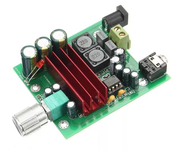

I have ordered this amp a couple of days ago from Banggood - before I discovered this thread. It is a 100W (4Ohm) bridged version with low pass filter for driving a sub.
Can anyone point me to post numbers that detail the best mods, please? I really can't see myself reading through eleven thousand posts.
TPA3116 D2 8-25VDC 100W Mono Subwoofer Digital Amplifier Board NE5532 OPAMP
Are you wanting to alter the crossover frequency? From what I understand, it's fixed at 150Hz.
Banggood doesn't specify the crossover frequency, but from a YouTube video I gathered that it's set at 70Hz. So yes, I'd probably want to change that.
Hi Skylar88
its a sub amp board and according to the datasheet for PBTL = Mono you can use 10µH coils. the original coils are about 2 -3A so not much current. generally search for coils with less DCR and better current availability. -->Bourns SRP1250-100M
chris
Look at the inductance vs current curve.
https://www.bourns.com/docs/Product-Datasheets/SRP1250.pdf
Better choice:
https://katalog.we-online.de/pbs/datasheet/7447709100.pdf
With reference to testing done by doctormord, lower distortion is related to inductance vs current curve being flatter.

Hi Dug
thank you. it nice to have an advice by a developer.
any idea for a SMD 27µ- 33µ the WE-PD is about 3 Amps. is there something better ?
7447709270 is about 4,6A
chris
Ok, I saw where they mention 10µH inductors in the datasheet, but I have to ask this question - will that change the crossover frequency? And to what?
I'm aiming for anything between 90Hz and 100Hz. Is there a calculator, formula or graph with which one can determine the inductor value for a specific cut-off frequency?
Hi
in generally the output filter at a Class D is working as a low pass filter because the amp is working with about 400khz PWM signal. so a music signal get together with a PWM modulator to the output pin of the class D chip and then you need a filter. ... EMI . in your case you use the amp as sub woofer so the cutoff frequency (..40-150hz) is not affected.i you choose a coil with lower value e.g. 10µH you have less resistance because the winding to get this 10µH are less then e.g. 33µH.. its physic. the fatter the cable is the coil get bigger - expensive but it can handle more current. so DUG´s example are fitting well to your amp.

High pitch whistle
I've got a TPA3116D2 module that emits a high pitch whistle through the speaker when using a Meanwell GST60A18-P1J (18V 3.33A).
It's a blue/black module but this one has yellow caps and the MF resistors on the output stage are SMD. Playback with 12V 2A and 19V 1.6A SMPS have no such issues but another SMPS 19V 3.16A has the same issue. I thought it might be feedback from a 12V relay in the amp but turned out to be a ground wire that runs from the pot body (Bourns 10K PTD902) to pot PCB ground. Removed this wire and all is quiet. It's an odd one as the other blue/black module I have needs this ground wire to remove hum when used with an Alps 10K RK27.
Very odd that the voltage seems to be fine but increase of the current causes a noise. I don't need a fix as the other SMPS works fine. In addition, I tried the Meanwell with another TPA3116D2 module and no noise but it's in a plastic and not metal case.
