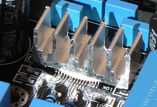

Have a TPA3116 blue/black module I just received and there's solder flowing across several of the pins but it all seems to work fine. All the other modules I've had have been very neat with spaces between each pin.
Amazingly there doesn't seem to be any shorts.

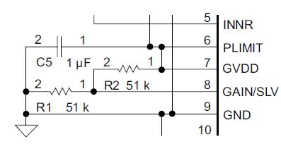

I have a question on the gain/impedance settings for the 3116/3118 chips. From the datasheet I infer that GVDD is a voltage source for the R2/R1 voltage dividing network. The GAIN/SLV pin senses the voltage at the R2/R1 junction and sets the gain and input impedance according to one of 8 voltages ranges that are determined by the different resistor combinations.
My question concerns the 20 dB MASTER gain setting. The data sheet specifies an open for R2 and 5.6K for R1. Since R2 is open the GAIN/SLV pin should sense 0 volts so how important is the R1 value? I'm considering modifying an amp that is set to MASTER mode with 32 dB gain (R1 = 39K, R2=100K) by just removing R2 and leaving R1 as is. Problems?

No problems with that.
