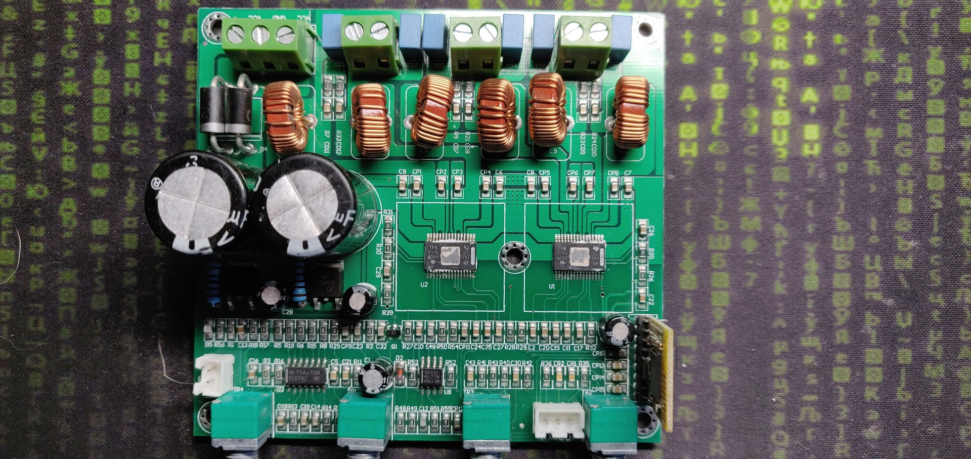

One more try with these pre-made 2.1 boards, this one was recommended by some hobbyist in his youtube video.
It's supposed to have adjustable bass level and cross over, treble knob and total volume.
First impressions (24V & 5A supply brick):
-Way too high gain
-terrible hiss (worst when the total volume knob is at most counter clockwise position
-treble pot not only affects the treble, but also mutes the other channel

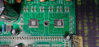

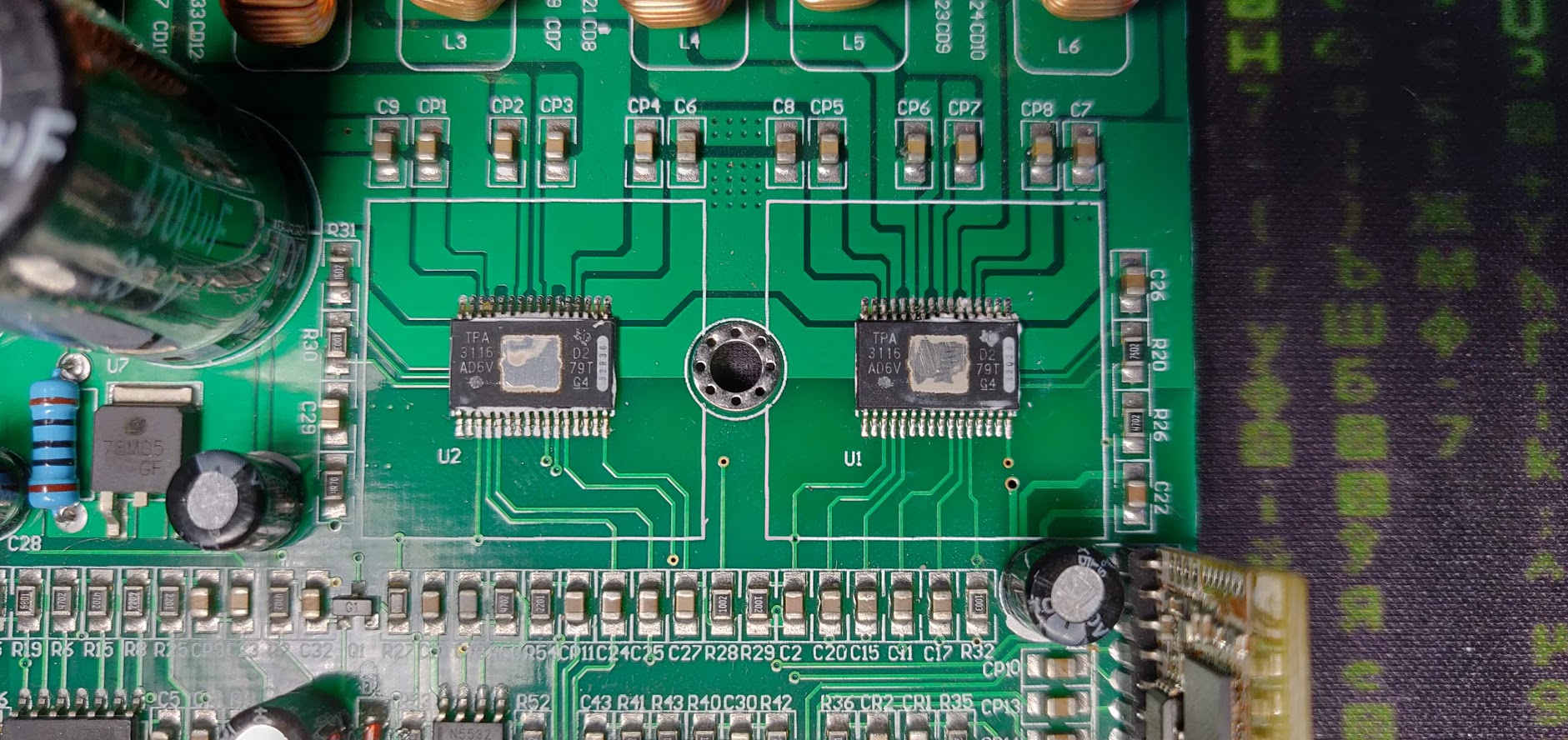

I'm attaching couple pictures, because I'm going to try to lower the gain, but I need some confirmation about the layout.
Left chip is for the sub. Looks that the R30 (100k) and R31 (16k) define the gain. But should they be the other way around for slave mode and 36dB gain?
Right chip is for left and right channel. R20 (75k) and R26 (47k), so this is set to master and 36dB gain, right?
When reading the posts here, I get a feeling that all the reported problems with noise are caused by lousy implementations of the integrated preamps/filters/attenuators. Plain amps with correctly separated inputs/outputs/power lines/output inductors are OK. Plus of course feeding the amp in balanced mode to avoid ground loops with the source.
Honestly, I would prefer a preamp board physically separated from the main amp. If the preamp has no balanced output (very likely), feeding the amp powered by the same PSU in quasi-balanced way. IMO no reason to be noisy, the actual amp can be dead-silent for the tiny price.
