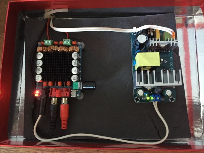

So this board eventually arrived - well delayed by our postal authorities. It looks to be genuine Sanwu, nicely made with a very odd input/power/output configuration. Plastic stand-offs/feet and a volume knob were included with the board. The package took a hammering (2 months in transit) but the components were really well packed and reached me unscathed. I've hooked it up to the SMPS that I got from the same seller, and connected a pair of JVC speakers from a micro/mini player, the amp of which expired some years ago.

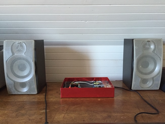

I don't have the linguistic skills to explain depth, speed, sound stage etc, but to me, it sounds excellent. The JVC speakers are rated at 6ohm, 45w I think, and the amp drives them cleanly and with way more volume than I'll ever need. I'm using a laptop stocked with MP3s as the source, took a bit of bodging with the integrated equalizer in WMP and it now sounds great.
I put the board and SMPS box in a conveniently-sized box for now, the cable routing is obviously not optimal, but it works well and I don't get any bad noises apart from a bit of a hiss if I really wind the amp up with source attached but not playing. Considering the component cost and the crappy source, I'm well impressed.

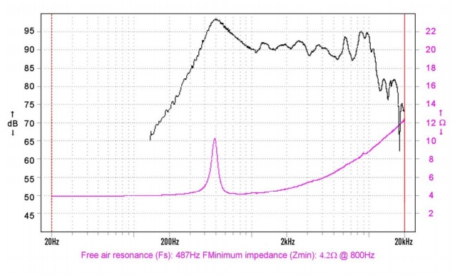

You have more excessive peaking below 20kHz with 30kHz filter(33uH) than with 60kHz (10uH) filter when it peaks at those frequencies. You don't have that problem when you create a near constant impedance, like the resistor you used to watch the overdamping. Speakers usually have rising impedance
10uH for 4 ohm, 22uH for 8 ohm. 33uh is likely what the mfg had on hand (no Quality control).
Yes, speakers have rising impedance and a high, sharp rise at their resonant freq.
