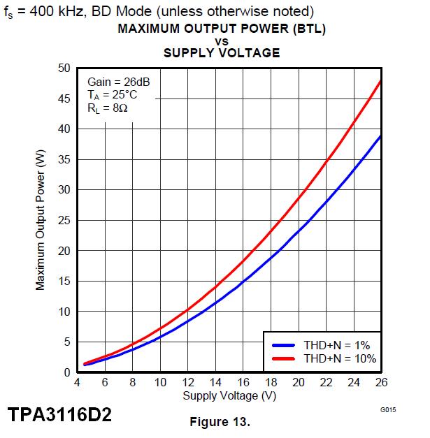

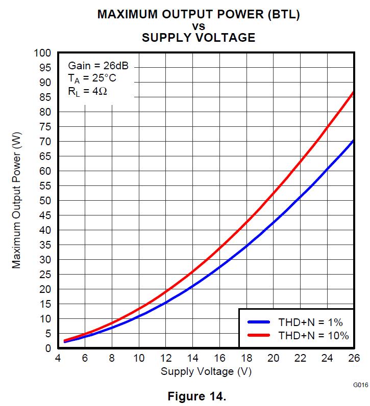

I would like to 100 x 2 as the speakers I have 8 ohm.
No matter what the board listing says or who made it there is a limit of what the TPA3116 will do.
These are from the data sheet.

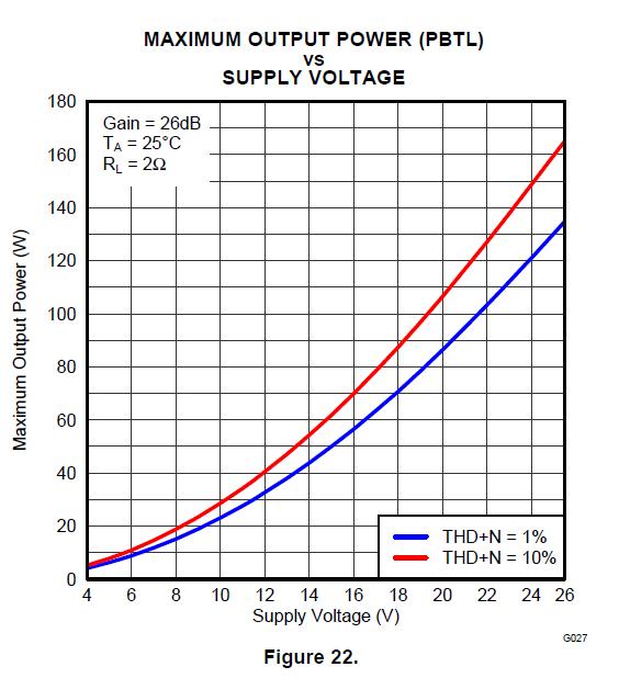

Is this chip trustworthy/stable on 2ohm? supposing we have a 2.1 board with 3 speakers on 2ohm and maximum input voltage, that should be a lot of power coming from those little ic's, is it like everything supossed to go fine as long as there are good heatsinks?
I have not run one on 2R.
I have run a FAST using 4R as the woofer on a PBLT.
Works very well...so the neighbors at their party said.
