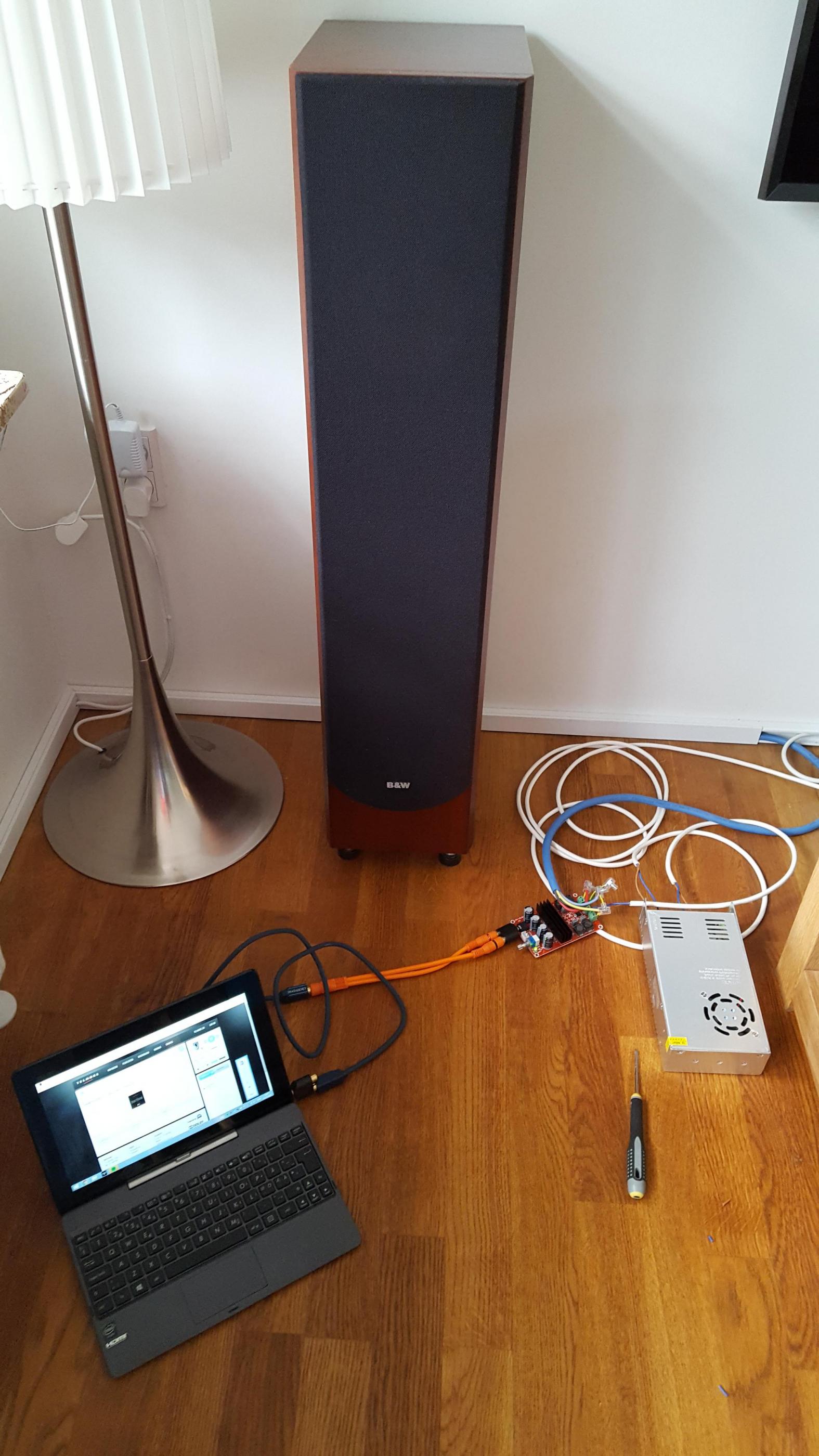

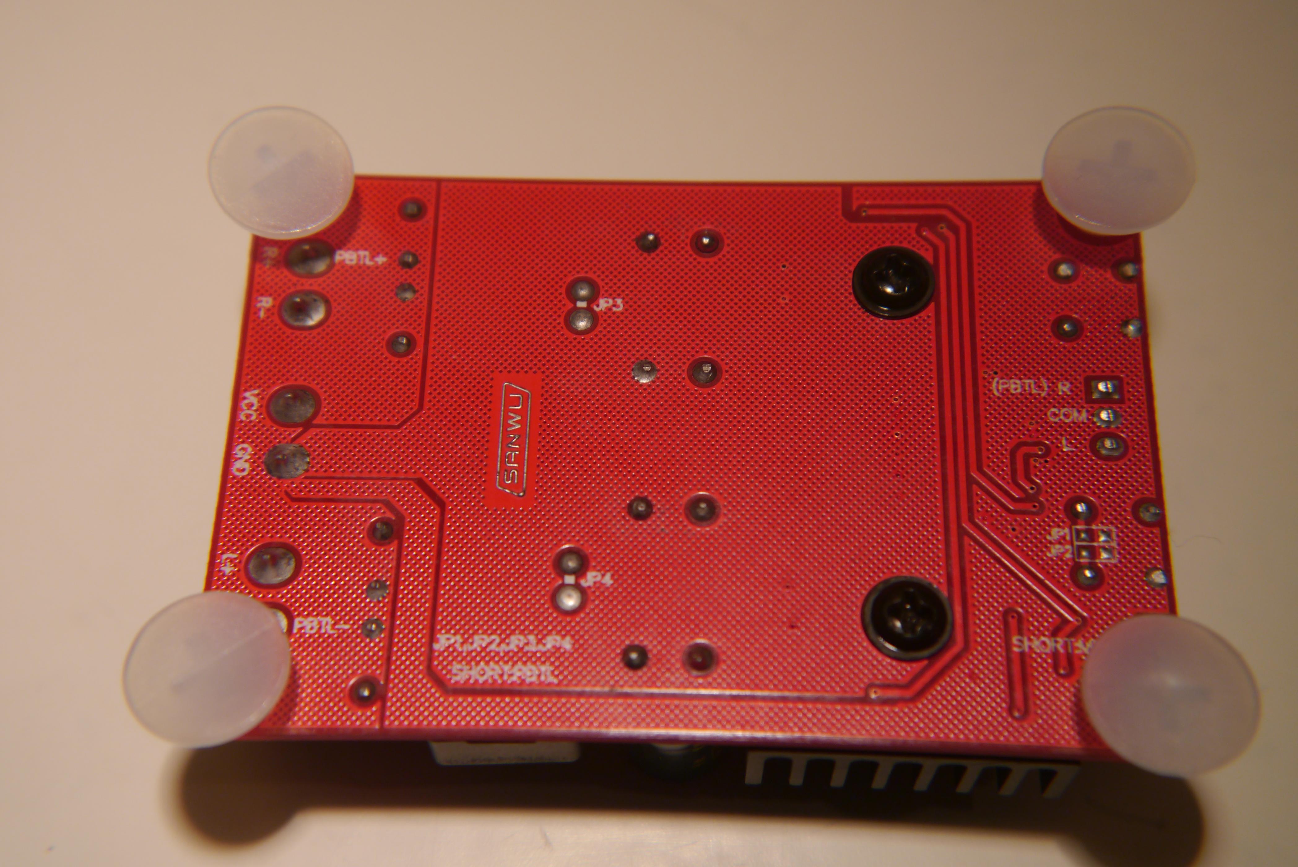

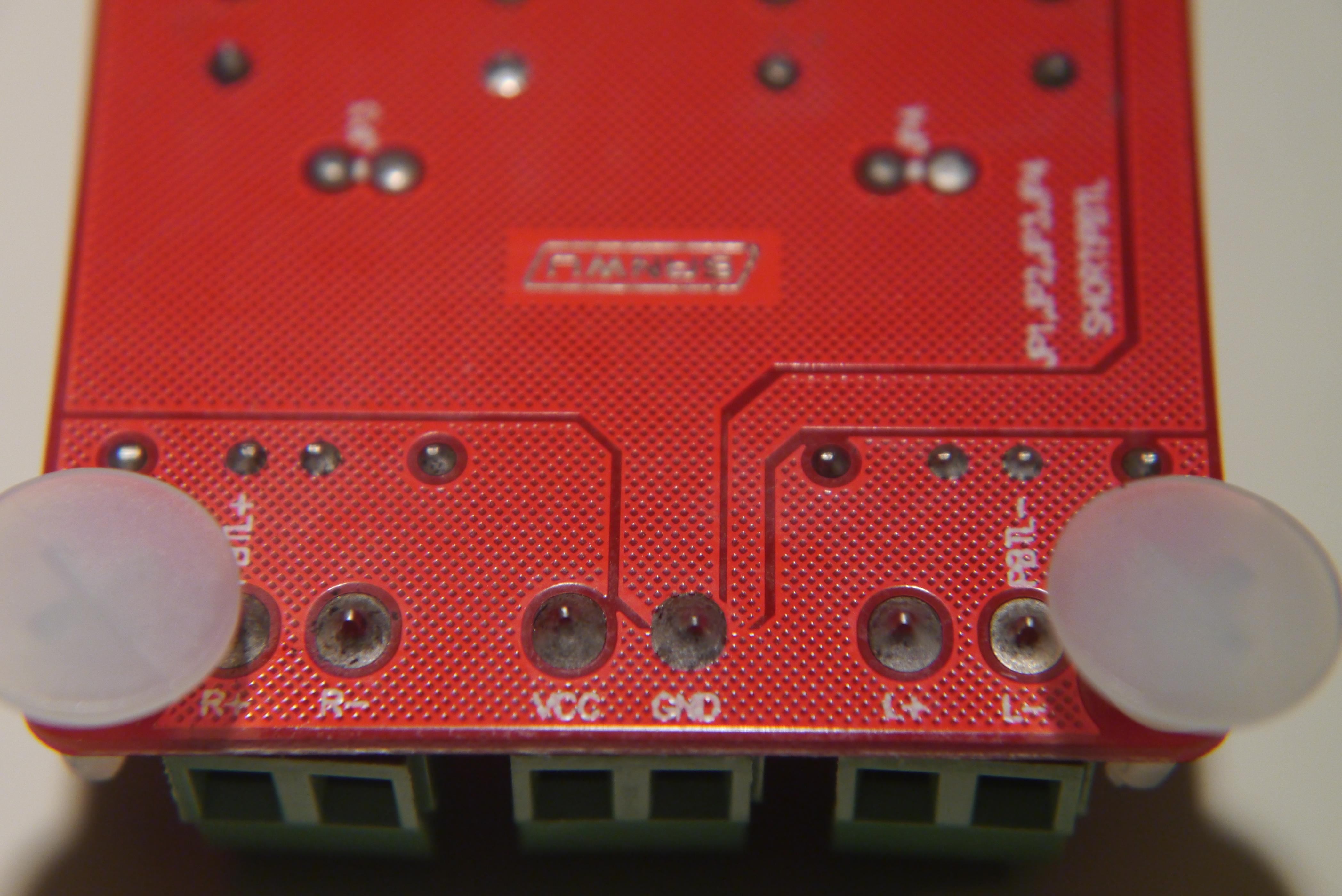

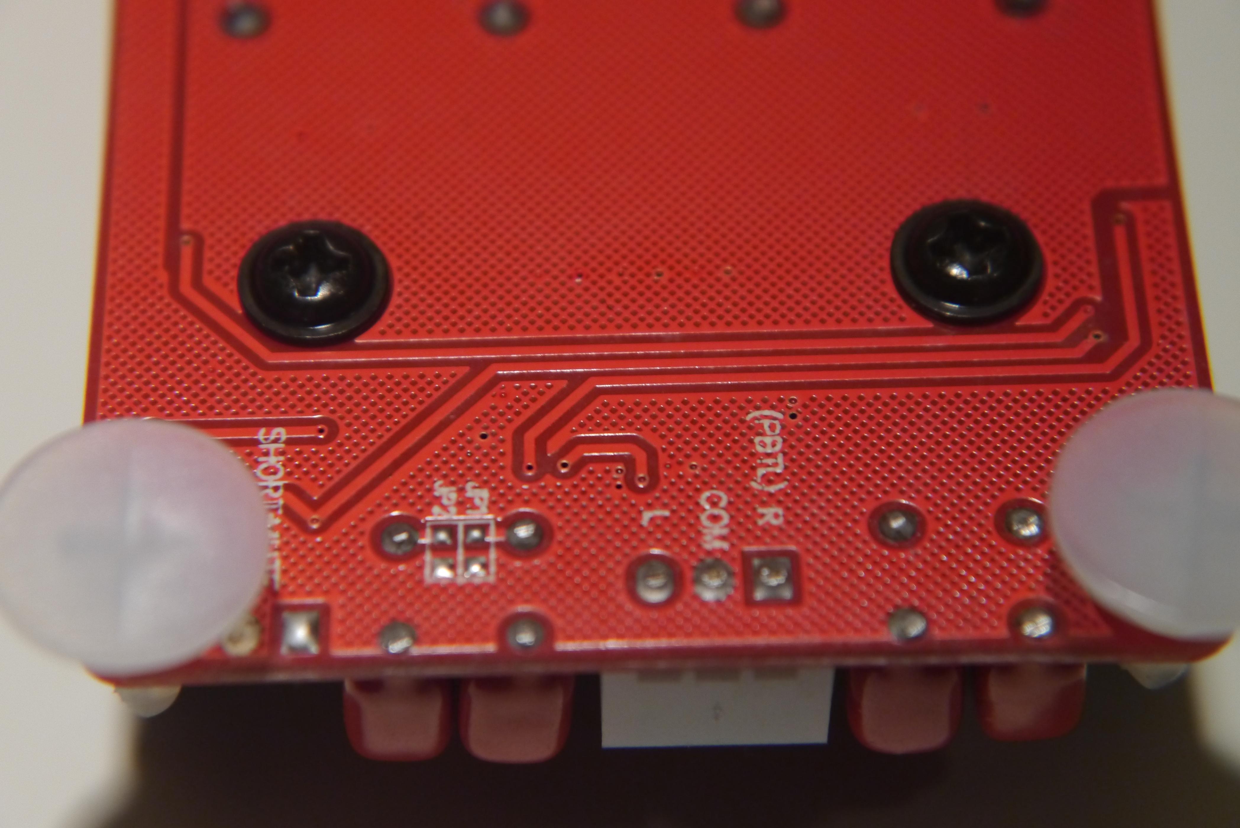

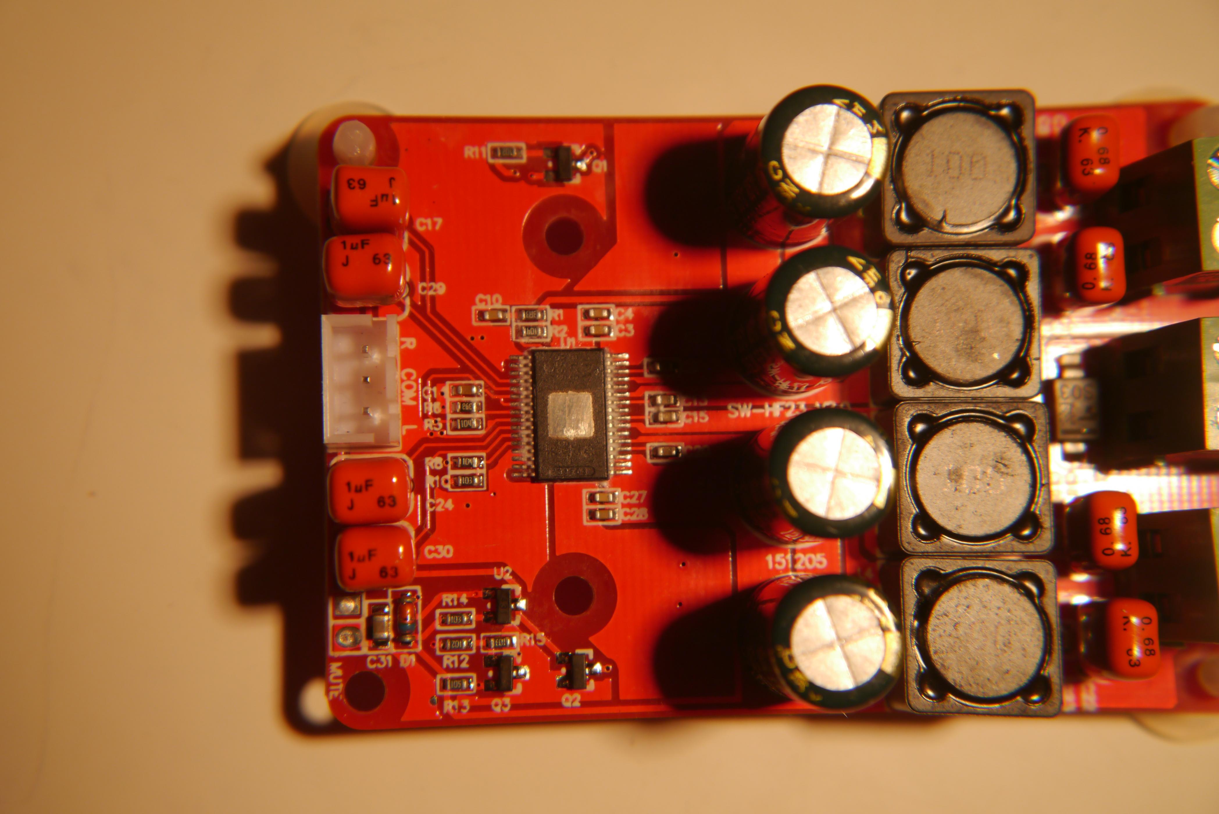

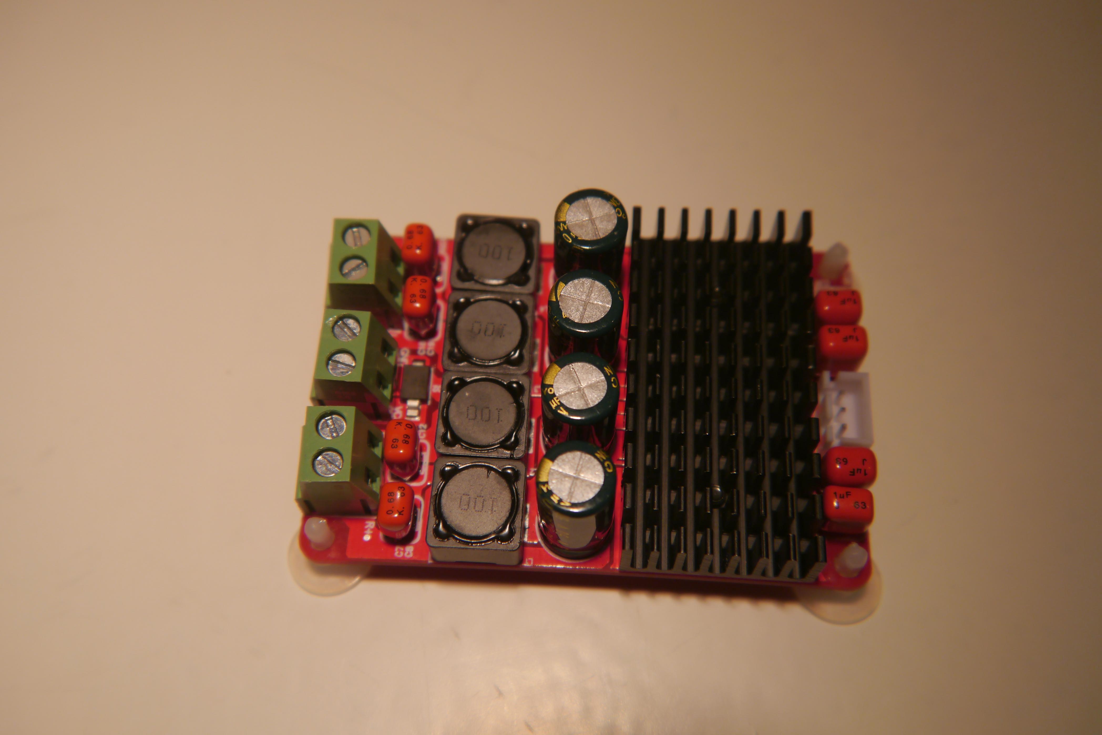

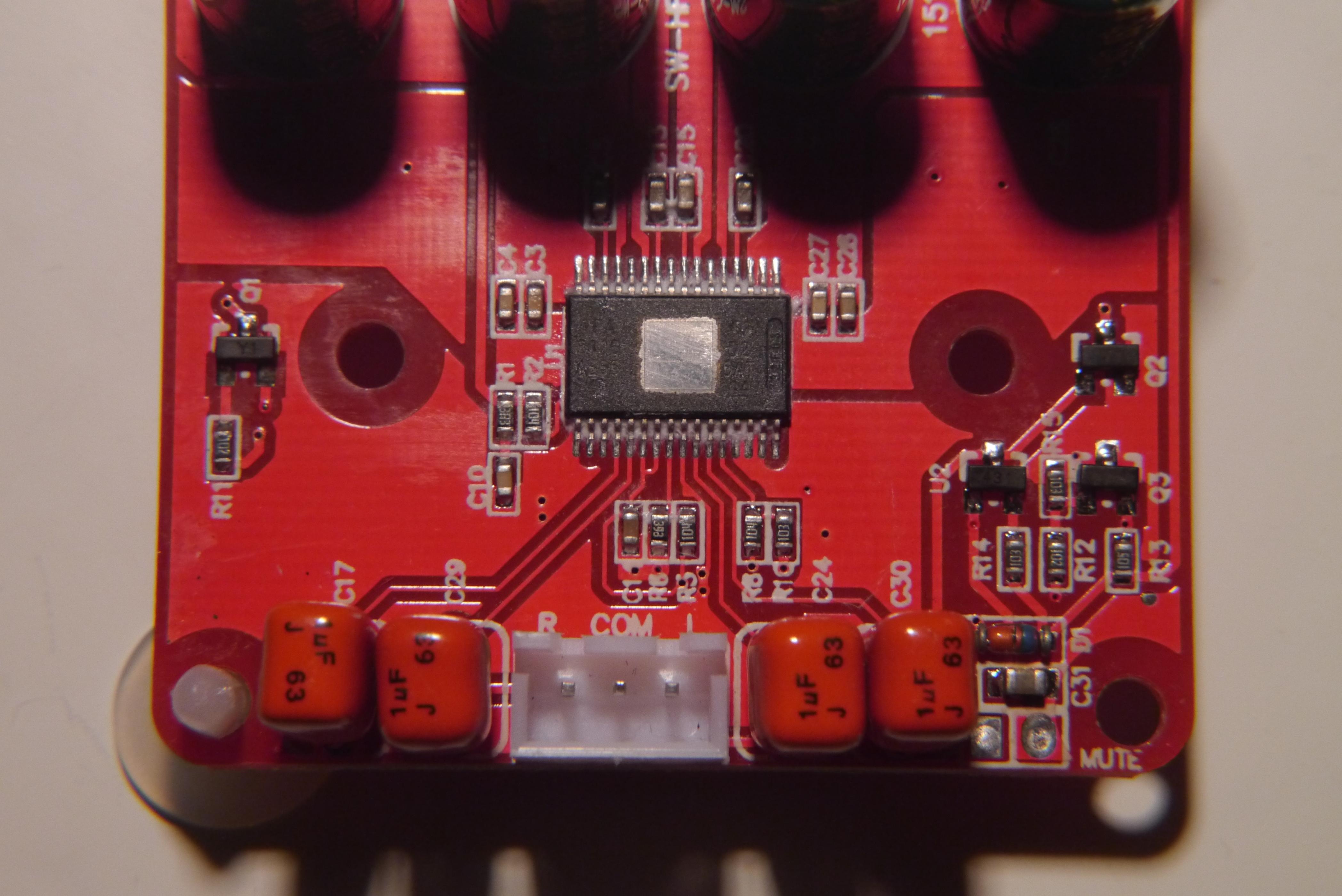

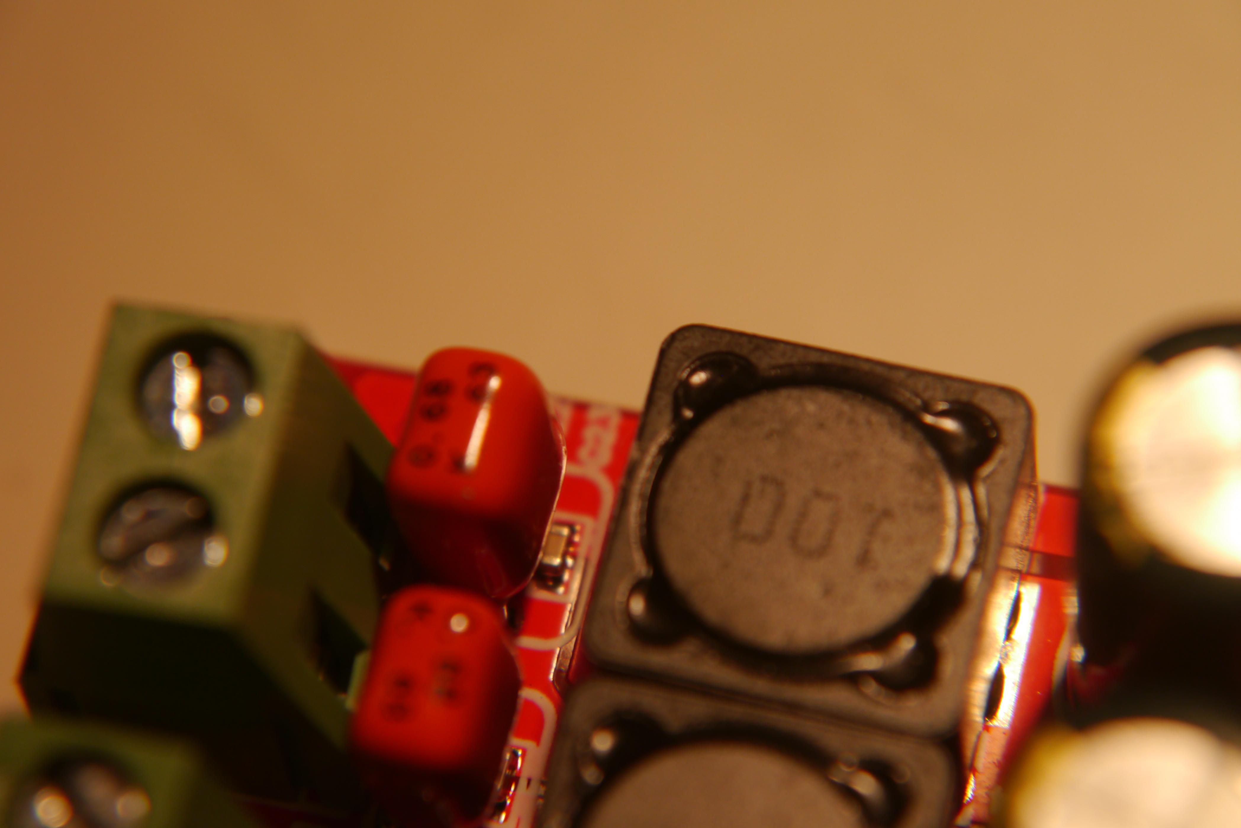

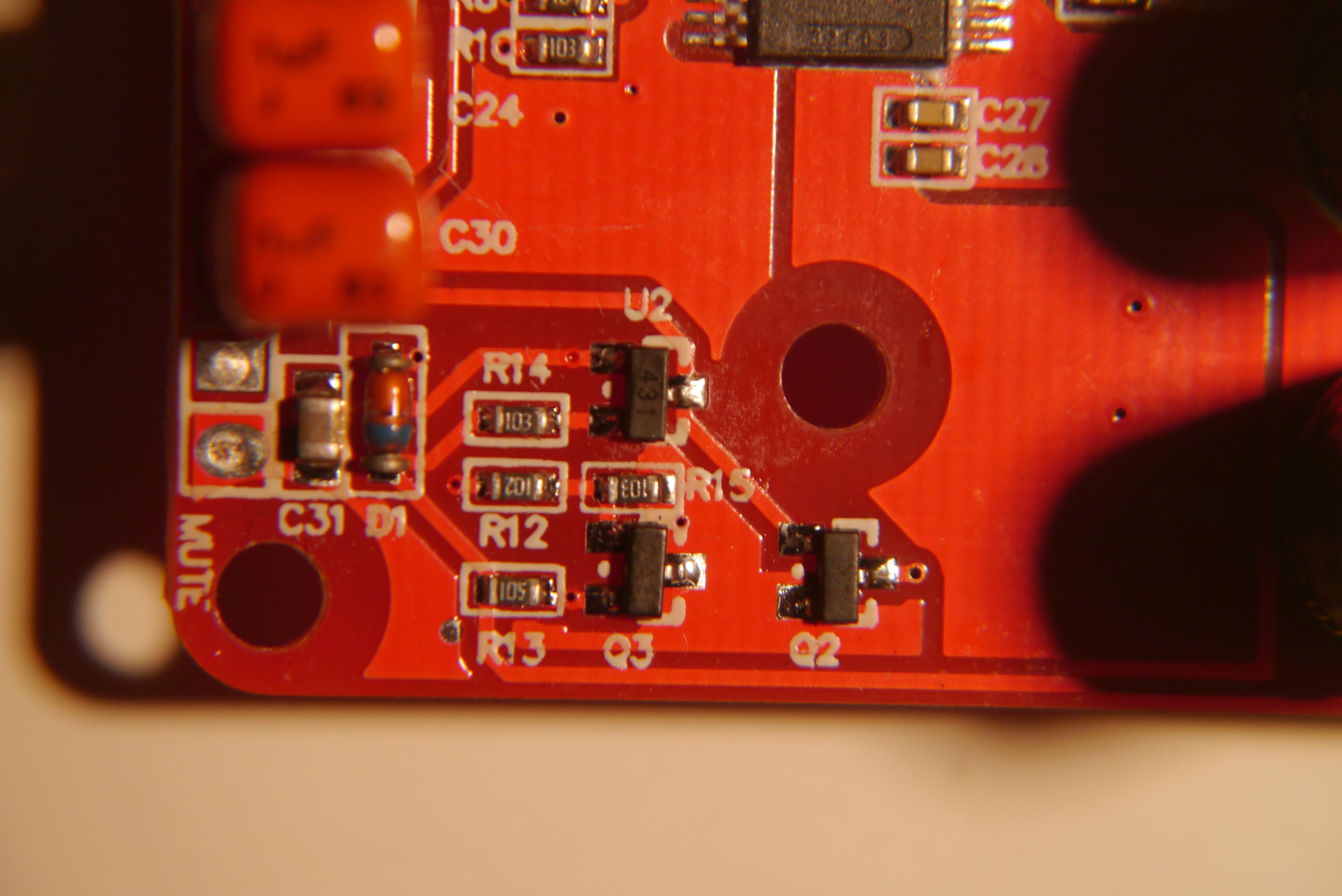

Hi all, thought I´ll post some pics on the SANWU tpa3116D2 amp I just bought.
TPA3116 50W 2 Digital Amplifier Board PBTL 100W Mono Power Amplifier 12V 24V Amp | eBay
Haven´t had the time to test it yet, but thought it would be interesting to see if this amp is as good as some of the other SANWU amps that has been recommended on this forum.
Also, anyone got a clue of what´s going on around the mute input? Perhaps a soft start/ "anti pop"? Haven´t seen a lot of info on this amp, so any input will be appreciated.
Anyway, I´ll get back after some basic test.

That's a stereo board - probably BTL not PBTL which usually is mono. Sanwu makes good stuff curious to hear of listening impressions. Short the mute pins and it will mute amp. Good for turn on off pop suppression.
Writing on the board implies a mono capability across both channels.
That's as far as I got. 🙂
....then I read tyhe eBay ad. One of the piccies there is a "mono" howto.

It´s actually both. You can cross out the marked solder pads on the bottom and it will become in bridge mode board (mono). I did do some testing today, no pop sound when turned on of off, just silence. The gain is probably set too high, because it does have a noticeable high hiss when no audio source is present?? No audible sound when an audio source is connected.
The quality of sound is pretty good as far as I can tell. It´s clean and not to sharp in the high frequencies, as some of the other class D amps I´ve got. Good response and are happy to drive a 4 ohm load. Overall pretty impressed with it.

Thanks, that´s how far I have gotten too. If you connect it as the ebay ad shows, then you´ll get mono and full power. A nice board if you need both mono or stereo. 🙂
