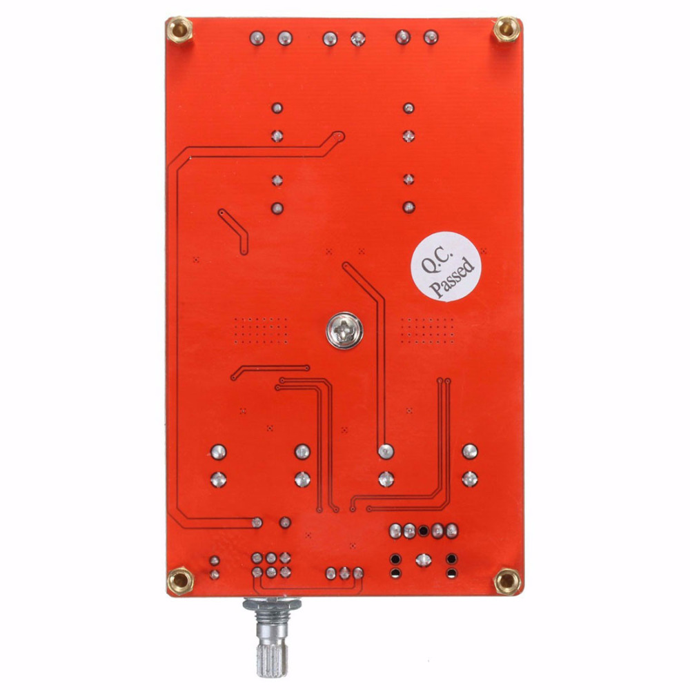

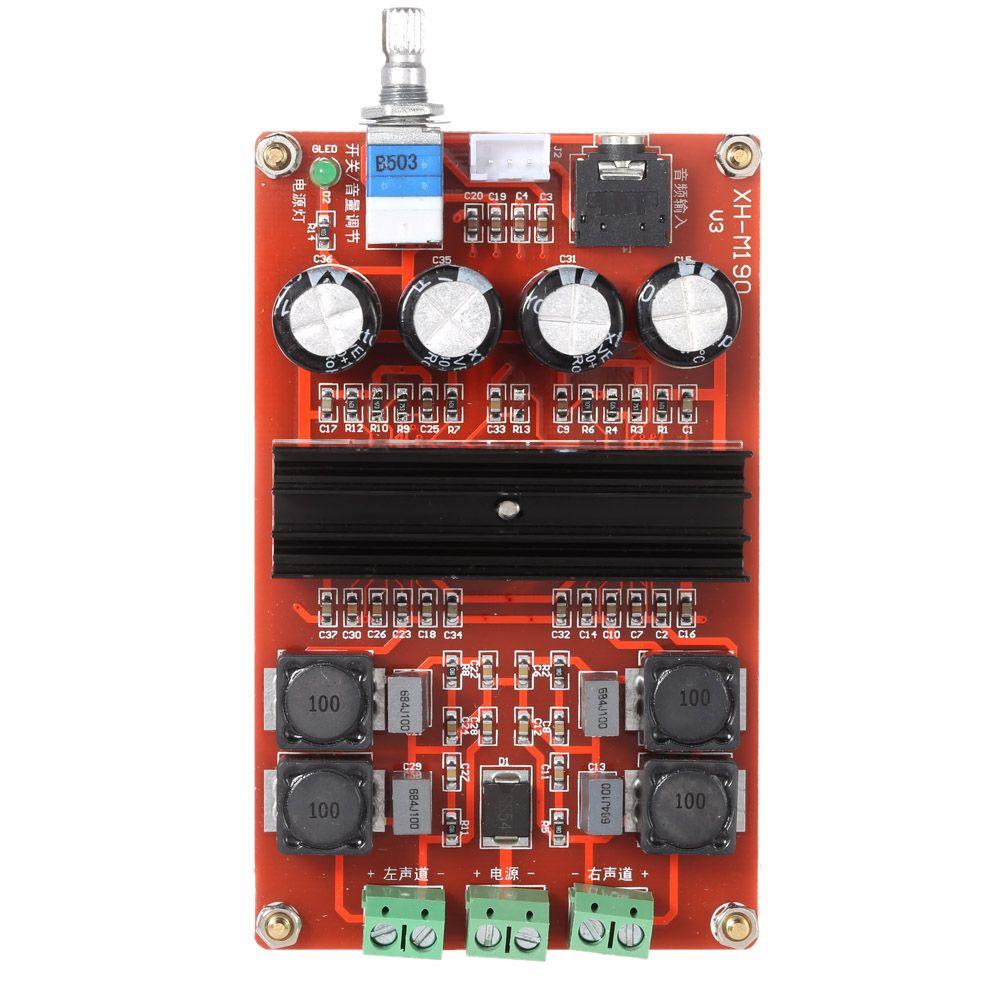

I have the Yuanjing black/blue, a TDA7498, Sure TPA3110 and a Dual chip tpa3116, and i like the Dual Chip the best
Does anyone know how to bypass the cheap (channel imbalance guaranteed) potentiometer on the dual chip pictured? i'll be using a preamp

I have the dual chip red 2x100w board...it sounds great, but I am getting lots of noise...it's very anoying. Anyone else having same problem?...idea how to fix it?
It's a bit of a challenge if you are new to it, but what I did was replace the volume pot on my dual chip board with an outboard 10K one. It quieted all background noise. Be very careful not to ruin the board when desoldering the stock volume control.
You don't have to get anything real fancy...I like the ones from Parts Express which are dirt cheap.
To me, this made an unlistenable amp into a good amp.

Yes, I use the same dual chip 3116 as shown in post #9282. Forgot to tell you that if you remove the stock volume pot you'll probably want to wire in a switch, as well, since the stock pot as you know has an on/off built in.
A little head scratching for sure. I'm sure I can help you out if you get confused. I probably wrote down how I did it.
