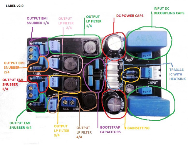

I just finished modding my two dual tpa3116 boards and put them in a case, and I am very happy with the sound.
When I received them I had a lot of noise, because of the 32 db gain, and the sound was just ok, nothing special.
First thing I did was to change the pots with ALPHA A10K, and big caps (one of them already swollen after a week of use) with Panasonic FM.
I didnt expect much but I was surprised, the mids improved a lot in clarity but that made me hear a sibilance on the highs.
Second mod was to change the gain to 20 db and put the bootstrap caps.
This made a night and day difference. The mids got even cleaner, so did the highs and no more sibilance, the music is rich and full of details and dynamics. The bass performance did not change, but that was OK anyway.
The sound is cleaner and more transparent than my old Denon PMA-320.

Very good job blackbird84! My dual chip board have same issue with noise. Sorry for the question, how did you set the gain to 20dB in this board? Thank You.
BR
egra
Thank's egra, to change the gain, you have to replace the gain resistors
For 20db: R1=5.6K, R2 Open,
For 26db: R1=20K, R2=100k,
For 32db: R1=39k, R2=100k,
For 36db" R1=47k, R2=75k,

Blackbird, those bootstraps are 330pf and 10 Ohm? Seems like 1 Ohm resistors there in your photo?
Those are 10ohm 1% resistors. 100 x 0.1 multiplier brown is 1% tolerance.

1) Are these ceramic capacitors?
2) Anything special about them? Voltage? (Wondering what to purchase.)
3) Without pulling my board, I can't quite tell...Are the cap and resistor simply soldered to one another, then soldered at two places (top and bottom of board)?
Or is there a third solder point midway on the bottom of the board? (In other words, cap soldered to the inductor, wraps around side of board, solders to cap and at that same point THEN attaches to board, then a final solder on the board?)
Can't quite make it out from the photos.
Thanks in advance for your assistance! This looks like an easy enough modification.

Ceramic caps 200v 330pf,
3) You are right. No middle solder to the board.

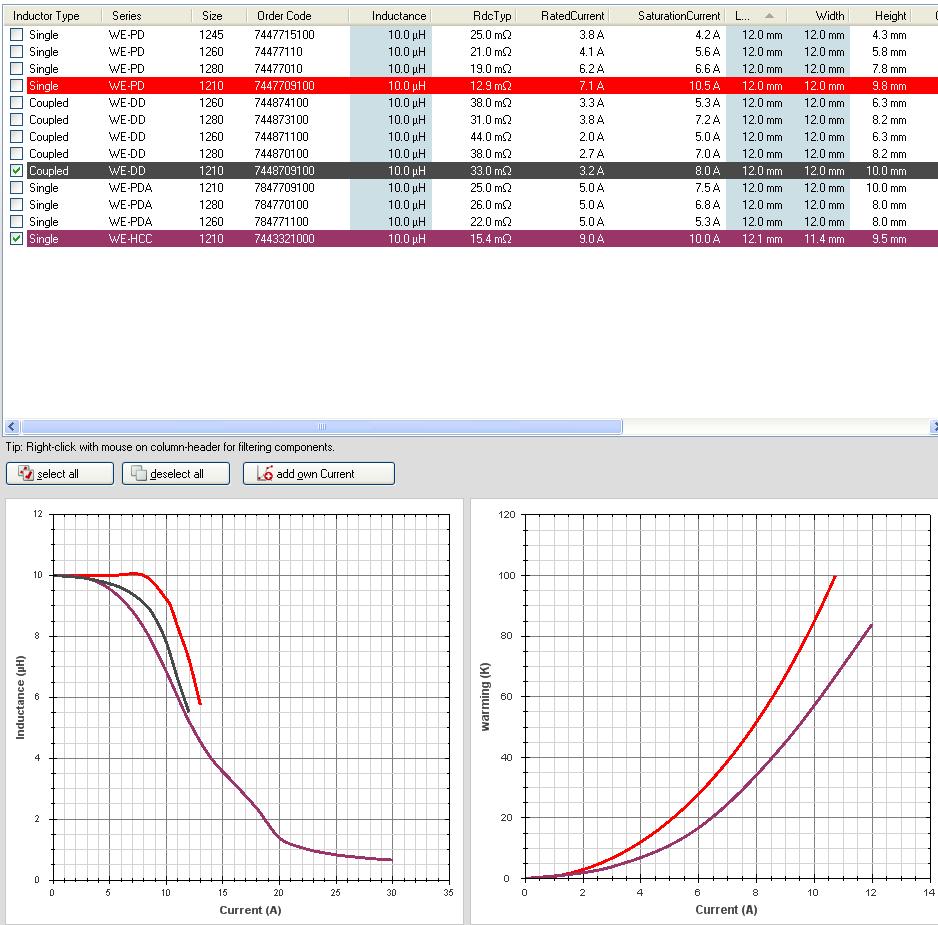

DC power caps: Look up the ESR of the ones installed and (assuming they are not fakes) find something that fits the footprint with a lower ESR if you wish to change them.
LC filter elements: Unless the inductors are running hot they could be OK and not need to be replaced. The filter caps as well. If you really want to change them find the L vs I curve and find one that is relatively flat. When current increases you don't want the inductance to change.
My opinions on the input caps are this: Any cap that is of sufficient value to maintain a low impedance relative to the load ( >9K ohms in this case) will couple the signal without issue. (i.e. not changing the sound) I am also of the opinion that a large cap of this type will pick up unwanted noise. (many others disagree) I use a 10uF surface mount X7R type. Sound OK to me.
