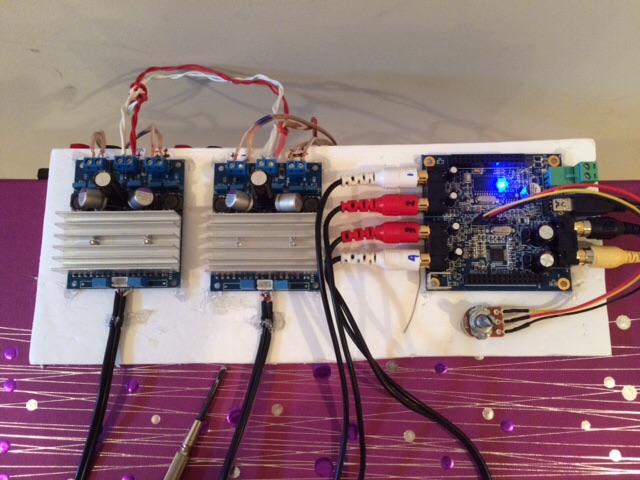

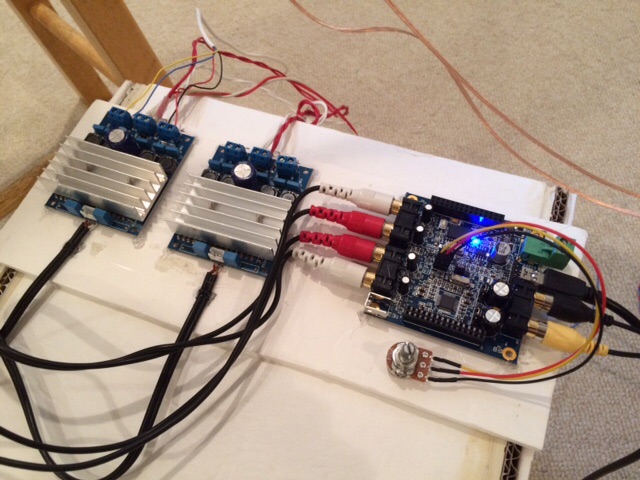

Here they are with 2x4 miniDSP.

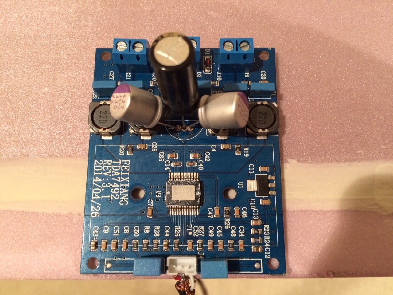

I did not measure any perceptible distortion at the speaker vs 3116 Ybdz. Still -55dB at 1kHz and above. My cheap board has rectangular brick shaped film output caps and not xr7 ceramic. It sounds like a nice performer and perhaps up and coming competition for 3116. It has very small 22uH inductors so I wonder how much current they can handle. But they don't run hot like the YJ Blue black does. The main heatsink is warm on general though compared to 3116.
TDA7492 closeup.
I pulled the heat sink off my amp and see that it's a Feixiang and follows the STM circuit schematic pretty closely. They add a few extras like very nicely closely spaced extra bypass caps for the main power rails. The input caps have been upgraded from 470pF to 1uF EPCOS film caps. The output filters seem to be using a compromise arrangement of 22uH and 220nF and 100nF film caps. Usually this would be with 33uH inductors.
There is one inductor - the far right one that runs hot relative to others and other amp board. The external ferrite shield cage looks chipped and I wonder if this is cause. It is uncomfortably hot to touch even when idle. May have to change it. It still sounds great though.
