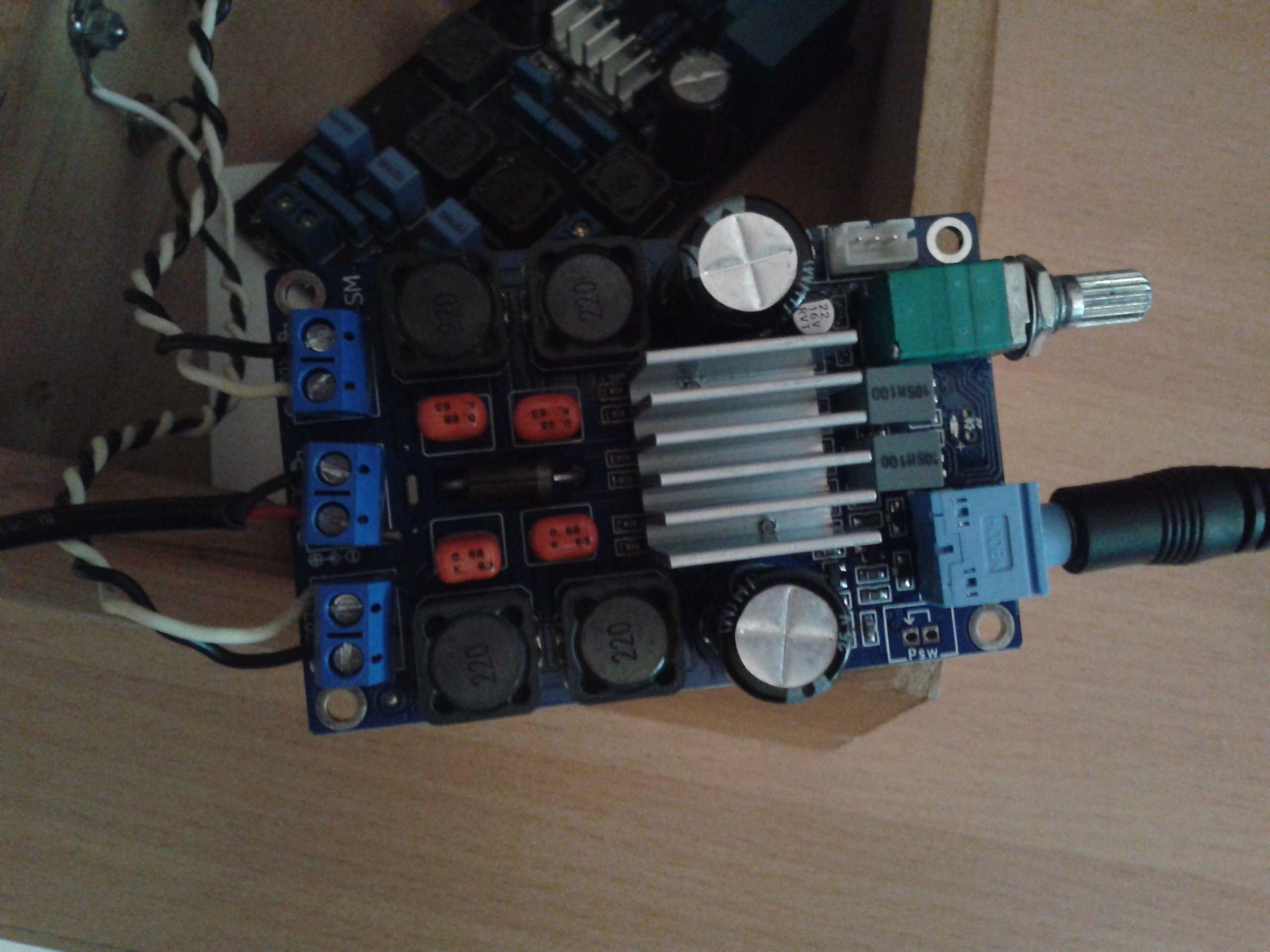

But could I be certain that the hiss would disappear completely with a 5k pot? And what would happen to the sound experience if I went for a 5k solution pot? It's a lot of work for me to dismantle the active speakers so I don't wanna go for a 10k pot only to have to do it once again for a 5k.. The speakers have decent sensitivity and are used on my desk next to the computer screen, so ideally there should be no noise at all. This is no high end setup by any means so would a 5k work?
As your listening position is quite close to the speakers, I recommend reducing internal gain of TPA3116 to its minimum as the best option to reduce hiss.
this makes some sense to me, with no educated reason why it would, other than the harder it works the more it might lose fidelity... Though loudness is still wattage, regardless of changes to gain right?
anyway, back to the questions I was trying to get a hold on a few posts back, reducing gain increases input impedance. Wouldn't that increase the hiss, if it really is the low current input, by doing that?
No, the rise of internal input impedance does not contribute to additional hiss.
It is a minor mod - just check it out!
Just for that reason I set my all TPA-amps to lowest gain available.
Changed my gain down to 26dB and it definitely helped a lot. Less hiss, still the same thing with the volume knob but less of it and when the volume is up, it's not audible.

I've also got a small bit of hiss on the YJ blue/black, so annoying. With this Pin17 RC mod is there a favoured Ground point?
Swapping the smd 1nf for a Panasonic (non smd) ceramic reduced the hiss to about half.

If you mean which 1nf cap I am referring to, its the 1nf smd cap under the heatsink which is part of the DC power cap circuit going into pins 17/18/19. Cap C23 on the tpa3116 data sheet schematic.
I know everyone seems to think modern smd, minute technology is a god send, but personally I don't.
I replaced it with a larger leaded Panasonic 1nf ceramic with shortest legs I could manage to safely solder, the hiss halved, and the music became more spacial. I did replace at same time as changing the DC power caps to 470uf 35V, so can't be sure of the caps improvement on its own.
