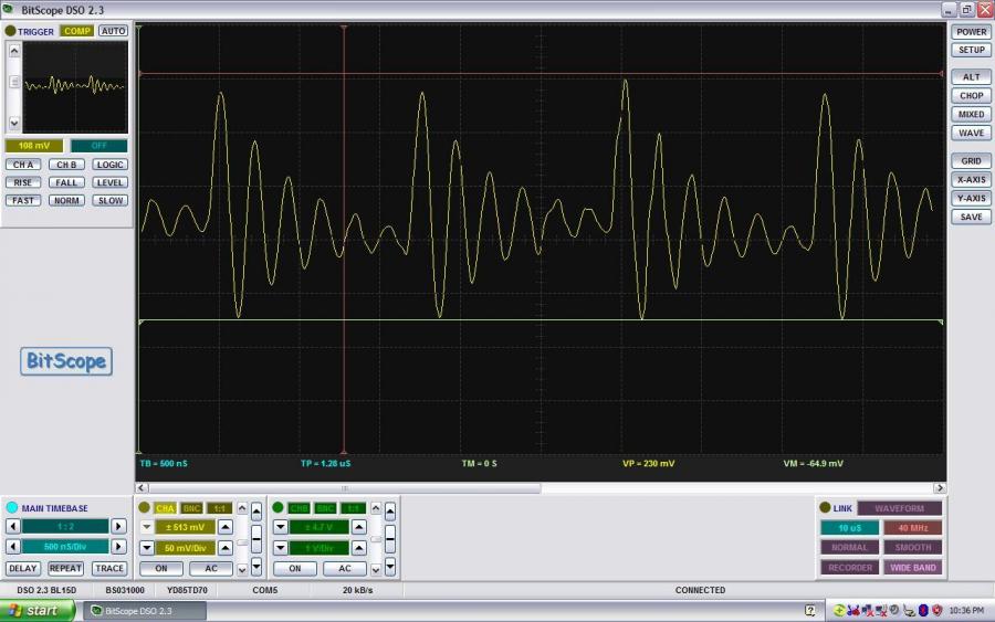

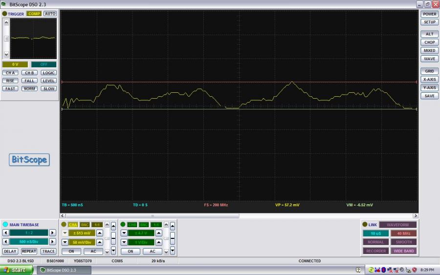

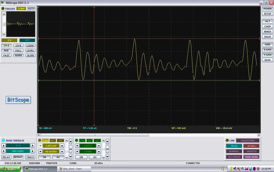

Hi, I have some observations on the old Blue Black Board. I was poking around before starting the recommended set of mods and I noticed that stock board has severe ringing on the supply lines ( around 300mV ). The ringing happens in sync with switching on the Out pins. I was using a transformer based supply to ensure that the switching noise did not come from the supply itself.
I expected that replacing the stock PS Jamecon caps with Oscons would fix the problem but it did not. The ringing reduced but it did not go away. That's the second waveform. It was only after I removed the 100nF ceramic SMD bypass caps that the ringing stopped (3rd Pic) I ended up replacing all the ceramic bypass caps with 1uF 25V 0805 SMDs from TDK and that gave me the least noise on the supply lines ( around 63mV in the 4th pic).
The funny thing is that I never realised that there was a problem when I listened to music on the stock board. But once I did the changes it sounded smoother . I'm not sure if this issue is there on other boards but it might be worth checking.

Nice work! Thanks for pointing this out. I wonder if this is the cause of why the YJ Blue Black board runs warm compared to other boards I have used. The inductors are warmer as well as the main chip heatsink. The Ybdz Wiener board for example is always essentially cold to the touch. I wonder if this is the reason why replacing the bootstrap caps with high quality ceramic ones has been shown to improve the sound, along with the bootstrap snubber mod - all of these seem to be aimed at reducing the ringing from the switching transients. Never thought to look at the power supply input as means to probe the ringing.
Actually I did the measurements across the terminals of one of the PS electrolytic caps. The waveform at the supply input to the board was pretty similar to the voltage across the electrolytics but not always the same ( some kind of parasitic effect I guess ).
I also tried checking the voltage waveform across the bootstrap caps with the oscilloscope. An ideal cap should show almost 0 volts across it as the output switches. However my scope kept freezing and I was not able to measure this. Hopefully someone with better equipment can take a look at that.
Cheers
Sant

Sant_ka's post has prompted me to dig up my old scope.
Measured across the decoupling capacitor (YJ blue black board) - it is ringing.
As soon as i clear some time, i will try bypassing it with a smaller cap.

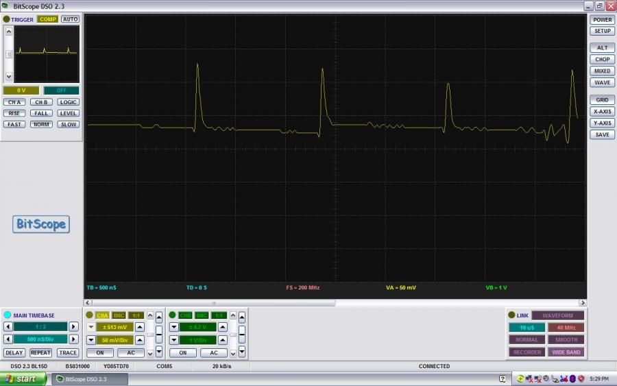

After abit more testing... 3.3uf across the decoupling cap cleans it up. I coudnt hold the camera and the wires at the same time.

I don't mean to discourage you from trying but I tried a number of bypassing caps , ceramic, film etc etc but nothing really worked until I ripped out the 100nFs. A 2.2uF orange drop cap helped and so did a 0.1uF MMK ( from Rifa ?? )
Thanks for the heads up Sant.
I tried a few capacitors which i bought as spare input caps: Wima MKP4 2.2uf and a Vishay roederstein MKT1822 3.3uf with good results (in bypass, the 3.3uf removed all traces of ringing.).
The 1.0uf Epcos (stock YJ input cap) and a 0.33uf green cap didnt quite do the trick. I'll try some tantalums tomorrow.

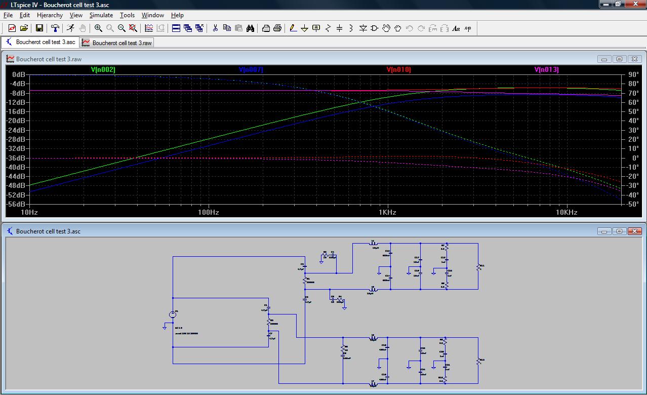

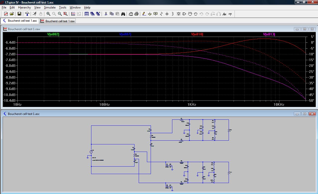

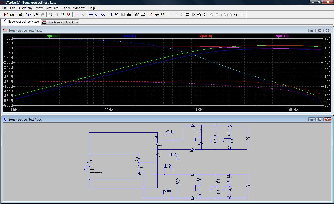

Right. So I got 4 spice graphs sorted below.
I used the SE signal input without a crossover, going through balanced inputs. the 30kOhms represents the IC on both inputs.
The LC values are those XRK has said are his on his 4Ohm 3116 board. i.e 10uH & 680nF, I have inserted a 10 Ohm resistance to the 10uH inductor.
The output resistor represents the 4 Ohm speaker driver.
I have left the rest of the output filter vales as the 3116 datasheet.
This mimicks my intitial physical test of the 3116 board using a phone outputing to 3116 board without pllxo, although I used the stock fitted LC and outputs which obviously differ from XRK's and the datasheet. This shouldnt reflect on the graphs though, and may mean that I heard a greater improvement than XRK values show, or vice versa.
I also directly powered an 8inch full range driver from amp outputs without additional XO. mine was 6 Ohm.
Basically I have used XRK's driver Ohm, and also his LC values along with datasheet ouput values.
The reason that I inserted a 10 Ohm resistance to the LC inductor is that the Boucherot cell in this use is to control the inductor resistance, not the speaker. I chose 10 Ohms for inductor.
the equation for the Boucherot cell is
R= inductor Ohms R=10.
C= inductor H/inductor Ohms^2. 10uH/(10x10)=100nF.
In the graphs below I hope at the very least the titles of each are visable.
I have done them as:
Boucherot cell test
(this has top channel without any additional circuit, as with 3116 datasheet. The bottom channel has the addition of the Bootstrap mod, as in the 3116 EVM datasheet, and as many on here have done)
Boucherot cell test 2
(this has top channel without any additional circuit, as test 1. The bottom channel has the addition of the Boucherot cell mod I am proposing across the 2 inputs to the L of the LC filter. as with the tda7492 datasheet)
Boucherot cell test 3
(this has top channel with the Bootstrap mod as per 3116 EVM datasheet. The bottom channel has only the Boucherot cell mod as per the 7492 datasheet, with optimised values based on single 10uH/680nf LC)
Boucherot cell test 4
(this has top channel with Bootstrap mod as per 3116 EVM. the bottom channel is fitted with BOTH the Bootstrap mod AND the Boucherot cell proposed, based on the 10uH/680nf LC)
The lines on the graph are basically taken either side of the "driver" resistors in each output. And I have kept them the same on each example, so.....
V(n002) is GREEN top channel above resistor.
V(n007) is BLUE top channel below resistor.
V(n010) is RED bottom channel above resistor.
V(n013) is PINK bottom channel below resistor.
Obviously to users of spice, the "dashed" lines are the corresponding phase lines.
Am I really crazy that this is a different mod from Bootstrap snubber which improves driver response and the greater sound that delivers????
Boucherot cell test
