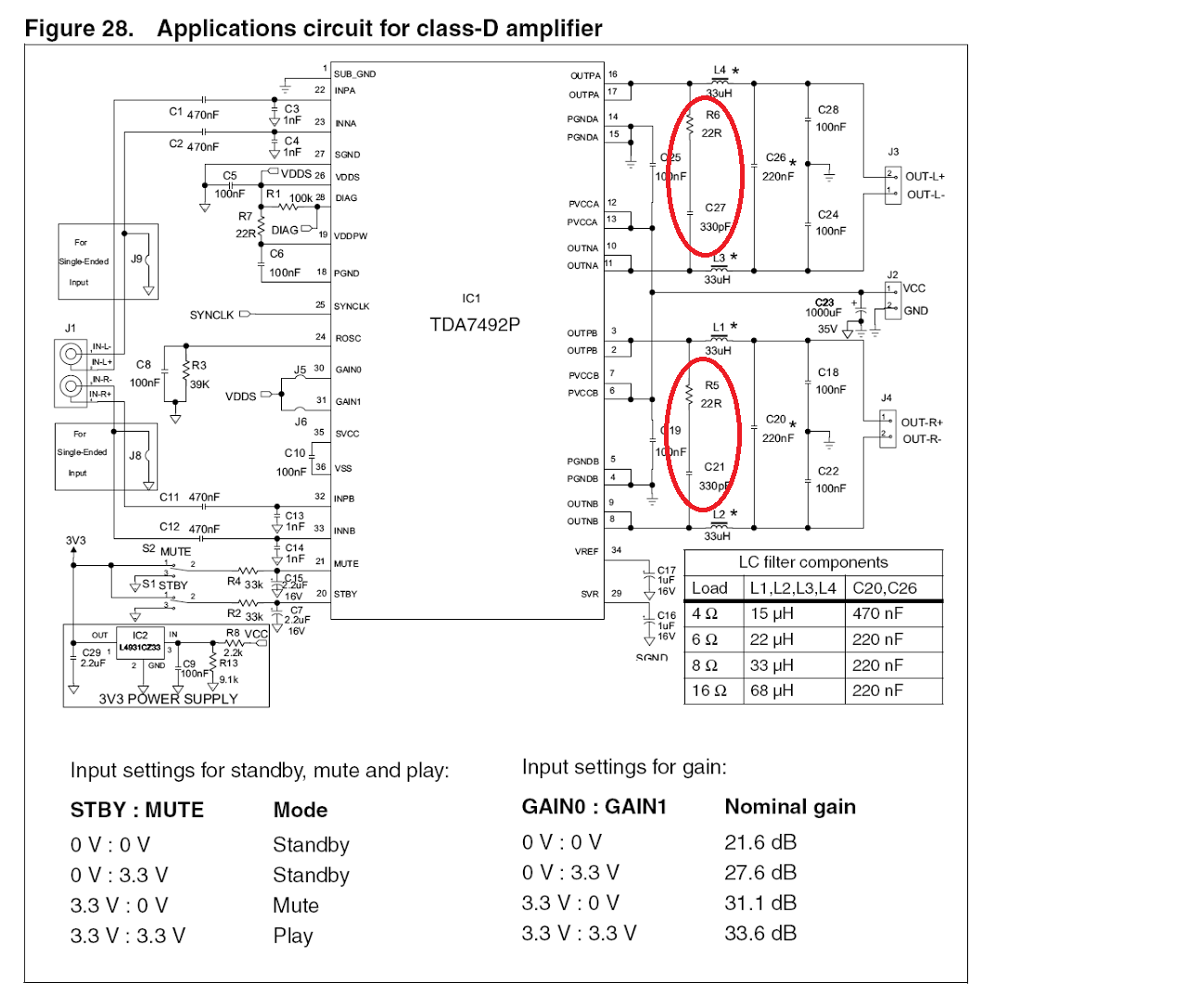

also like the layout of using the zobel/impedance levelling CR before the LC. had considered something similar on 3116 YJ board as I am using a pllxo before amps, running outputs directly to drivers. something for me to experiment with.
I did not realize that 330pF and 22R was a Zobel to level the impedance between the two amp legs. How does that work? Anyhow, I hope me adding a 330pF and 10R to ground on each leg before the L doesn't mess things up. It seems to work as it sounds good and the harshness that was present before is gone.

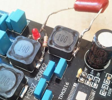

Been messing around with the 3116 board tonight by adding the pre-LC zobel as with the 7492. Got a good hour of comparing, albeit low volume because kids in bed.
Here's what I had set up....
3116 board running off 20V 5A laptop brick, signal fed from a headphone socket of Samsung galaxy 3. The amp end the headphone wires feeds through 2+ and 2- wires each having a 470nf nichicon passing to the pins of the input caps underneath, basically bypassing the stock input caps. The board is still a pretty stock YJ black/blue. Only mods so far are heatsink removed, DC decoupling caps are now Lelon 470uF RZW, and the 1nF smd/t replaced with a leaded Philips version. Both channels wired to 8inch full range woofers direct without xo. These are paper cone woofers from a 1978 Advance VII speaker, which I recently refoamed. Just to note the speaker wires were about 8ft cheapo diy store stuff.
What I did was to add the zobel to 1 channel only, enabling a side by side comparison without swapping and changing.

So, below here is a PIC of my pre-lc zobel / Boucherot cell fitted to the 3116 as already mentioned.
Please, please read about this circuit before trying it. The bottom of the 3 links I posted clearly states that the values of resistor/cap HAVE TO BE CALCULATED according to the lc after it.
I am no expert in either circuits, or with the 3116 IC. If I destroy my board that's my own stupid novice fault. If you follow me blindly I am not to blame. Don't be a lemming.
Please, please read about this circuit before trying it. I am no expert in either circuits, or with the 3116 IC. If I destroy my board that's my own stupid novice fault. If you follow me blindly I am not to blame. Don't be a lemming.
Don't worry about the values I used. refer to the following info...

As I was only testing for 1 hour max at very low volume levels I just found a resitor and cap which fitted into what author says most manufacturers do as they are lazy or incompetent. seemed to work ok with no ill effects, but needs optimizing according to the equations within the above link.

The Zobel Mod for the TPA3116 as copy of TDA7492
The mod we are talking about is basically strapping a resistor and cap in series between the two output pins of the amp, BEFORE the inductor stage. This type of filter is also called a Zobel or a Beaucharot cell, and is commonly used on speaker drivers to flatten the rising impedance of a reactive load that the driver presents to the amp. A flatter impedance means less resistance and hence higher current can be applied for same voltage across the speaker terminals as provided by the amp. Higher current will mean more SPL or more dynamic response.
Look at the 7492 circuit and you will notice a 330pF and 22R connected in series and straddling the two output pins from the amp for each channel. I wondered what this was too, and I guess Stanleyburbrick also wondered so he put one on the 3116, which does not have one on ANY circuit schematic I have seen.

Take a look at the TDA7492 diagram where I circled in red, the 330pF and 33R resistors. This is the circuit that I will apply to the same location on the TPA3116D2 chip.

My TPA3116D2 uses a 10uH coild and 680nF caps on the LC stage for the 4ohm amp and 22uH and 680nF caps for the 8ohm amp. I think they are close enough to my current 7492 which uses 22uH and 220nF cap. Although, I am not sure how to model this in Spice - do I pick opposing phase voltage drive sources for the amp pins? Stanley, if you want to take a crack at suggesting what values to use that would be helpful. The TPA3116 is a bulletproof amp as far as shorting the output. That is the worst thing and it is protected and shuts down - so I don't think off-ideal values for the Zobel are going to damage it. We do need to figure out what the optimal value is, if there is an optimal value.
The idea is that it needs to damp AC oscillations between the total dual LC *system" impedance as presented to the speaker driver as both sides are used. 22R or 10R, all the same...
