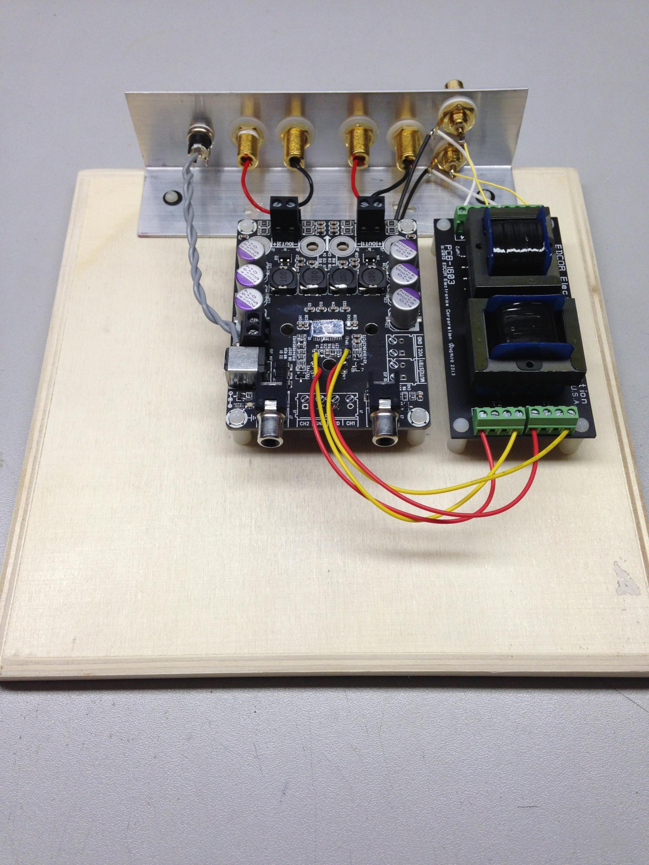

matt_garman sent me his Edcor TTPC15k/15k matching transformer module to try out.
https://www.edcorusa.com/ttpc15k-15k
Currently, my CineMag-modified YJ TPA3116 blue/black amp is on loan to a friend who bought a modified YJ TPA3116 blue/black amp from me. His amp is identical to my CineMag-modified unit with the exception that his amp has the stock blue film box-type caps. No surprise that the transformer-modified unit sound far superior to the other unit.

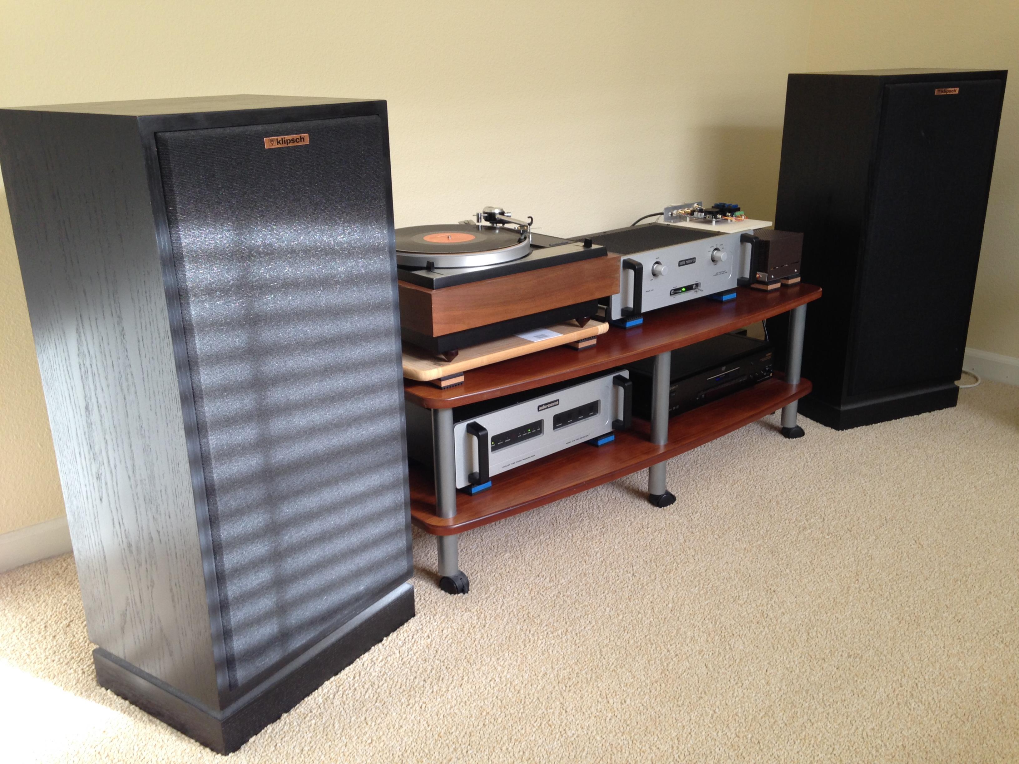

Back to Matt's Edcor transformers, I decided to install the TTPC15k/15k module in my OSCON-modified Sure Electronics TPA3116 amp. I had to delicately solder in the transformer leads to the tiny SMD pads on the Sure amp board. The photo of the amp without the heat sink installed was taken before I realized the pin-out for this module is slightly different from the individual PC15k/15k transformers. The photo next to it shows the corrected connections.
After a couple hours, the sound really settled in, and I was very impressed with the improvements in sound quality that these modestly-priced transformers made to the Sure amp. Just as I heard with the CineMags, the soundstage became larger and the imaging was a lot more focused. The noise floor really dropped and there was absolutely no hum as I've heard with the Sure amp before. The amp sounds smoother with a richer midrange and detailed treble. Bass is deep. I'd like it a bit tighter though. I've been spinning vinyl in my system listening to this amp, and I've been enjoying it since the weekend.
One huge improvement is the absence of the turn-on/turn-off pop. On turn-off, there is a faint click, but nothing as scary as what I heard before.
Once I get my CineMag-modified YJ amp back, I'll try these Edcors with that amp for a direct comparison to the CineMags. I would say that my preference is still with the CineMag-modded YJ amp versus the Edcor-modified Sure amp, but more critical listening needs to be done.
Thank you Matt for loaning these transformers for this experimentation!

That is for me the biggest benefit. I only tried those Edcors with the very first tpa3116 I ever worked on (a YJBlue). It's a messy affair, but it never suffered from the turn on/off popping. At the time, I didn't have the courage to hack on SMT components to try with a board that did exhibit bad turn on/off thumping (Ybdz/Weiner and Sure). But thanks to the DUG board, I now have a little SMT confidence!
Definitely eager to hear what you think of this. Based on what you've said so far, I think it's pretty safe to conclude they are already a high-value product. Fixing the turn on/off thump without having to resort to a manual toggle switch (as I've done) or some fancier relay or transistor based scheme I think is a huge win, and any sonic benefits are certainly icing on the cake.
Thank you Rich for taking the time to experiment with these transformers and report your findings!
I would think 3VDC on iron core transformer would be far worse than previous original situation, but you may like the sound better.

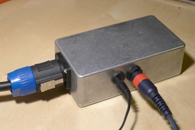

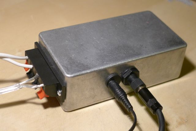

Sorry for the delay. The Danz board fits in a 125B enclosure, but only just. Lined the base with teflon and shaved two unused corners off the pcb so it fits in the base. I've made two boxes; one stereo and one PBTL with a Speakon socket. 🙂
