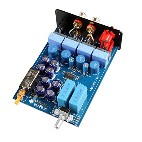

I think that volume knob problem is the TPA3116 version, not the TPA3118 model which is the 36A Pro - just a a basic pot and not rotary encoder like the 3116. Am I mistaken?
Here is image of 3118 - looks like a standard pot - and lack of an op amp for volume control:
Here is image of 3116 - obviously a rotary encoder for volume:

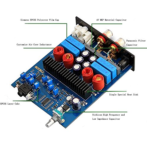

Btw, has anyone seen this amp on Amazon, what variant is this? I like ordering from Amazon if possible.
http://www.amazon.com/SMAKN%C2%AE-TPA3116-Amplifier-Board-Class/dp/B00KCEHS54/ref=sr_1_1?ie=UTF8&qid=1419956186&sr=8-1&keywords=tpa3116d2
Seems like a nice compact board with candydrop tantalums on the LC filter, and film caps on inputs, SMD ceramics on bootstraps.

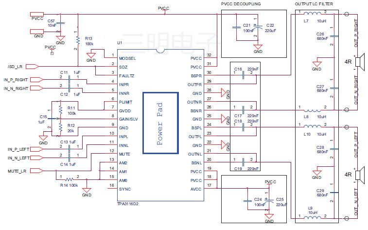

Is this board any good? The schematic posted by Perceval is the standard (non-EVM) one used by 95% of manufacturers - meaning no bootstrap snubber circuit.
