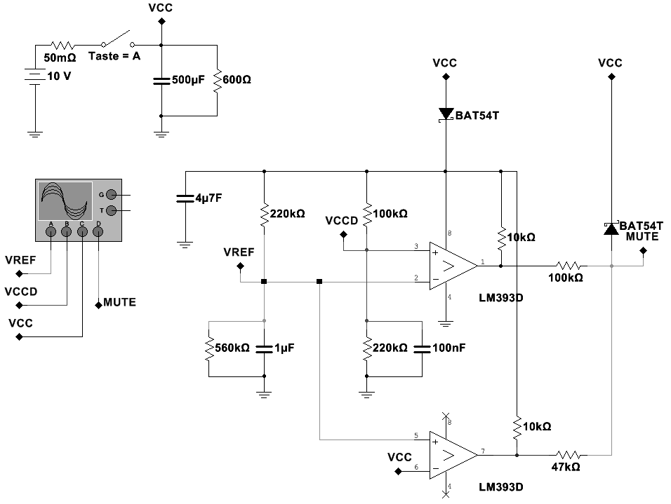

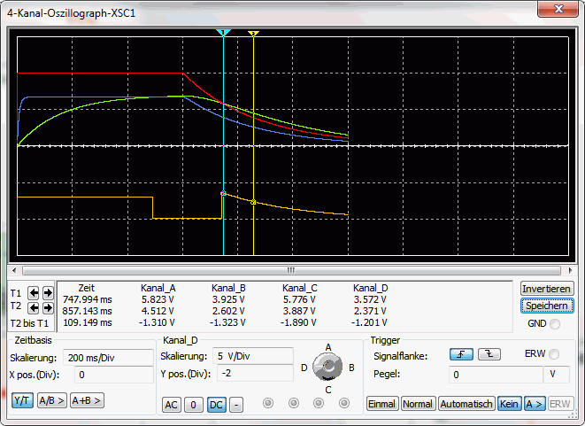

how about the following should avoid pop-on/off while delay not scaling with VCC.
Beside this,

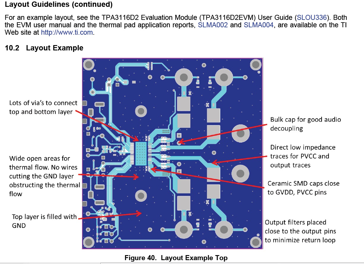

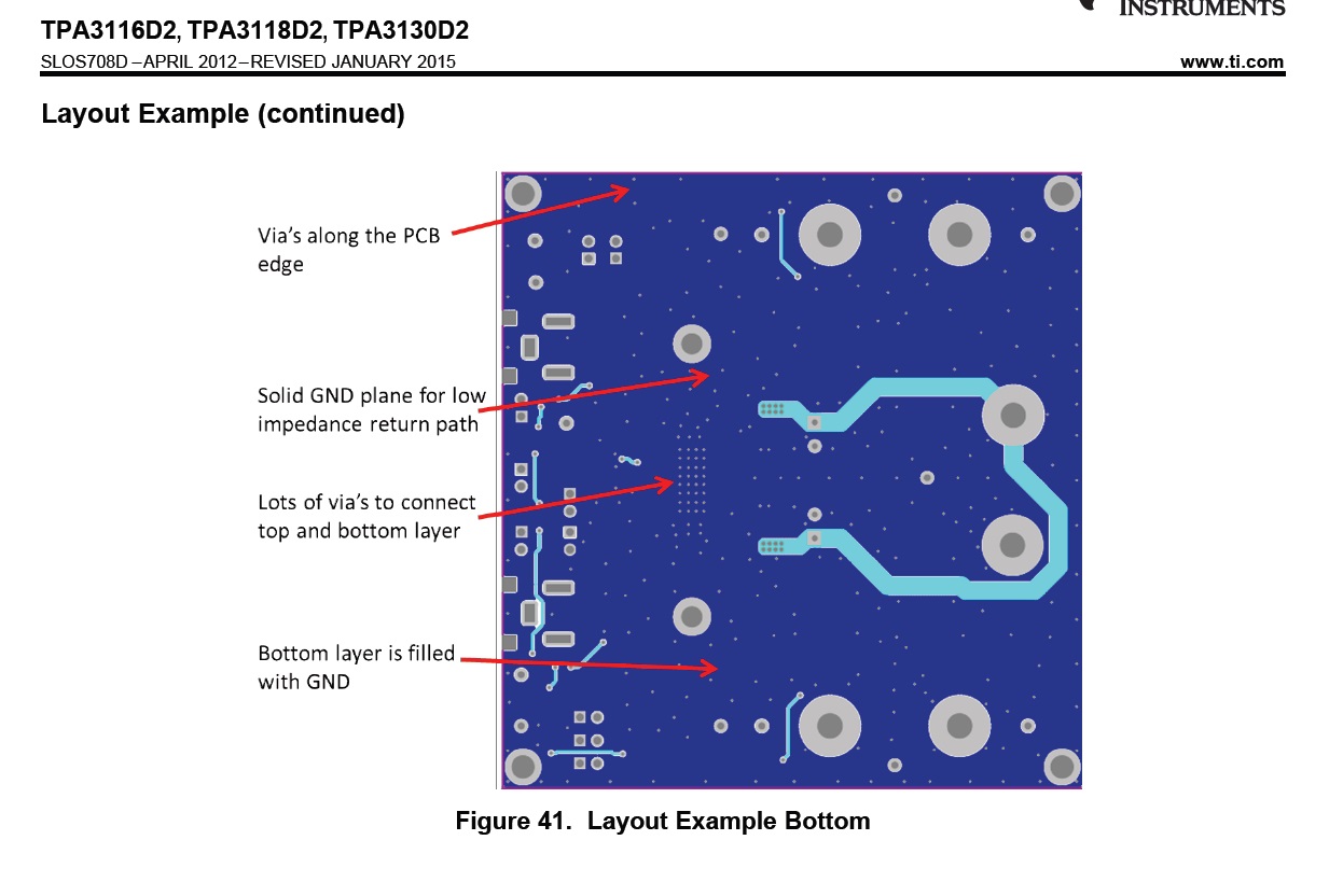

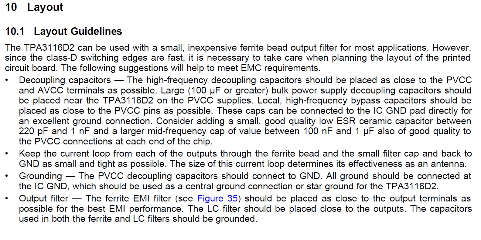

To be completely anal, TI EVM doesn't use correct values for PVCC decoupling, needed are high freq between 220pF and 1nF, the 1nF cog is perfect, BUT mid decoupling needed is between 100nF and 1uF, 100nF 0603 classII ceramic with any DC applied is <100nF, no Wiener 😀

Funny that EVM doesn't follow TI own guidelines for decoupling, some others have mentioned, can't remember where I read it, that gnd layout EVM isn't very good or easily improved upon. So bit expensive board that isn't optimal, it seems. TI themselves have mentioned that improving SQ would mean replacing classII ceramics for film/mkp, so maybe hacking up a cheap pcb for modding is better investment anyway. Maybe for 1200khz operation Sure3116 massive number of caps decoupling effort has benefits? Maybe pcb was 1200khz Tripath befor becoming 3116 ? Not that I remember seeing any such number of caps for decoupling in any Tripath document, but my memory might be bad.
1nF is perfect because YOU say so? If this would be perfect in any way, why TI suggest values between 220pF - 1nF? Decoupling is highly dependet on board-design/layout and the right value for a given layout will normally be determined empirical. Especially when normal traces are in the range of several pF.. 🙄
Seeing some superficial knowledge here.
For sure, decoupling at a standard China-Board will be different than on a tightened layout like attached. (Smaller loops, smaller return paths)
