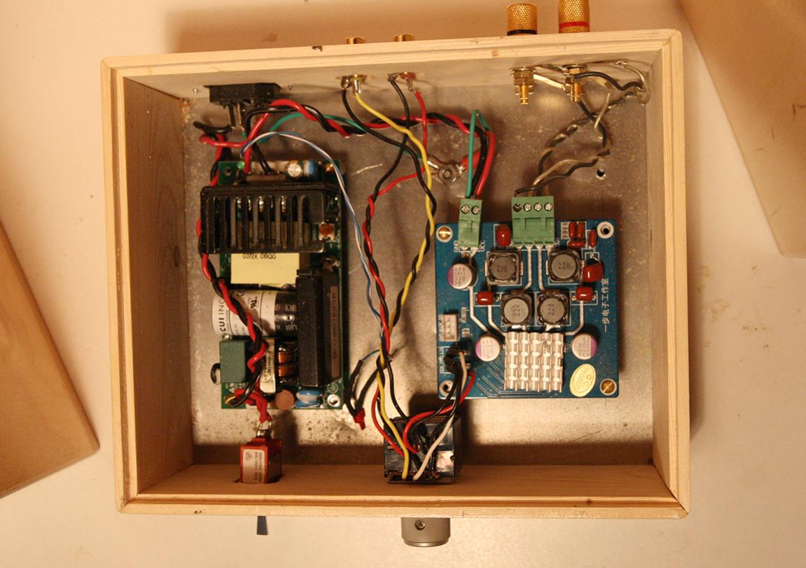

I have 2 weiner boards. To me the overall sound is very good but they lack in power compared to the YJ blue/black boards I have in various levels of modification. I changed the caps to OSCON's on both boards. One is powered by a 24v supply from DigiKi, the other with a 19v laptop brick.

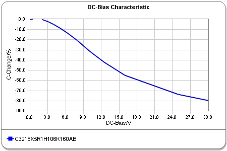

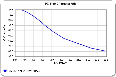

+1 with doctormord's caveat about the decrease in capacitance under bias for X5Rs. TDK 10uF is about the best choice, go higher in capacitance and they tend to lose more under bias so you end up with less in practice.
Let's see for a TDK - C3216X5R1H106K160AB - MLCC, X5R, 10UF, 50V, 1206 - not any better at all. (Almost the same)
Because MLCCs like
TDK CKG45NX7S2A106M500JH CAP, MLCC, X7S, 10UF, 100V, 1812
-25% drop at 24V)

are a bit expensive, you'd better go for 2*2u2F 50V X7R 1206.
Concur that a drop exists, but didn't think it was that bad - I remember figuring out a -30% drop for this exact cap in the past, and going by page 2 of this document, AVX's X7R dielectric seem to only drop 20% at rated voltage:gmarsh, did you considered the capacitance drop at the 10uF/35V mlcc at a dc-bias of 24V? I'd guess a minimum drop of 60% in capacitance. Beside this, the 1-10nF + 100nF close to the chip is only meant to be a shorting-path for HF.
Let's see for a : C3216X7R1V106M160AC
TDK 10uF 35V X7R 1206
-70%
http://www.avx.com/docs/Catalogs/dielectrics.pdf
But looking up other curves, wow, it can be much worse.
Oh well. Use a 50V rated part if you can, use more caps, blah.

What about "blah"? As seen from the charts, there nearly no difference between 35/50V, the main derating is caused by the size and layer stack distance within the ceramics. Why being unfriendly? Don't get it.

Edit: Having some more detailed view into the AVX documentations, they seem to perform better than the TDK ceramics at rated voltage. (and Murata as well)
Beside all this, i can't find any supplier for AVX 1206 10uF 35/50V X5R, (theres is only 1210 X7R 50V).
TDK does seem a lot easier to source than AVX, I didn't know that AVX was so much better than TDK. Samsung is next best, Murata sucks big-time.
I would think that the better AVX performance is only valid for the leaded types, not for the SMD parts as the dimension seems to not influence anything and this can't be true at all.
