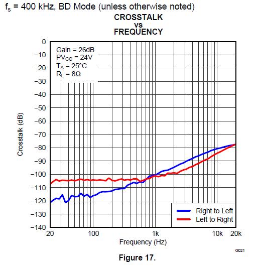

Well, here is what the data sheet says about crosstalk between R and L on the same chip.
If that is not enough separation then use separate PBTL boards for each channel with a supply for each.
The datasheet doesn't address the issue of running two chips off the same supply - it only applies to a single chip and the crosstalk between the L and R channels on that single chip. Running multiple chips off a single supply could degrade things, especially if the supply isn't capable of enough peak output. From a purist standpoint it's better to have completely independent supplies.

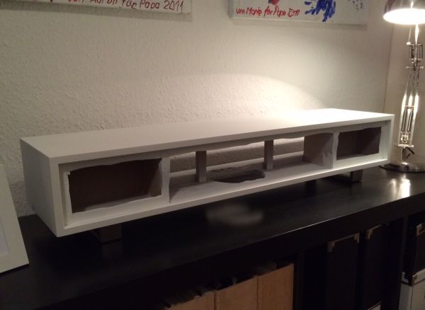

What is the design based on? bass reflex or TL?
(...) sound could probably be vastly improved if you used a baffle step correction filter to attenuate the highs to balance out the highs vs bass. Something like a 1mH and 10ohm resistor in parallel and that put in series between amp and positive driver terminal.
Thanks for your suggestion about the baffle step correction, xrk971! I will futher play around with these.

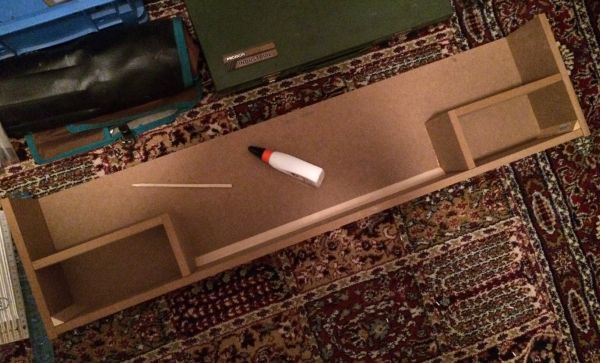

I kind of merged two seperate designs together on this one (without knowing what I was exactly doing and how it will all end up).
The baffle height is 13,4cm, the same as these diy RS100-PC-Speakers are in width. So I used the same R-L-C correction as I have in these diy's, which is 0.72mH, 22µF, 3.9Ω. The enclosure volume is reduced from about 5l (bassreflex) to 1.7l (closed).
The sub's enclosure has the same volume which it has had in its origin 'Creative' bassreflex cube of about 12l, without any R-L-C correction. Now it's just downfiring with two 3,5cm backfiring BR's instead of one single 5cm.
The whole outside measures 90cm width x 13,4cm height x 21,6cm depth, 12mm fibreboard (MDF).
It still sounds very 'direct' in the mids while lacking highs. Voices, acoustic guitars and such are quite awesome, nearly as if they'd be playing live right in front of you. Unfortunately the upper highs are too reserved, hi-hats and cymbals are sounding way too silent.
Well, the RS100 is a mid/sub driver, I guess it could be hard getting sweet highs out of them, I should have considered this before..
The RS100-4's should have plenty of HF sound in them - specs show good out 20kHz. Your sealed chambers are rather small for how high the Qts is though. 3L would have been better to get a little more reach down to 150Hz. Are you scavenging the sub from an old Creative sub? Down firing is good as the 2.1 amp has a high XO at 340Hz so you want to limit the direct output in sub. The BSC you have may be close with 0.72mH already. Just need to add some more resistance to it and maybe add 0.3mH coil.
(...)Are you scavenging the sub from an old Creative sub? (...) The BSC you have may be close with 0.72mH already. Just need to add some more resistance to it and maybe add 0.3mH coil.
😱 Sorry, I wrote 0.72mH, it's actually 0.27mH. I will definitely try your suggested values.
Yes, the sub is from an old Creative 2.1 system and the subfrequency part seems to sound ok, though it becomes more 'tidy' somehow by closing the BR's on the back with some foam..

(...) Something like a 1mH and 10ohm resistor (...)
Wow, that hint really saved my project. 1mH/10ohm made the Dayton's cheeky mids sound way more tame, after some more trial and error they're at 1mH/15ohm/5.6µF now and the whole sound became how I want it to be, sort of straight, nice balanced to my ears with adjustable low end.
And you've been right, the RS100 can do treble, the hi-hats completely returned.
Great stuff, thank you so much!![]()
You are welcome! The coil/resistor/cap BSC is a wonderful tool that tames harsh sounding drivers in thin baffles, albeit, with some loss of sensitivity - but better that that an un-listenable speaker 🙂 My biggest complaint is that coils cost too much for what they are. I should go to salvage shops or strip transformers from old CRT's and microwaves apart and roll-my-own.
Glad it worked out for you. Do have measurements of the new sound?
