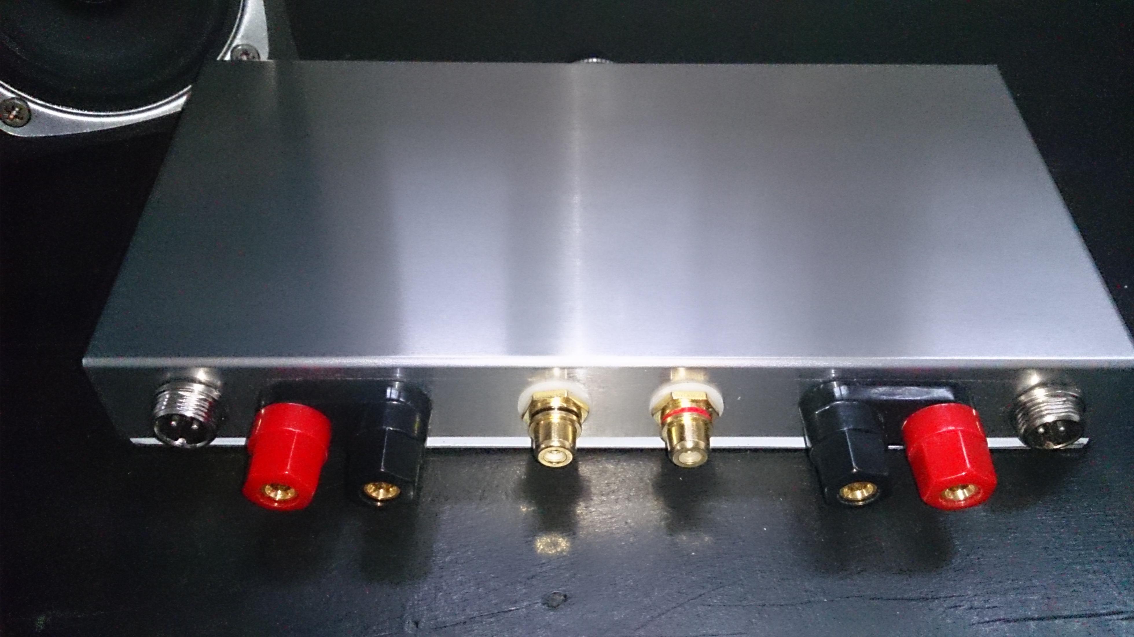

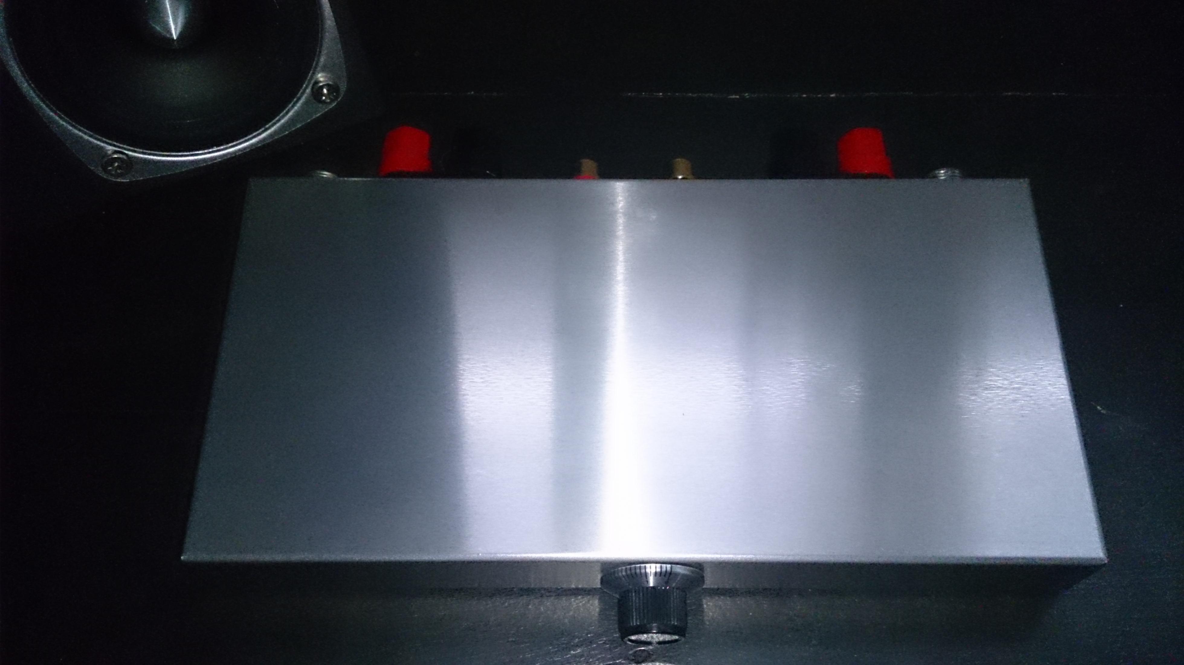

If you have sa60 open, could you make a picture that shows a little more than shenzen pictures ? 🙂
Well. if anything else sounds good, why not selling the 805? 🙄
.. Expensive speakers, cheap low grade chinese amps, which needs to get "modded" to "sound good".. Oh well..
:thumbup:
The 805 is like a very difficult, high-maintenance woman who requires that you meet her impossible standards all the time. It's a pain - but ultimately worth it.
Many amps sound terrible on the 805. Few sound good. But the ones that do, that gives her what she wants, yields an incredible reward in sound quality.
The 3116-based SA-60 did better than most amps, regardless of price. I want to try a pair in biamped configuration to see how they do.
Haven't had a chance to open the case yet but when I do I'll take and post pics here.

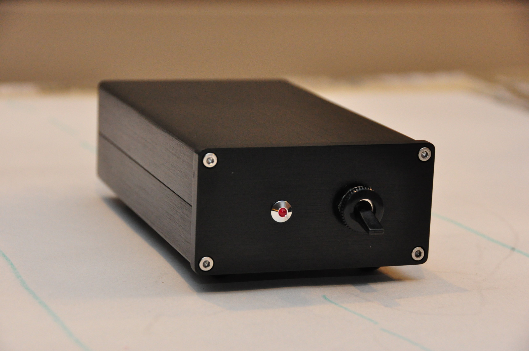

Here's my second build using the new Sure tpa3110 amp. The only mods are replacing all the electrolytic caps with fancy organic polymer caps. The Panasonic OSCONs have been the favorite in this thread; and in fact I used those on my first build with this board. Based on irribeo's suggestion a while back, I spent the big bucks on these Nichicon NU-series "FPCAP" capacitors (part number RNU1E331MDN1PH). I'm not sure they were worth 2x the cost of the OSCONs. Nothing wrong with them, of course, but I don't believe I'm hearing any improvement over the Panasonics.
(FWIW, I also added additional terminal blocks and removed the on-board RCA connectors.)
Anyway, I took my time and tried to do neater work than I usually do. I'm happy with the result. Only real problem is the speaker binding post holes weren't drilled perfectly straight, so one "leans" into the other one. (All aluminum was drilled with a handheld drill, no drill press.)
I also sourced my RCAs and speaker binding posts from Mouser when I ordered the caps. These were a little more spendy than the cheap no-name ones I usually get from ebay. I don't know if they sound any better, but they are certainly heavier. Something to be said for that, maybe?
The switch just opens and closes the connection between "SD" and "GND". Close the connection to put the amp in "shutdown" mode and prevent turn-on/turn-off pops and thumps.
Anyway, enjoy the pics!

Very nice work! I would buy this if they were sold premade. 😀
I have one question though: the outputs are labeled +, -, -, + is this correct? Because the chips always output -, +, -, + based on input pins for single-ended unbalanced inputs having positive located towards pin 1. The output pins follow and never cross - unless a fancy multilayer board with vias is used. I know this was a problem on the 3116 board from Sure. Is it also a problem on the 3110?

TPA3110= +--+ for fun I also did with my double PBTL 3110, visual recognition🙂
