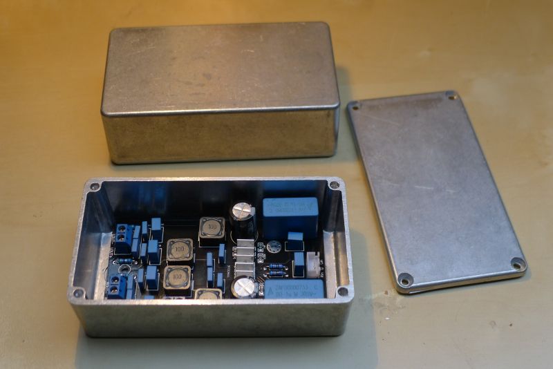

In case anyone is looking for a cheap enclosure: the Danzz version fits perfectly in a 125B style enclosure ($4.99 at Tayda). I'm going to try fitting a speakon socket in there and use it as a bass guitar amp.
that´s awesome!!
i like tayda.
they have good prices and deliver incredibly fast.
my last two orders took only one week from thailand to germany.
please post a pic when have managed the sockets.
i imagine that wiring is not easy in that little space.

Nice tip on the Hammond 125B box. Look at all the colors they come in.
http://www.mammothelectronics.com/4S125B-p/500-1002.htm
4S125B DIECAST ALUMINUM ENCLOSURE
This one from Parts Express for $10 works good for the Blue/Black board if your
adding a pot/knob, and switch.
Aluminum Amplifier Case 1.93" H x 2.94" W x 4.72" D
