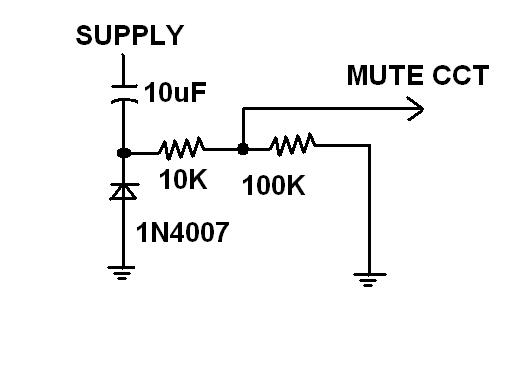

multiple pop issues
Hi all,
Yesterday came a new issue I never had while modding a yj 3116 blue board:
With this modded board, when turning on, I have not a single 'pop' in my speakers, but 3 pop, 1 big pop, 1 second later another one, and 1 second later another one.
I don't know if it comes from a bad soldier, or bad component,
the difference with my other boards is I have 7.8uf at input dc decoupling cap
1 wima MKP 1uf 250v and 1 k73-16 6.8uf 250v
my other mods are:
tdk x7r as bootstrap capacitors
panasonic oscon as dc power caps
330pf/10R bootstrap mod
despite this bad pops, sound is very good.
any help to understand why 3 pops at start up ?

A number of weeks ago I reported that my Ybdz boards did this from the get go but the popping for me didn't stop after a while. I replaced the main capacitors and it did nothing. So I too am eager to hear any more insights on the issue.
From data sheet "SLOS708C –APRIL 2012–REVISED NOVEMBER 2013"
"The impedance seen at the inputs should be limited to an RC time constant of 1 ms or less if possible. This is to allow the input dc blocking capacitors to become completely charged during the 10 ms power-up time. If the input capacitors are not allowed to completely charge, there will be some additional sensitivity to component matching which can result in pop if the input components are not well matched."
So there is a probability that larger input caps will produce pop issues.
The use of a power-up mute circuit should let the amp settle without speaker pops.
