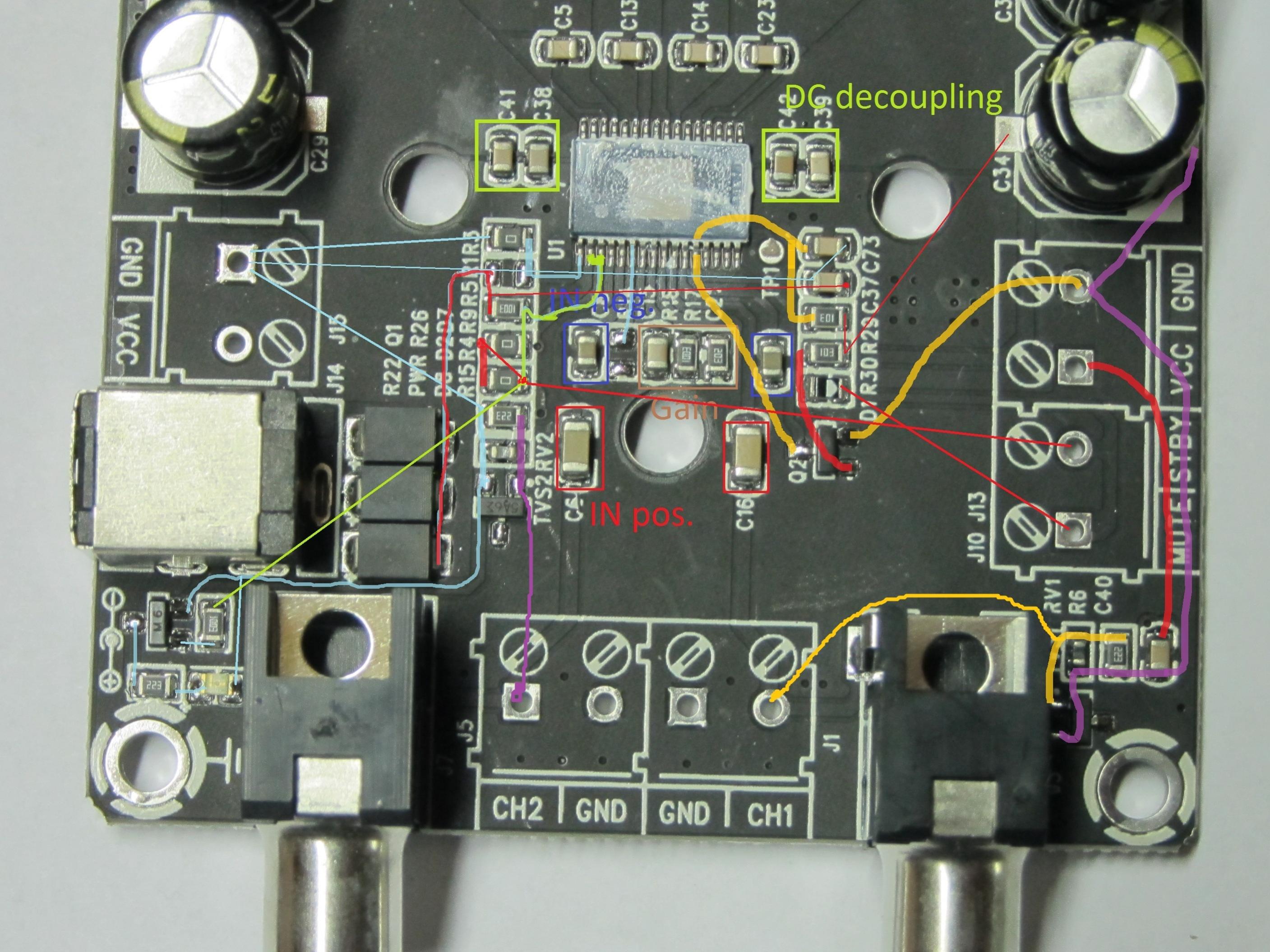

I tried doing some trace finding for Sure board. I know picture is a mess, but it gives some idea where everything is going.

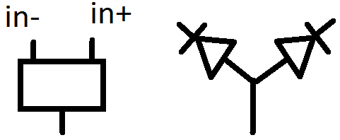

I find parts marked as TVS1 and TVS2 very interesting, because the way they connect to inputs. On the part is reads 5A6Σ (or 546Σ). Might this part been used by Sure in hopes it would reduce turn off pop? I didn't find any datasheet for the part, but using multimeter I can find two diodes with forward voltage of 1,174V.
I guess Q1 (near power jack) is just used for LED, Q2 is for mute function when MUTE pin is connected to GND (absolutely not sure about this).
All traces might not be correct and I could be wrong about the part, but what you guys think?
Better pictures for the board are here.
5A6 diodes? Maybe inputcapacitors for DCblocking aren't necessary? I mean these seem to block DC towards source too, not from source?
