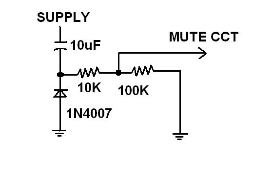

I have a question though... Why is D1 there? There is an explanation about a negative voltage on the mute pin. Huh? Where is that negative voltage coming from? Do you mean for protection in the event of a voltage spike somewhere? I'd hardly see that as relevant for a simple logic circuit.
That is to protect that input when powering down.
This cct is what I use on my boards.
With this cct the mute pin never sees more than 1mA reverse current.
Doug

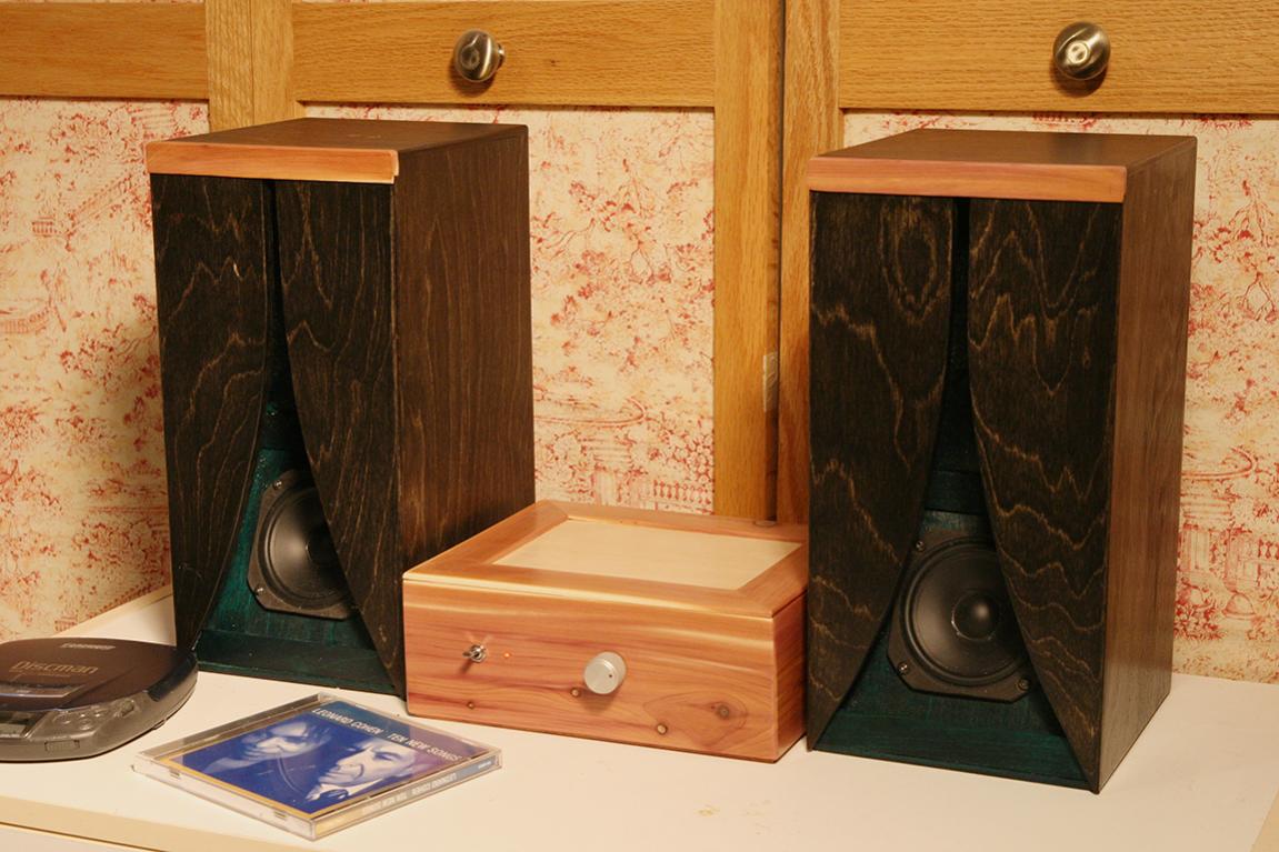

Well I have had more time to listen to a wide variety of music on this system.
So far the only sources I've tried are a portable Sony CD and an iPod Classic 5.5. I and some friends have been very impressed with the sound 😀
I never thought I would hear mp3's sound this good. There seems to be something about these 3116 that improve the sound of the mp3 files.
Thanks to all for making it possible for me to build such a great sounding stereo 🙂🙂

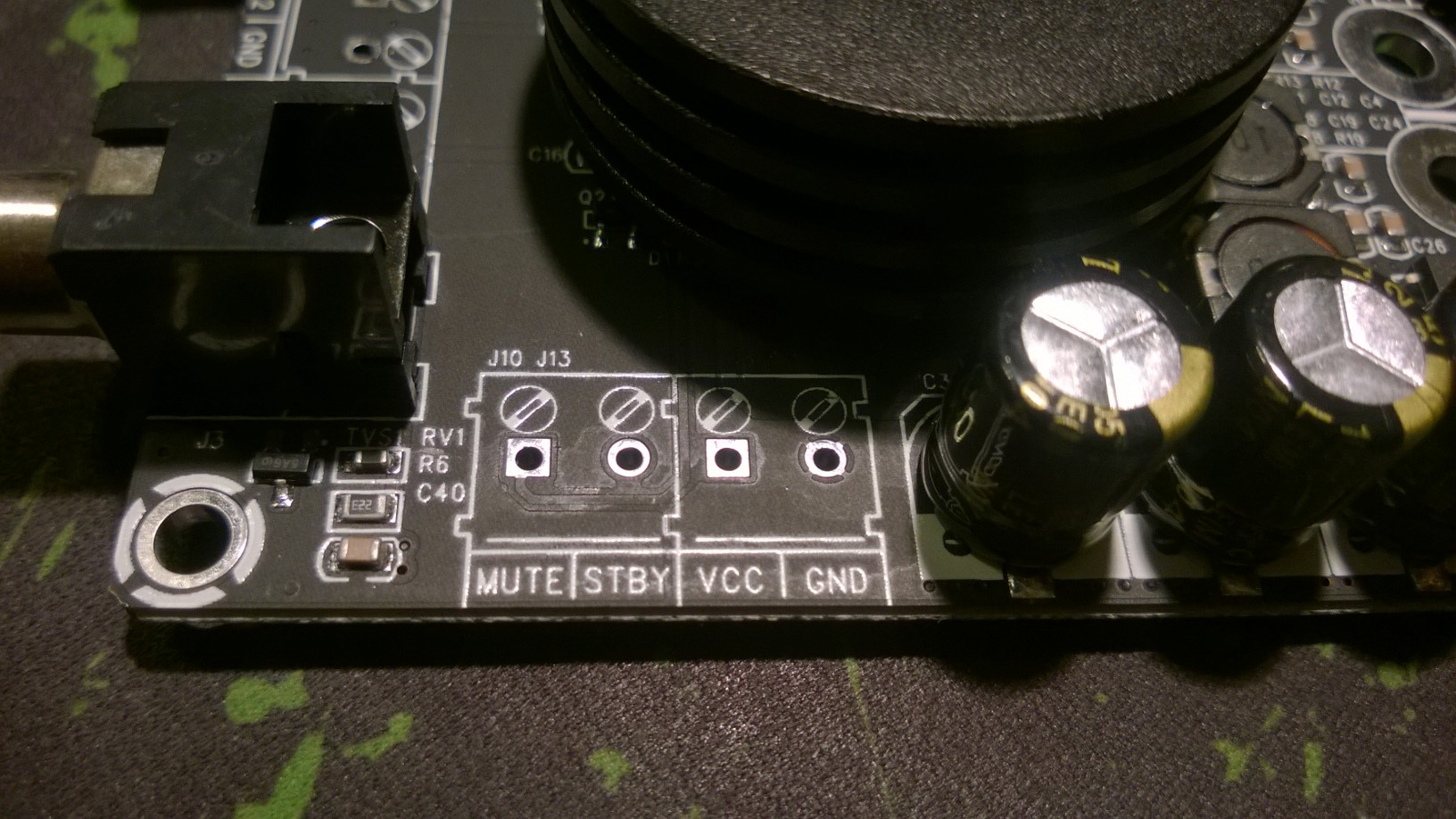

Matt, can you provide any more details on how you eliminated the turn on/off pop? I have a brick PS that I want to be able to plug and unplug from the wall while leaving the DC plug in the Sure board, but I get a huge power-on pop.
I see "Mute", "STBY", "VCC", and "GND" holes in my board, but no "SD".
Going from memory here (you have been warned!), I believe that "STBY" == "SD" on the Sure boards. It's easy to test with a paperclip, just jumper STBY to GND, then plug in your mains power. When you're ready to listen to music, remove the jumper.
When you're done, first put the jumper back in place, then pull the AC power plug.

So the switch goes between the STBY and the GND, right? And since I've already established my noob-ness, what's does VCC mean? I figured it's line voltage (19v in my case), but what does it stand for?
I'd like to find a nice switch with the 10mm pin spacing for the board, as I'll have it, and the Guanzo two-tube preamp, on display.

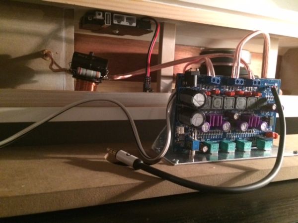

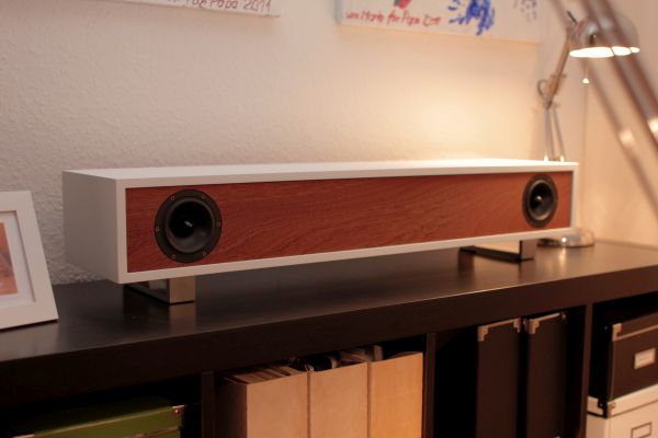

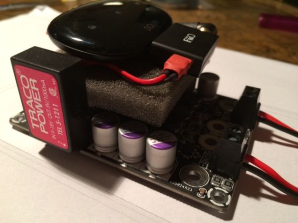

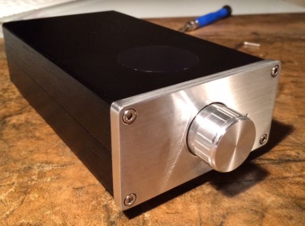

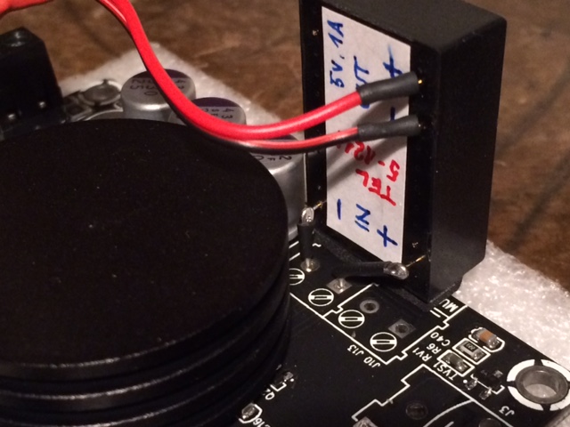

Finished my DaytonRS100-4 Tabletop project with the Feixiang 2.1 for now, I guess the x-over works good enough for that purpose but I've learned my lesson well:
Don't finish up any speakerenclosure until you heared it's sound! 🙄
Unfortunately the overall sound doesn't quite match up with its looks and this is not because of the Amp, I guess..

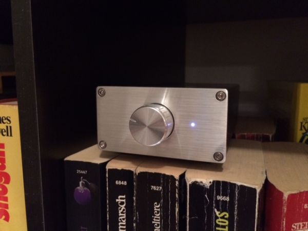

So I left that for now, put a Dolry to my Sure 3116 and hooked it to some Heco Aleva 200 bookshelves to have a simple to use Airplay amp. An Alps pot with switch makes it a one-knob solution, I love that feature. The Dolry needs about 20 seconds to boot up and besides the Sure's little turn-off pop it's dead quiet. Sounds great imo and easily strikes the DTA-2, which I used before in a similar setup. No need for a sub anymore.
Doug
A 2.2µF cap and a 22Kohm load resistor would probably work just as well. It only has to delay the MUTE pin unmuting for 10ms. 10µF and 10Kohm is 100ms, and 2.2µF and 22Kohm is 48.4ms. It's easier to find a small outline 2.2µF cap than a 10µF.
