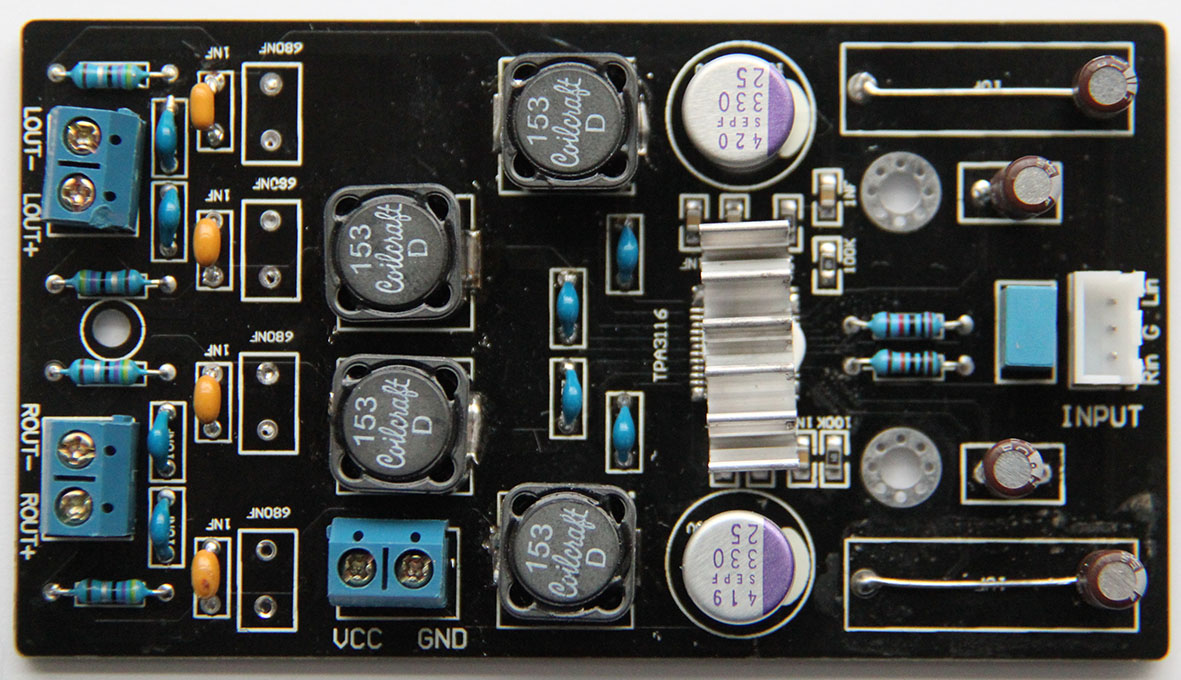

YJ Blue-Black board Modifications
I made the following modifications to the standard YJ Blue-Black board:
Snubber Capacitors: SMD 0603 Multilayer Ceramic 330pF 50v C0G 5%
Snubber Resistors: SMD 0805 10ohm 0.25watt 1%
Bootstrap Capacitors: Multilayer Ceramic 0.22uF 25v X5R 10%
LC Filter Inductors: Coilcraft MSS1210-153MEB 15uH
LC Filter Capacitors: Multilayer Ceramic 0.68uF 50v X7R 10%
Output Filter: Multilayer Ceramic 0.01uF 100v X7R 10%
Input Capacitors: Elna SILMIC II 10uF 35v 20%
Power Supply: Panasonic 25SEPF330M 330uF 25v
I replaced all bootstrap, filter and snubber capacitors with multilayer ceramic capacitors as recommended in the datasheet and Evaluation Board Guide.

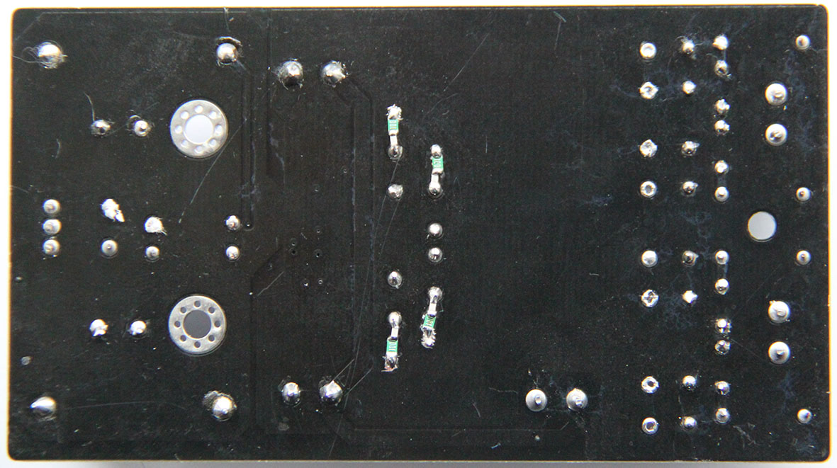

The snubber circuits were added on the bottom of the board using SMD components. By mistake I ordered SMD 0603 size capacitors instead of the slightly bigger SMD 0805 size, so soldering was a challenge.
Given the physical layout of the tracks and ground connections on the YJ Blue-Black board, the 1nF capacitors of the output EMI C-RC Snubber is directly in parallel with then 0.68uF capacitors of the LC filter. The 1nF (0.001uF) capacitor is completely masked by the much larger value 0.68uF capacitor. I have therefore omitted the four 1nF snubber capacitors and simply mounted the 0.68uF filter capacitors in the position of the 1nF capacitors. This leaves more space for upgraded inductors, if required.
The YJ Blue Black Board has a gain setting of 26db with an input impedance of 30kΩ. A -3db bass roll-off at 20Hz, requires a 3.3uF capacitor. I already had the SILMIC II 10uF capacitors on hand and fitted the 10uF and it sounds very good.
The inductors were changed to 15uH, which is a better mach for the 6Ω impedance of my speakers. The inductors also have the same footprint as the original inductors.
Power supply is a laptop SMPS brick delivering 19v at 4A. An additional 4700uF 35v decoupling capacitor is connected directly to the power supply terminals of the YJ board with the power supply wires.
The result is very satisfying and sounds very good, comparable to my NAD system.
