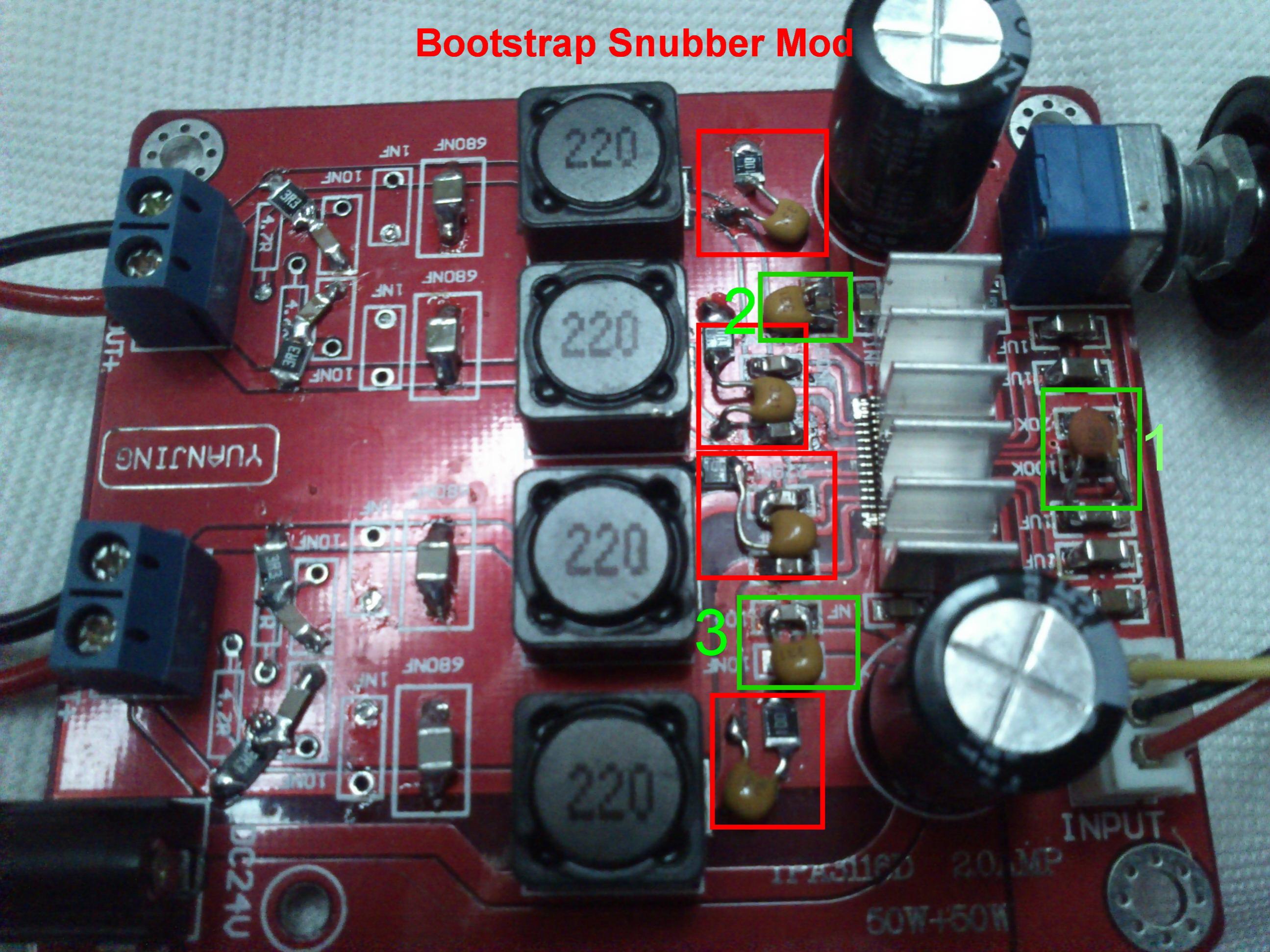

None of these(green) are related to outputsnubbermod.
Green 1 is interesting but might just be for voltage output??, I think green 2 could help, green 3 is lost because 104 is so far from tpachip it is useless, but they also say through hole components are useless for high 'speed'.

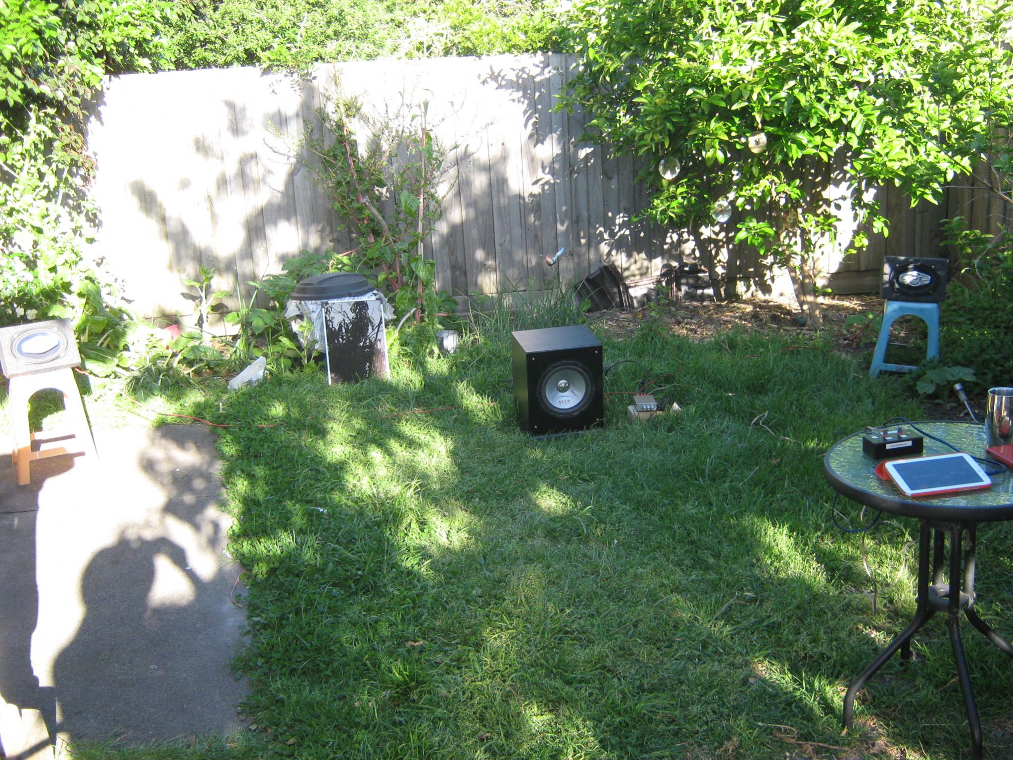

breeze 2.1 TPA3116 amp, "FS_tone" knob frequency response
My breeze 2.1 TPA3116 amp showed up a few days OK, it seems fine.
As I got it as a "picnic amp" to drive some old Pioneer car speakers and car sub I got from ebay I'm not concerned with tweaking it yet, but I did want to figure out what the "FS_tone" knob does, so I graphed the frequency response using Room EQ Wizard and a voltage divider on the speaker out.
Here are my results:
full res: http://pix.minirig.org.au/main.php?g2_view=core.DownloadItem&g2_itemId=6870&g2_serialNumber=1
Soundcard used was a behringer UCA-202.
I used a 27K & 1K resistor as the voltage divider on the output to get the output from the amp, then isolated from the soundcard using an old DI box (transformer).
Sub used is a Pioneer TS-W254C (4 ohm car sub) in a 33L sealed box. Using this as I got it for $3 on ebay with a busted plate amp, which I have discarded 🙂
PSU used was a 20VDC 50W laptop type PSU.
I just gradually nudged the FS_tone pot through it's range of motion for each measurement, so the increments arent exact, but at least it gives you the idea of what the filter is doing. For the highest 1/3 of the knob range it does barely nothing, which may be why other posts reporting it doesn't work. The strange little notch in response appeared at the 3rd-7th lowest "nudges" then went away.
measurement rig:

Nice work! Thanks for doing this. It confirms why a XO freq of 340Hz was what I got - that is -6dB point.
No worries, was interesting, and now I know the limits I'm working with. I'm using some Pioneer 6x9 car speakers that seem to tail off @ 200hz as satelites and it sounds OK with the SF_Tone dial backed off a bit, but I have yet to break out the microphone and measure the whole lot.
With the 4 ohm satellites I could just get some 100uf cap so they crossover @ approx 340hz as one option for this little battery powered picnic setup.
