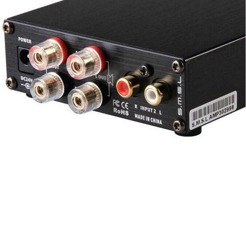

It's not FCC qualified either. The FCC logo is a Chinese lookalike.
The box the unit is sent in and the unit itself both include the FCC certification logo and the CE logo (as in Conformité Européenne). This is the manufacturer's certification that the unit complies with the standards of the FCC and CE.
Now we all know that some Chinese products (as well as products from many other places) contain statements on them that may not be correct.
However, my own use and informal testing of the unit would support that it does not have noise emission problems in my setting. But I'm just an end user, not the manufacturer.
See photo of rear panel attached.
That's not a proper CE marking - this one is for "China Export", and means practically nothing, since it isn't controlled by anybody.
The proper "CE" (as in Conformité Européenne) marking looks differently - I suggest you check this issue online, e.g.:
https://www.google.com/search?q=CE+...5HML8ywP7_IDQCA&ved=0CEwQsAQ&biw=1418&bih=908
Wikipedia "CE marking" article:
CE marking - Wikipedia, the free encyclopedia
Regardless of the "fake" CE mark, if the unit doesn't have any serious emission problems, I'd leave it at that. Works well, sound is OK, so this isn't an issue - unless you want to resell it on the EU (or USA) market: that would be quite an issue then, and would require (expensive) re-certification for the local EU/USA market.
It appears the unit is already being sold and shipped to Europe by the authorized distributor, Shenzhen Audio.
I've emailed them to ask if the unit conforms to the CE standards - as in Conformité Européenne. I'll report back their reply.
Some European high end brands use the fake CE marking too, check six moons LOL they probably have enclosures made in China 🙂 Audiopower.it has fake CE on pcb boards produced in Italy, or had, Bang&Olufsen Icepower, made in China btw, has fake CE on pcb sometimes etc etc
Even when careless producers could use real CE marking they make mistakes. Chinese producers use fake parts everywhere, fake markings too, ChinaExport logo was intended to confuse and is very succesfull.

If it's FCC qualified it has a traceable FCC ID# as well.
Logo is fake or careless, probably just fake hereIf it's FCC qualified it has a traceable FCC ID# as well.
https://apps.fcc.gov/kdb/GetAttachm...belling Quick Guide V01&tracking_number=27980
