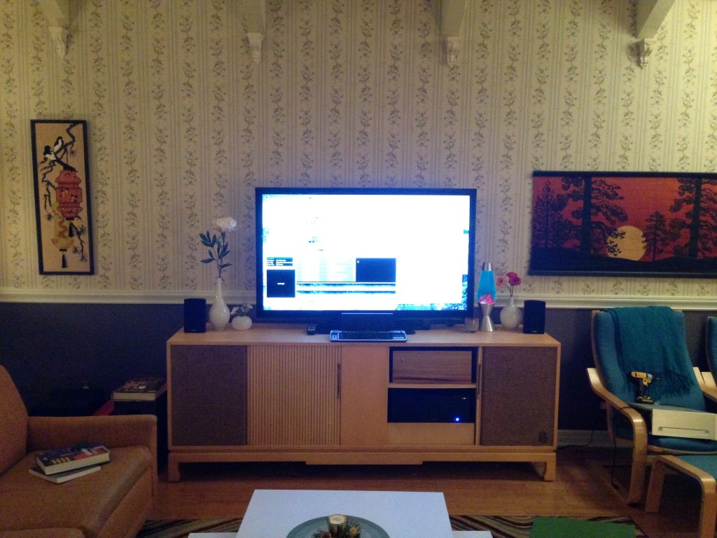

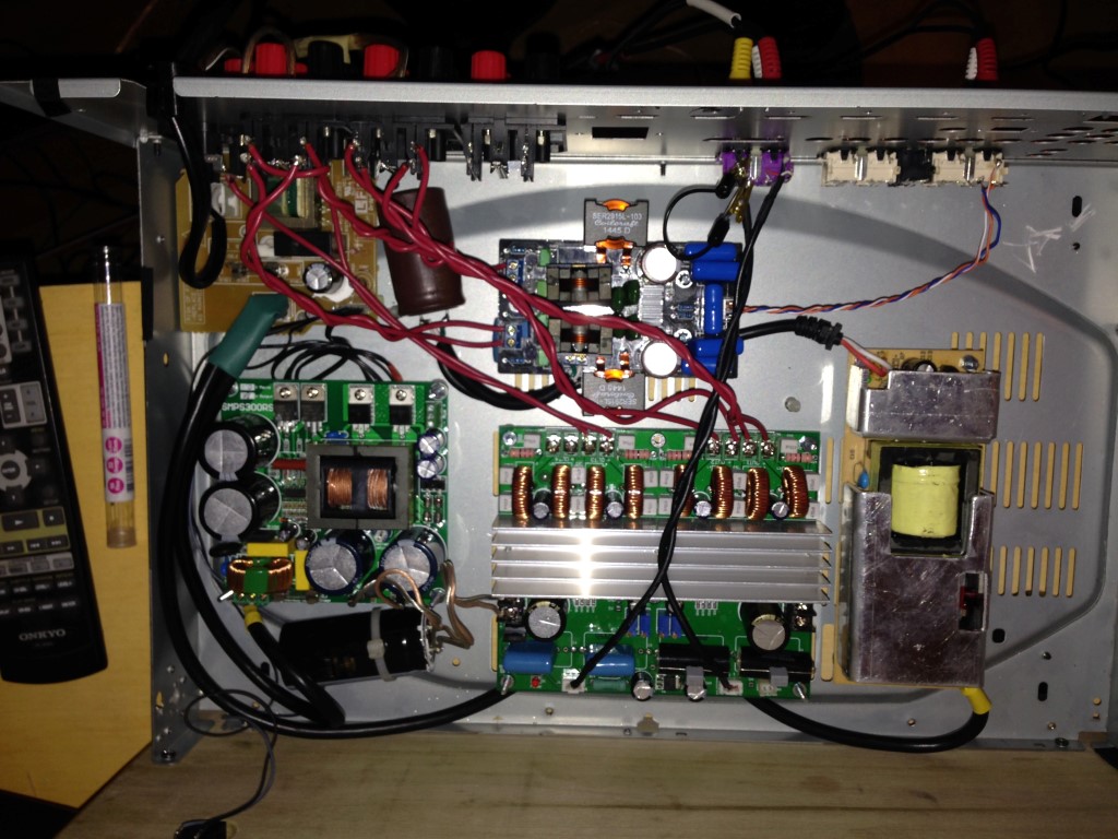

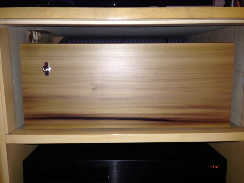

modded my first YJ Black

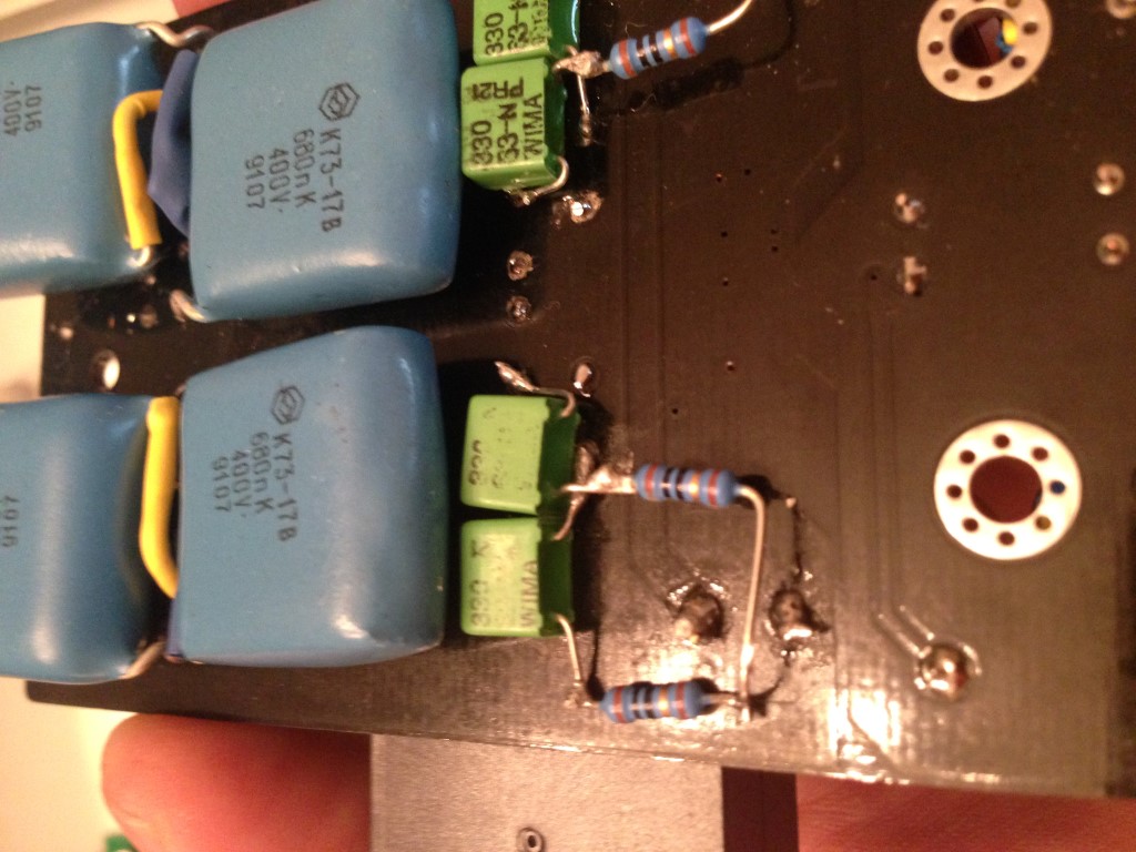

As a fan of tripaths I was somewhat slow to jump on the tpa3116 bandwagon. I thought the t-amps sound very good and there would be little room for improvement. Well I was wrong. At first with the crappy Jamicons the sound was very 2d and not lovely compared to a fully modded t-amp. So I put in some Nichicon Muses and that was really nice. Very detailed and clean, more detail than t-amps but not musical the way a nice t-amp is. Also the bass is just weak. I put in 3.3uf caps all way round but this did not improve the bass just the clarity. Then I replaced all the output caps. Next time I will do that last as I'm not sure I heard an effect. Next up were the boostraps. This helped with the dynamics and was definitely worth it. Next up the bootstrap snubbers. This tames the "edge" in the very top but in no way removes real detail. At this point it sounds very good but the bass is anemic. also, at loud volumes it sounds congested. So in go some Coilcraft inductors and now it is clean and sweet at "anger the wife" volumes. But it still is too thin sounding. So out with the muses and in with some Silmics. Eureka! this is it! Before the bass with the muses was there but it was like angelfood cake. Now with the silmics it is like a heavy, dense, sweet and delicious double fudge browny. The amp is completely silent, no buzz or hum in any way. The dynamics are to die for. I will try the Panasonics next time but I will be surprised if it is in any way better. The amp sounds so fast and detailed. There is nothing muddy or slow but at the same time it is sweet like honey and just sucks you in with a stupid grin on your face.
So Im putting it in a recycled Onkyo case and turning it into my theater amp with an old t-amp doing duties for the surrounds. Made a quick wood face for the amp and it sounds fantastic.

5th blue capacitor is 1uF ? Solids esp FPNU but also wets Elna RJH and Chemicons have better detailed treble/cymbal than SilmicII. For bass PSU is also relevant. YJblack doesn't decouple/filter chip close enough. Output damping resistors have all kind of values on YJblack, if speakers are indeed 4-6ohm for high frequencies like your choice in output values suggests, replace the resistors for 3.3 ohm like TI.
