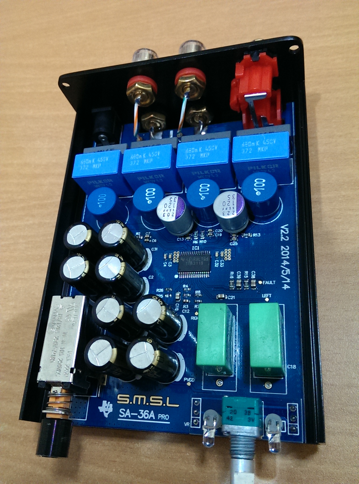

Hello again,
Ok, finally I recapped my SMSL36a Pro PS cap using Oscon SEPF 120uF 35v powered by laptop brick 19v 4.5a. Comparing to BG NX 47uF 6.3v, music has bigger soundstage, more bass, but has lost some details in low and mid, harsh and metalic high treble. I thought it would be faster pace of music, but it is not.
Running Sigma 11 regulated PSU at 24v, music is softer all around, cleaner details, less harsh in high and less metalic treble.
I think it's best using Elna Silmic RFS for the 8 PS filter caps, but I don't have 25v ready, can I use 35v instead?
My amp has a slight turn off thump when volume down after about 3-4 secs. Do I need speaker protection circuit?

From what I understand, the Power supply filter caps should be high quality low-ESR, power-filtering intended caps as opposed to Audio grade caps. However Silmic do rate pretty well and may work, what size are you trying to fit in? I only have 50V caps that are 16mm, a little too wide for those spots on the PCB.
I also found getting rid of those Green "Vishay" input caps and using a genuine set of caps there. I got the Panasonic Metalized Polyester 10 uF/100V recommended on the TPA3116D2 wiki (TPA3116D2 Boards - diyAudio), it definitely added some sparkle and clarity to the sound. Haven't had a chance to listen critically, as I'm jumping between two TPA3116 amp projects at the moment
