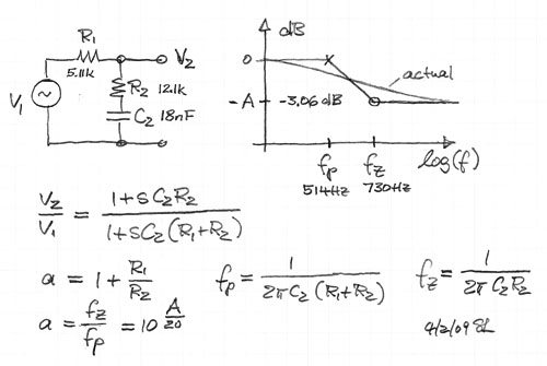

I'm liking the blue YJ 3116 board and I have the Bootstrap, bootstrap snubber and Panasonic oscons replacement parts on order.
My problem is the lack of bass. I have a raspberry Pi and DAC in the ceiling feeding the amp and then onto some ceiling speakers (please no comments about the ceiling speakers - this is what I'm working with)
The speakers are decent (ish) but I would love to mellow the highs and slightly boost the bass and bottom mids. All I have in the celining is a laptop brick supply but I've been considering a Chinese lm1036 board to provide some tone controls....
I would rather not go down this route and wandered if there are any mods that will slightly increase the bass and bottom mids on the YJJ blue board...
I'm using Volumio otherwise I would provide a small amount of eq in software but I can't,
could the experts guide me here, given that I can't change the speakers...

It seems you just need a shelving low-pass filter between the dac and the TPA3116. See #5 on this page for the schematic and calculations:
Active Filters
In your case if R1 and R2 were 4.7k ohm and C was .047 uF you would get about 6db drop above 720 Hz which might be about what you need
Thanks Scotty,
So this is just inserted in the signal path? So I would need 2 resistors and one capacitor for each channel?
I am a noob but feel confident I could implement this circuit, however, I get stuck for hours when ordering components - there are sooo many choices!
Could you recommend a manufacturer and component type for the 4.7Kohm resistors and particularly the .047uf capacitor?
I'm presuming this will be much cleaner than a dedicated preamp with tone control....
Stuart
Stu
The best cap configuration will depend on how you implement this. The components are cheap, but shipping to your house vs mine may vary a lot by supplier.
I have bought resistors from ebay here... cheap and measure out ok
100x 1 4W Watt 0 25W 4 7 K Ohm Metal Film R Resistor GRS | eBay
and small lots of caps from here... fast and all seem legit
WIMA MKP2 Metalized Polypropylene Caps 047uF 100V 5 x 5pcs | eBay
Those would be good enough for a system using ceiling speakers if you built the filter on a scrap of perf board.
But you may be able to wire this directly on a cheap DAC using radial poly caps and 1/2 watt resistors (thicker leads). The branch with R2 and C2 just goes from the output + to output ground. R1 has to go inline between the last component on the output circuit and the output jack. Could you cut the trace and bridge the cut with R1? Looks do-able on my $8 usb dac like this one:
New Mini PCM2704 Hi Fi USB DAC Sound Card Board ELNA Capacitor for It | eBay
On a Pi B+ this sounds pretty good. Mine dac is several years old and the L-R outs are reversed! Im thinking I may pull off the output jack and solder on a three wire connector for my TPA3116. Your filter would be a snap to implement at that time.
BTW, if 6 DB is too much attenuation, just parallel R1 with another 4.7k and you will have about 3 DB. If you need more than 6 DB, then instead parallel R2 and you will have roughly 9 DB.
