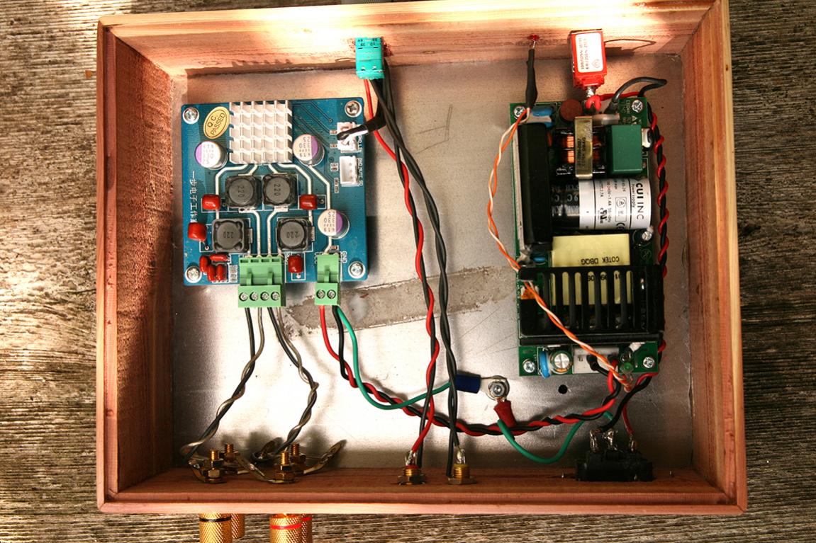

Thanks for your replies. 🙂
I have changed the 2 prong for a 3 prong and grounded it and the amp to the chassis. Will this work?

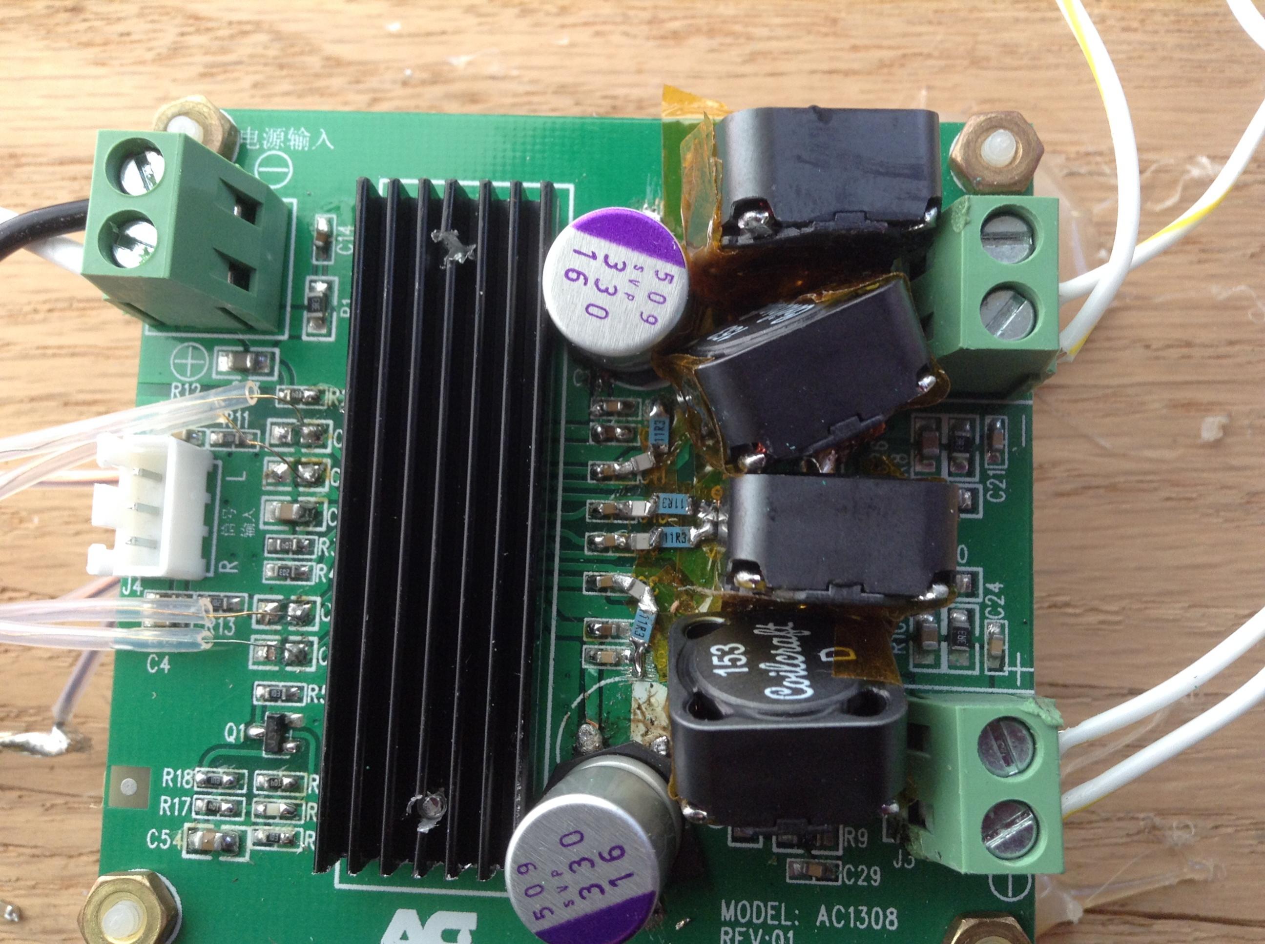

My modded Audiobah board.
Lundahl input transformer (in my DAC) and removed input caps, oscon power supply caps, bootstrap cap/resistors out and output inductor mod.
BTW, I am feeding it 12VDC from an Astron power supply, which is why I can get away with 16VDC oscons.
Sounds very nice now 🙂

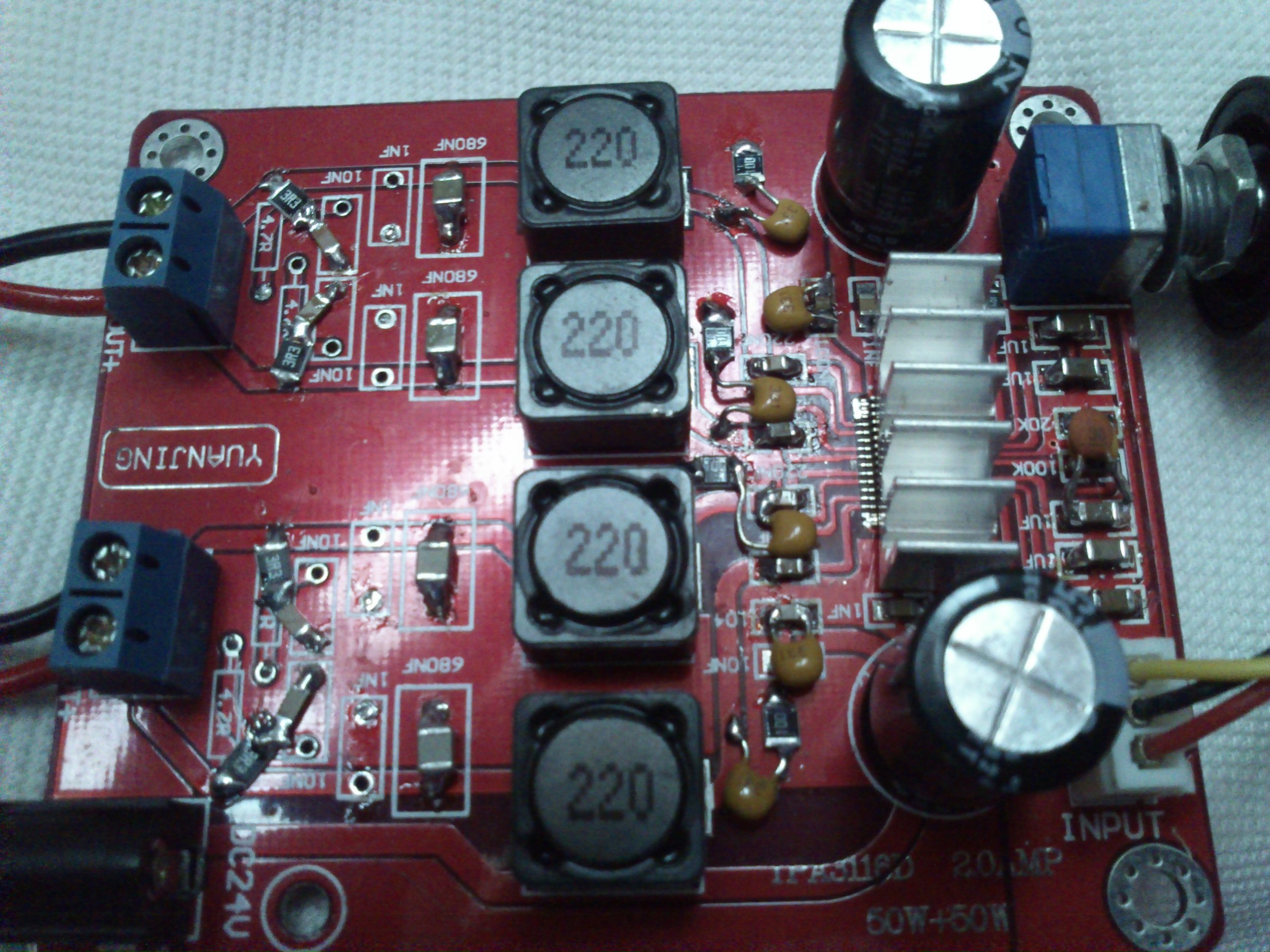

RED YJ TPA 3116 BOARD--MY EXPERIENCE
After reading so many glowing reports of the board , I decided to learn SMD soldering by modding this board.
I thought the pcb quality is OK but the caps used are of dubious quality as expected for a board of this price.
I change nearly all the caps on this board and substitute with x7R caps and COG caps bought from element14.
Input caps are 2.2UF x7r caps. The existing 1UF caps are in fact very good and compliment the chip well with a very silky mid range
The power caps are replaced with Nichicon VZ 1500 uf.
TPA 3116 is very sensitive to low value x7R bypass caps placed as close to the chip as possible. I add 331 COG bypass caps and the resulting sound is much clearer and enhance treble realism.
The original YJ red board use different value post inductor R and C filter values . Changing to the evaluation board values should be performed as the first step in the mod of the board. I follow the evaluation board pre and post inductor filter values . This change results in obvious sound improvement.
The next change the .22Uf bootstrap caps to better quality ..
Bypass the 1UF cap on the GVDD pin with 331 COG cap results in discernible improvement in stability of the soundstage.
About a half a dozen of my friends have auditioned it and everyone is impressed. The typical comments is very stable deep and wide sound stage and very balanced high,mid and low frequency. Despite the fact I am using the markaudio 12P fullranger , everyone commented on the tunefulness of high quality of the bass.
Thanks to everyone who share their experience on this thread.
My next mod is the inductor change.
