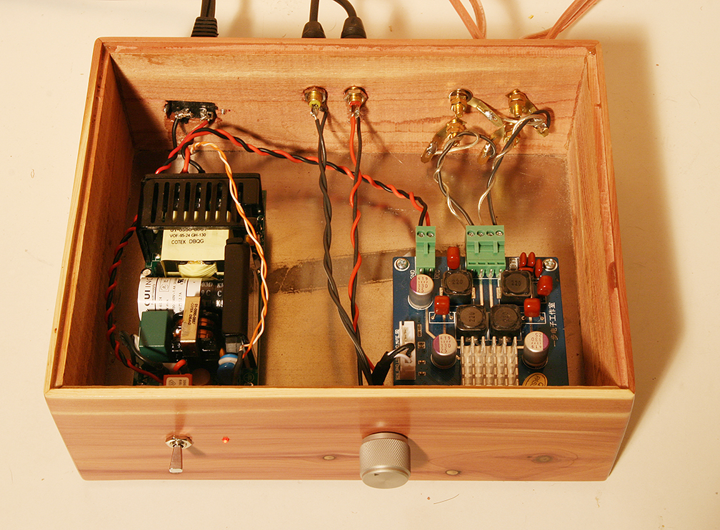

Wanted to put the board into a lego box earlier, but when I hooked it up to check if the signal connection is soldered okay, I just couldnt unhook it. Still listening to the thing😀
The topping tp20 was not only too weak for chr70's in a fh3 box, but the sound also lacked some "body". This is THE thing. I don't really see why, but I may try some stingy mods. Someday. If I manage to give it enough off time😛
Here's the photo I'm not proud of..😛
Looks great to me. The main thing is you got it going and you are trying. Keep up the good work. Put it in a nice box and enjoy. Mine is just stock. I haven't modified a thing and to me, sounds great!

Prezden,
You are dealing with dangerous voltages here and unless you are used to working with 120vac - what you have is kind of dangerous.
You need an AC receptacle and cord that has ground if you want to ground it. If you were to switch the AC input to a grounded one, connect earth ground on AC (green) to ps ground and negative. The box being made of wood doesn't help the safety as the potential shock of touching the volume knob or power switch are still an issue. This is why I stick with SMPS bricks that handle all the AC internally and I am left with only ground and 19v to worry about. You have an open frame supply but you are treating it like a 19v design.
