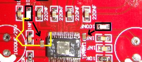

TPA 3116 is very sensitive to low value x7R bypass caps placed as close to the chip as possible. I add 331 COG bypass caps and the resulting sound is much clearer and enhance treble realism.
kp93300
TPA 3116 is very sensitive to low value bypass caps placed as close to the chip as possible.
Did you put decoupling as close to chippins as possible ? Looks like you added some also too far away from chip, like Original, the long legs inductance and esr make functioning even harder, effective distance is close to "can't do anything" distance already, on YJred, but YJblue too. I read a digital designer saying at 1 inch distance they can not perform any part of task that was intended for them.

I am aware of the importance of distance

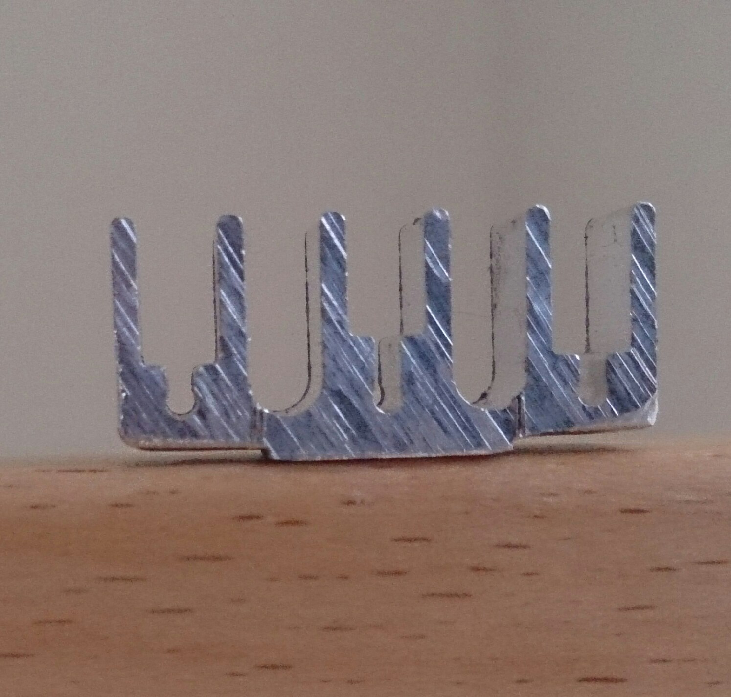

I thought of placing 331 cap on the other bypass sms cap nearer to the chip but there is no space with a probably of touching the heatsink.
I was toying with the idea of removing the heatsink that is hardly warm despite after using for an hr or so.
Despite this , this benefit the high frequency.
Maybe I get some more smd cap and scrap away a segment of the ground plane and soldered directly to the pvcc pin .
102 or 101 caps will be ok ?
what is your experience by power supply bypass?

104 is basicly what is needed I think, xr7 will drop value depending on voltage, cog will remain at value chosen. Yellow line in earlier pic I posted is actual path to left side 104 classII decoupling ceramic on YJred, how much will that 100nF do there, path/distance to your Nichicons is actually smaller. End of Arrow is where I think you could put them, but you can get even closer. Sanding a little aluminium off heatink past part that contacts tpachip is very easy.
On dug and some audiobahs I put 10uF classII ceramic next to 100nF, that doesn't sound bad LOL still searching for Rubycon MU to improve boards further:

Do you replace the heatsink after shortening it ?
what do you use to glue it back to the tpa chip?
