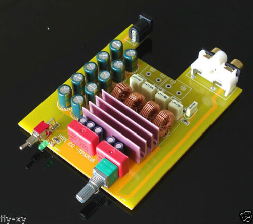

Anti-pop on HIFI board?
Has anyone done anything regarding the turn-on pop supression on the HIFI board (boxed "HIFI" amp) - like the one in the attached photos?
It's a nice amp in a nice enclosure, but I don't like two things about it: instead of power switch, it has a "Mute" switch, and it has a turn-on pop (and a turn-off pop, but that one is not so irritating)... 🙁
Power switch would be better and would avoid arcing when connecting the power cord at the connector on the back... and the mute could be implemented similar to "Giancarlo mod" - by adding 4,7 - 10 uF cap plus a resistor (not sure if a diode is necessary).
And mine has an irritating blue LED - that, at least, is easily replaced 🙂
So, has anyone done an anti-pop solution for this board?
As a sidenote, this one doesn't have "TRIBLE" and "VOLVME" issues, but has "SPERKERS" instead

Is it a mute switch? If you use switch and then remove power is there pop? If you put power on amp with switch in off position, is there pop then?
The existing switch is a "MUTE" switch (although it says "power" on the faceplate). When the swich is activated, there is no sound. So, if you turn on the amp (i.e. plug in the power cord), there is no sound at all - including no pop.
However, then you have arcing on the back, when plugging in the power cord 🙁
Besides, it would be much more practical to have this switch act as power switch, and the turn-on pop muting implemented using a small cap and a resistor ("Giancarlo mod").
Also, the small LED is always on, as long as the power cord is plugged in - meaning that the amp is powered. All points to the fact that this was indeed supposed to be a power switch, but someone decided to do it this way.
This would be the first (and most likely the only) mod I'll do on this board: I was thinking of adding another physical switch as a power switch, but that's an overkill (TWO switches tend to be confusing). Repurposing the mute switch to act as power switch would be much better - and the "turn-on pop" muting would be implemented the usual way ("retarding" cap)...

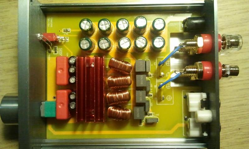

Hi jk44, I have 470uF 35v Silmic II Black 25mm x 35mm. It's big, but I am building a new case for this project so it can be put together with Sigma 11 Regulated PSU.
I am thinking of Silmic II because base on my experience in my audio setup, it will reduce the high range peak and midrange roughness, also increase lower range richness which may solve the problem I am having.
For input caps, I am thinking of Wima MKP10, but hard to source it bigger than 1uF. Anyway, I do have 3.3uF Rike Audio S caps on hand. I may try those 😀
From what I understand, the Power supply filter caps should be high quality low-ESR, power-filtering intended caps as opposed to Audio grade caps. However Silmic do rate pretty well and may work, what size are you trying to fit in? I only have 50V caps that are 16mm, a little too wide for those spots on the PCB.
I also found getting rid of those Green "Vishay" input caps and using a genuine set of caps there. I got the Panasonic Metalized Polyester 10 uF/100V recommended on the TPA3116D2 wiki (TPA3116D2 Boards - diyAudio), it definitely added some sparkle and clarity to the sound. Haven't had a chance to listen critically, as I'm jumping between two TPA3116 amp projects at the moment

I have the same board, it is a very good sounding board just remember to mute it before turning on/off then no pop.
I've always assumed capacitor voltage rating should be higher than actual working voltages, for some safety margin.
Is there any rule of thumb for how much higher the cap voltage should be?
I've seen some discussion on it. I wouldn't get concerned. There's basically not going to be a situation where it matters. Usually it costs more $, so no one's doing much except trying to not exceed the capacitor limits because it's cheaper.
In the case of PSU caps, the KG Nichicon SuperThrough at higher voltage sound better, not because of voltage, just quality of capacitor.
So it this is exactly how TI recommends to powerup and shutdown in datasheet. SDZ is pulled low by switch, amp goes into lowcurrent state to shut down, removing power creates no pop. Giancarlo mod does have pop then and a little ''cracknoise'' on powerup. Putting the tpachip in "standby/sleep/shutdown" is only popless way IMO.
