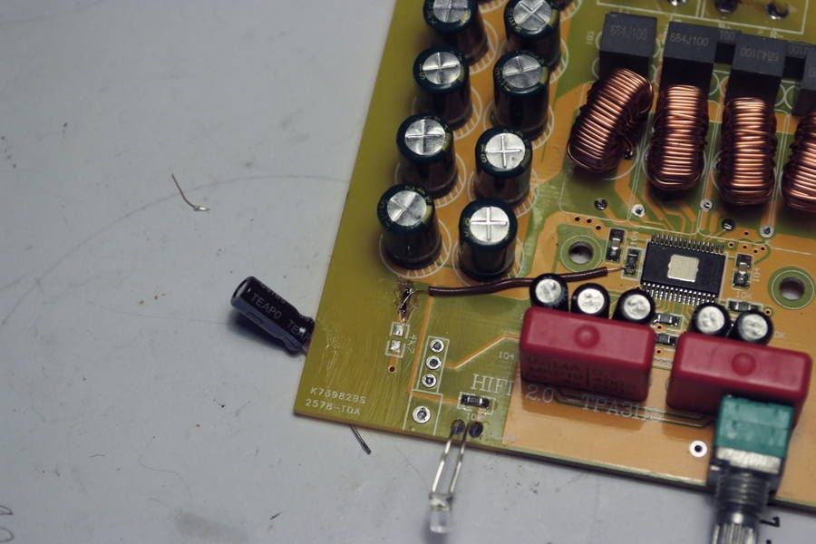

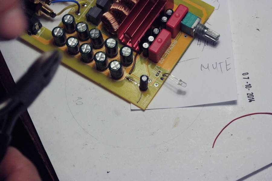

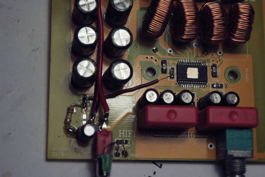

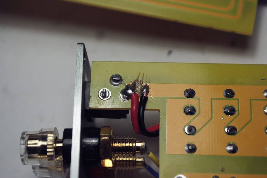

Well, with the help of a friend, I did the "anti-pop" mod, and at the same time repurposed the existing "mute" switch as a power switch , exactly as I intended.
Turn-on pop is gone (there's about 2 sec. delay on turn-on), and when turning off, there is still a slight "thump", but that one isn't that irritating or loud...
Some traces were cut, and a 10 uF cap and a 150KOhm resistor were added (see pics). Oh, and I replaced the horrendous blue LED....
So, mission accomplished. 🙂
So popless replaced for little pop and on/off switching DC, hardly ideal, but fun modding to personal taste.
