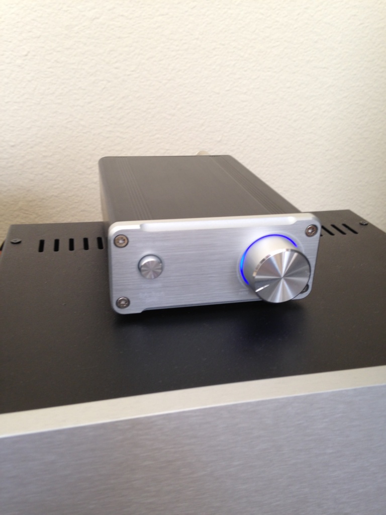

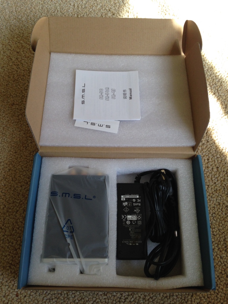

For $49.99 including shipping, I purchased an SMSL SA-36A Pro TPA3118D2 2.0 amplifier from eBay seller wsz0304. It came in the other day and I have been listening to it. I have been using it with my upgraded Astron RS-12A regulated linear power supply. It came with a 12VDC/3.8A SMPS brick, but I haven't used it with the brick yet. After a few hours of playing, I sat down and started critically listening to the amp.
For now, I prefer my modified Sure Electronics TPA3110 amp as it is more tonally balanced from top to bottom. The SMSL has a bit of upper midrange glare. I've heard this similar upper midrange glare with other MKT caps that can go away with more playing time or remain (please no flames if you don't believe in burn-in). I used to have an SMSL SA-S1 TA2020 amp that had ERO MKT1822 input coupling caps that had this same issue, and after a couple weeks, the sound smoothed out and it was a pleasant amp to listen to.
Compared to my Audio Research LS7 tube line stage and modified Yuan Jing 2.0 blue amp (used as a power amp), the difference is greater. The SMSL just doesn't have the transparency, detail and focus. This really isn't a fair comparison, but it might help those who wonder if this complete amp is a viable alternative. If you can solder, stick with your TPA31xx amp of choice for now and mod away.
On the positive side, this little amp is beautifully made, and it is very quiet with almost no hiss. In fact, it's much quieter than my TPA3110 and TPA3116 amps. It definitely has the TPA31xx sound characteristics:

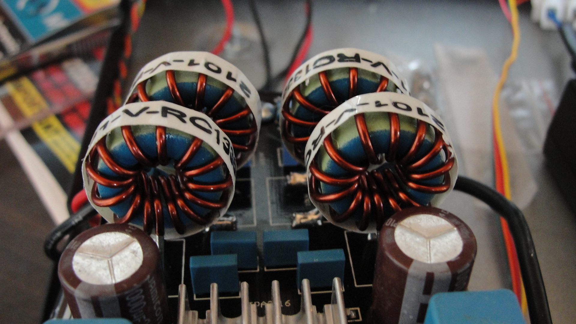

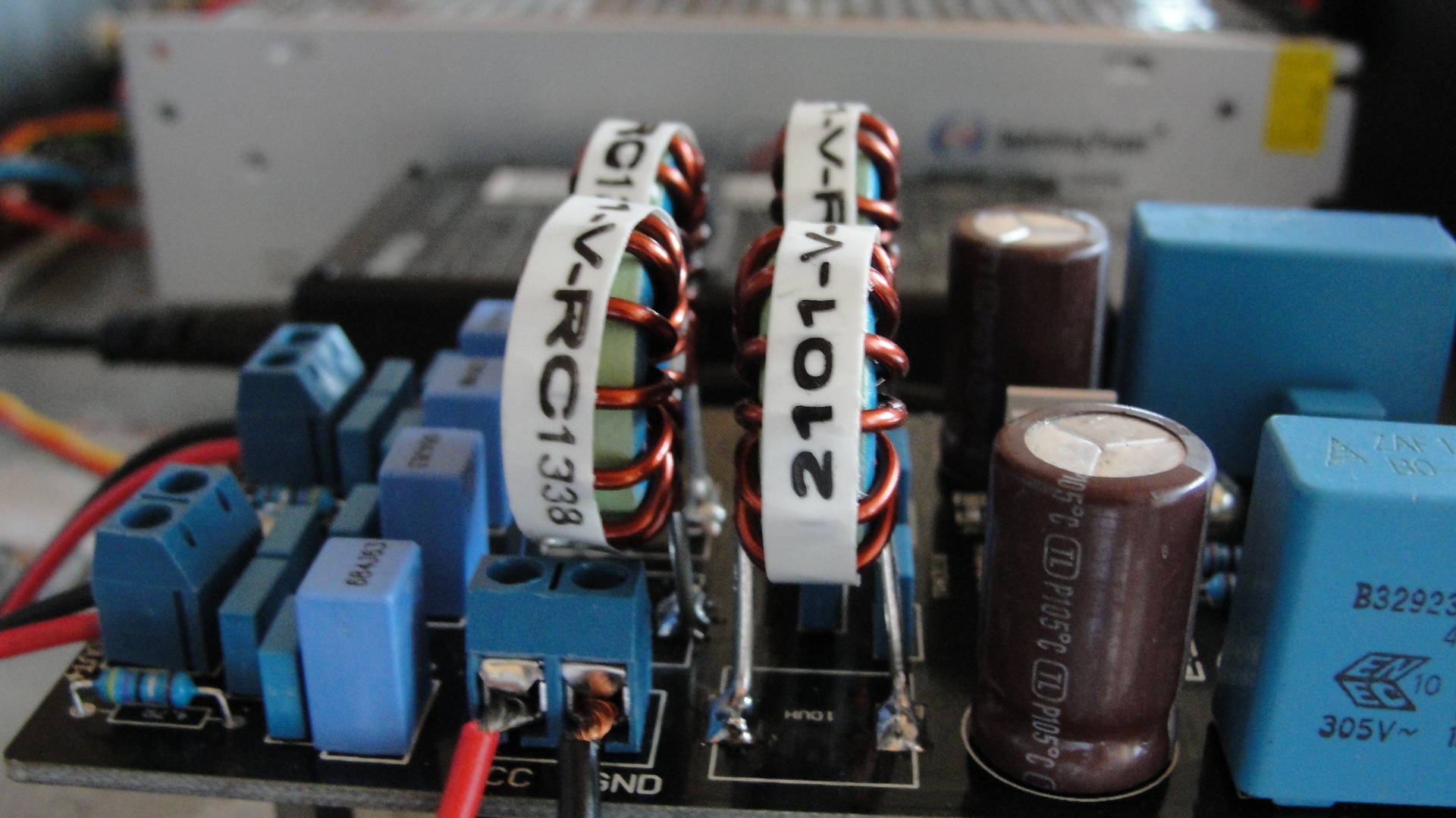

Coils replaced !
I've got the Bourns 2101-V-RC installed today. Soldering/desoldering was a breeze. Am listening to the amp now and really like it. I picked the 2101 model instead of the 2100 due to previous installation of the 2101 toroids on a Sure TK2050 board getting good result.
Everything else on the board is stock.
I also try adding a 100uF capacitor between pin 2 (SDZ) and ground trying to eliminate "power on pop" but it did not work. Changing to a larger cap value does not resolve the problem. Next plan is to install a timer circuit to short input to ground for the first few seconds when power on.

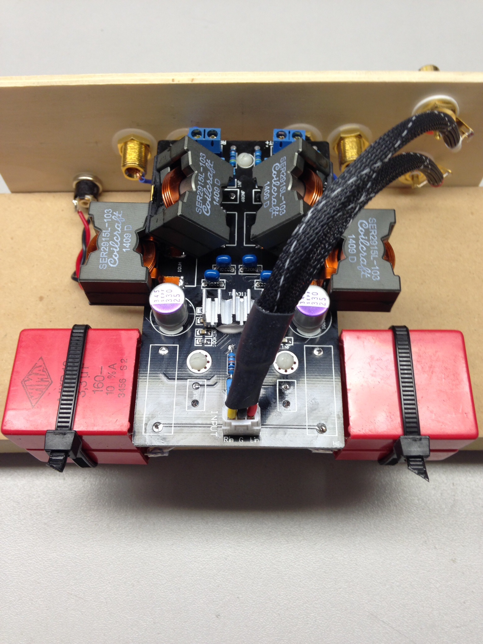

PBTL (Mono) Mode Modification
PBTL (Mono) Mode
(Please comment if the following mod will work and suggest any corrections.)
For the Black YJ board the following modifications are required:
- solder a three way jumper on the bottom of the board, shorting C10 and connected to the output side of C33
- jumper the ROUT terminals
- jumper the LOUT terminals
For the input use RIN and connect the speaker between ROUT and LOUT.
Tested and working. :D
Here is a picture of the speaker connections and the three shorted pads at the upper right:

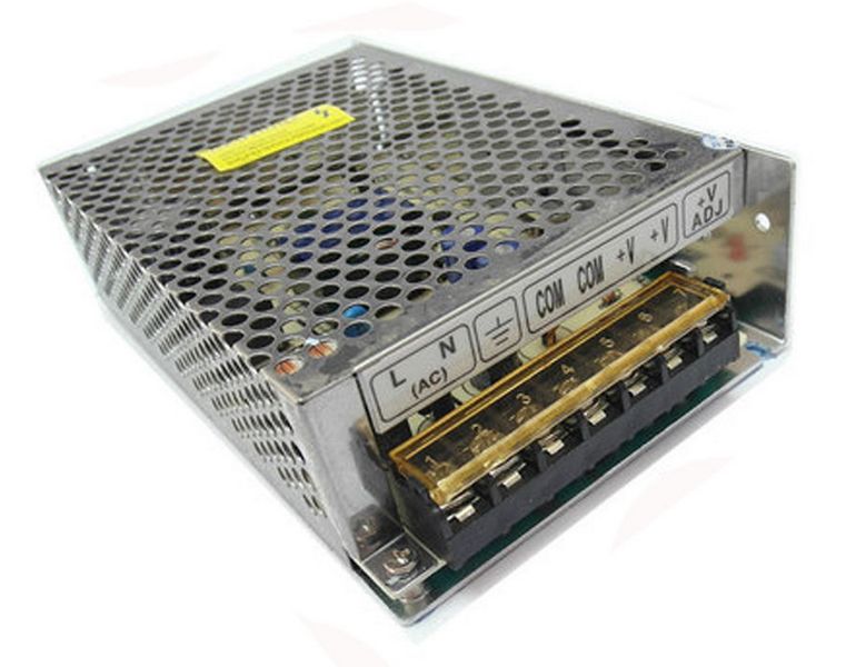

That's the one I have ordered today, but still confused what PSU to use with it, after lost the whole afternoon and eyes on this thread. Apparently there is no consensus which one suits the best?!
I'm planing to order one like this - 12V 5A 60W, that might be good enough not only for the amp. itself but also for the speaker protection board eventually?

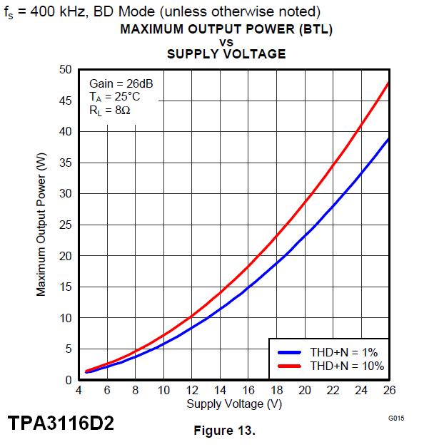

Move up to 18-19V.
