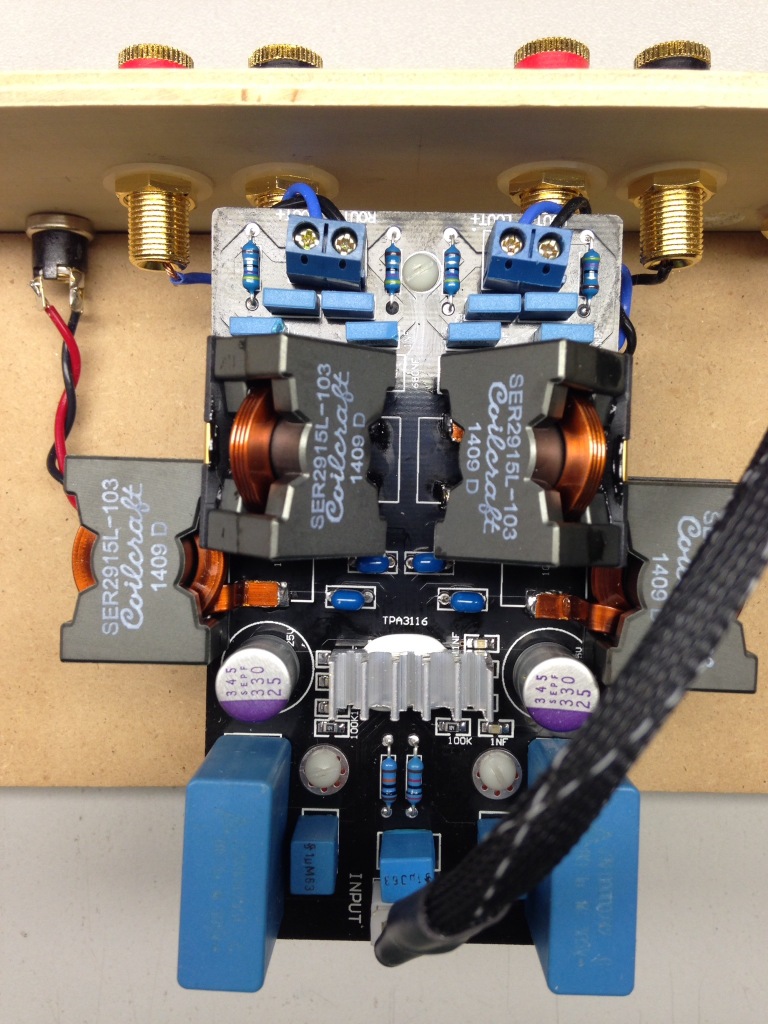

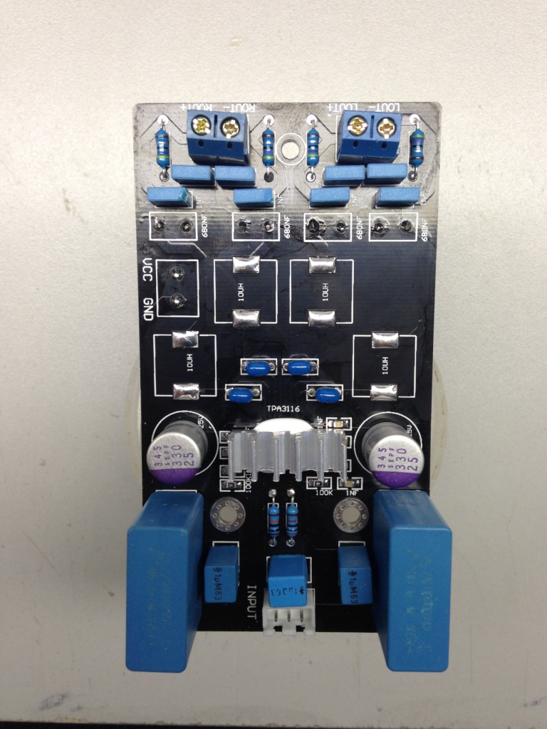

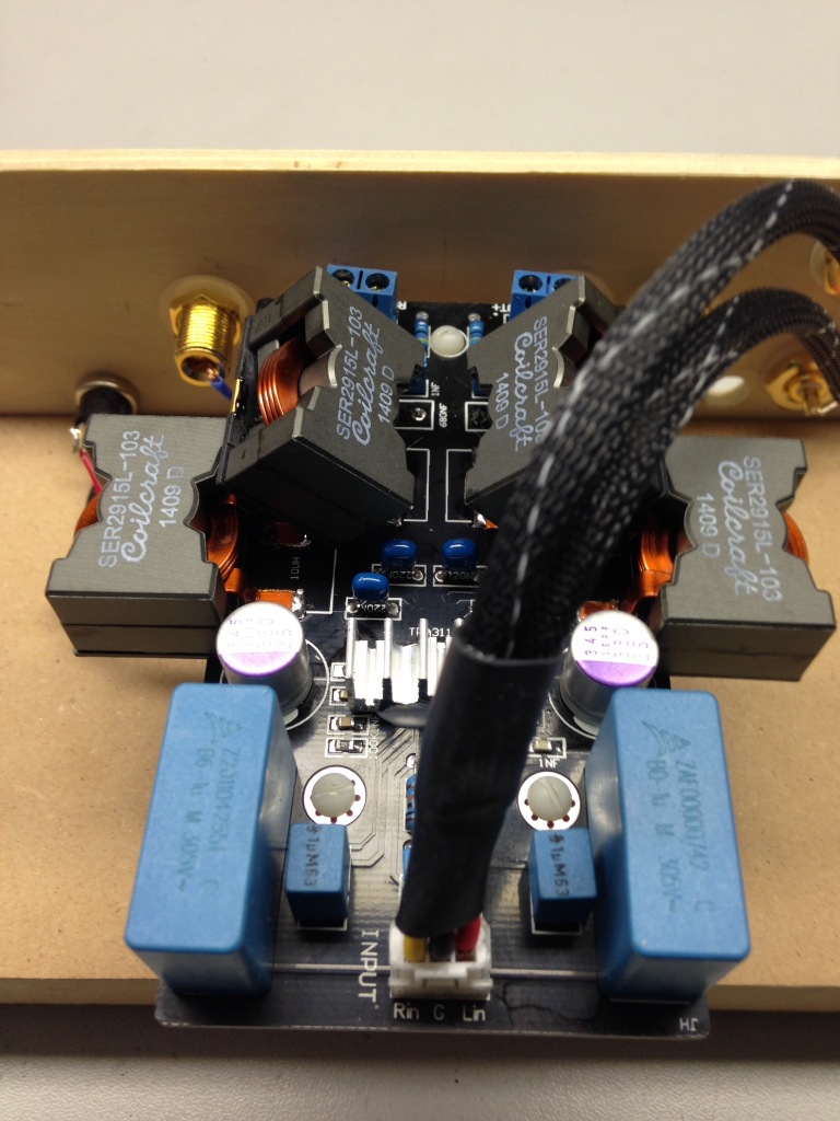

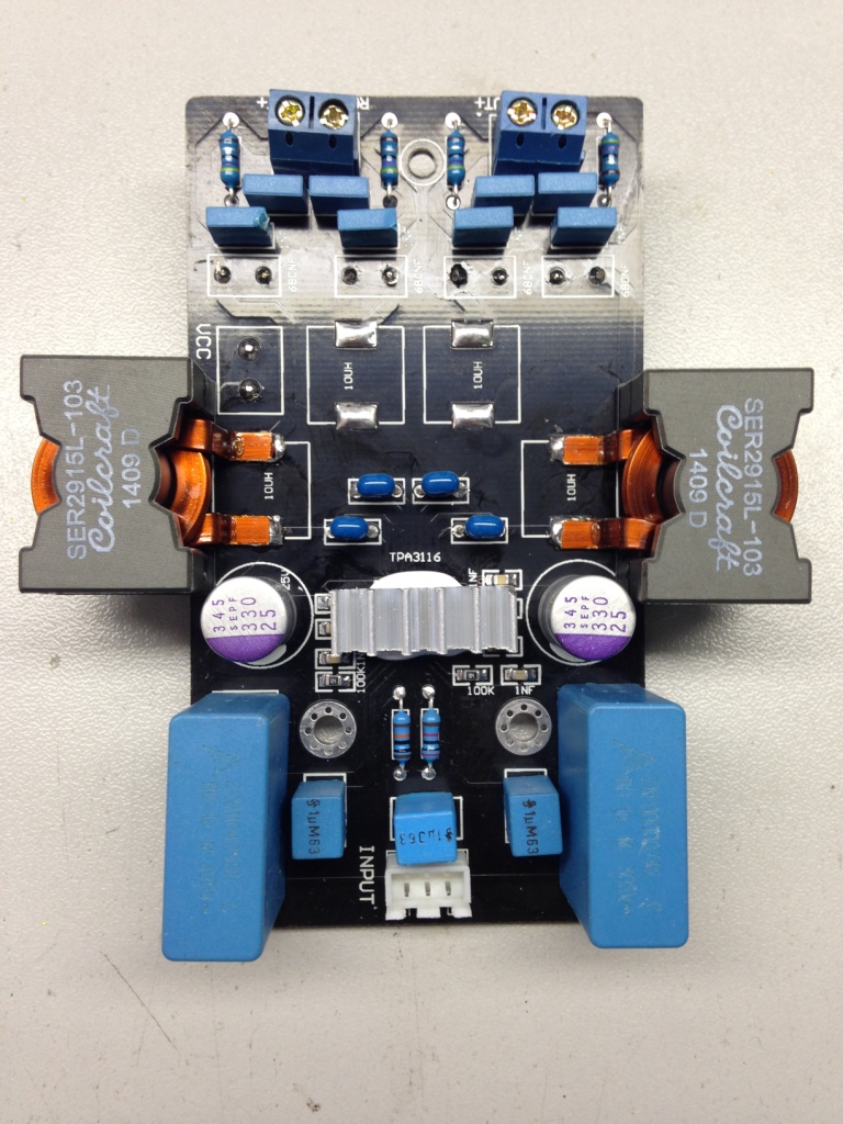

I decided to remove the stock inductors and install the Coilcraft SER2915L shielded inductors that wushuliu had posted about. These are chunky inductors, so I moved the terminal block for the power supply to the bottom of the board.
Using the gel flux paste I mentioned earlier, I applied a bit to each solder joint where the stock SMD inductors were soldered to the pads. They came off quite easily and after a cleanup with some Isopropyl Alcohol, the board was ready to accept the inductors. I also tinned the bottom surfaces of the inductor leads where they would be soldered to the pads.
Once I positioned the inductors onto the pads, I used my 40 watt soldering iron to reflow the solder. This took some time as the inductor coils also behaved like a heat sink, but my trusty Metcal iron worked well and I was able to add the two outer inductors first.
To put in the last two inductors, I had to bend the inductor leads a bit to install them at an angle. This arrangement worked out well as it gave me just enough space to fit my soldering iron into the area around the solder pads.
With some careful planning and patience, installing these inductors was pretty straight forward. The amp reminds me of the spaceship Alexei Leonov from the sci-fi movie "2010: Odyssey Two" (sequel to "2001: A Space Odyssey"), or some Minecraft character that my son invented.
Anyway, the amp sounds really nice. I still have to do some extensive listening, but it sounds very clear and transparent. To be honest, I cannot tell if these are better than the Bourns inductors that are similar to Matt's. I tried the Bourns before with another build, and felt they improved the amp's transparency. The Coilcraft inductors are at least equal to the Bourns as far as I can tell. Again, I'll need to do some listening.
