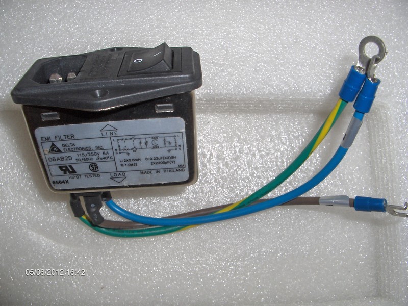

Don't know how and will this power port with filter have any impact on this POP issue once I start to build my set-up, but its here to be used anyway.

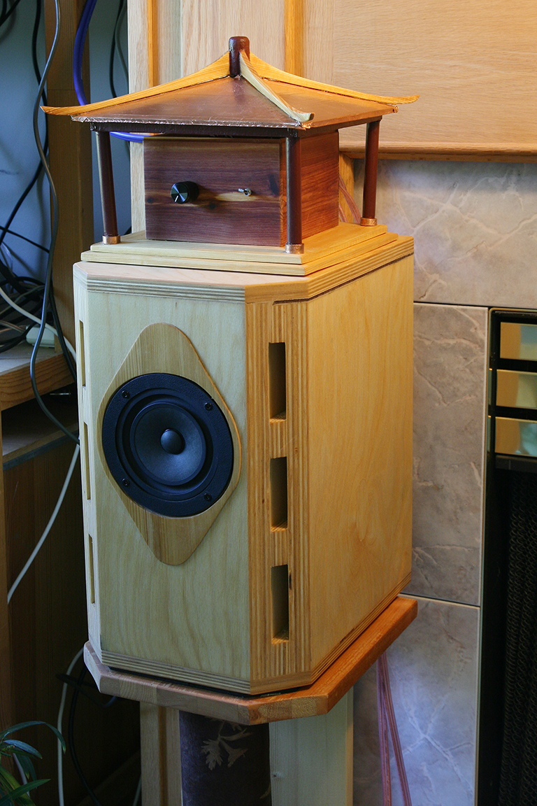

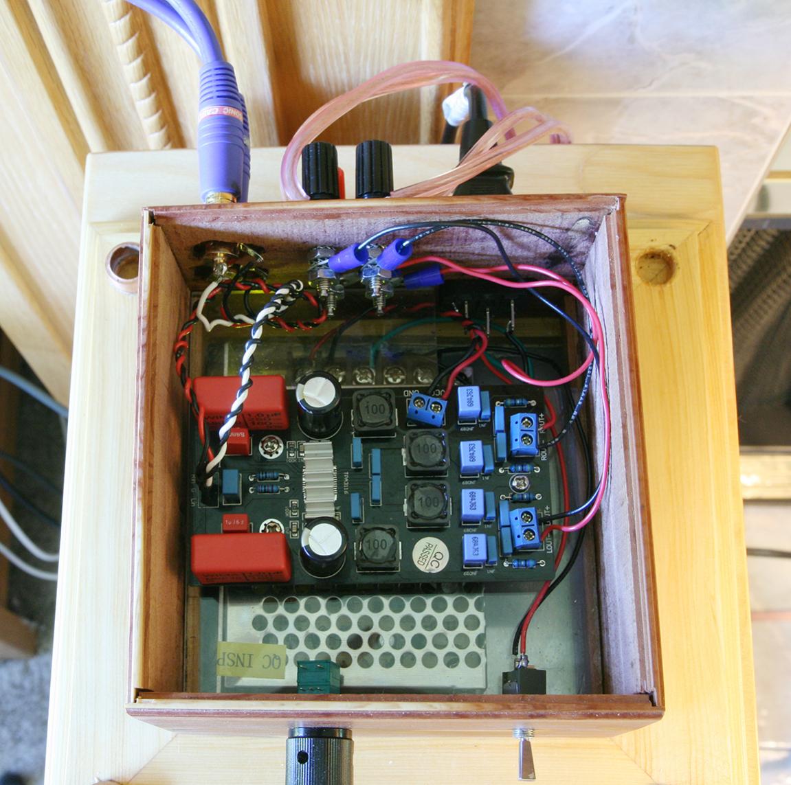

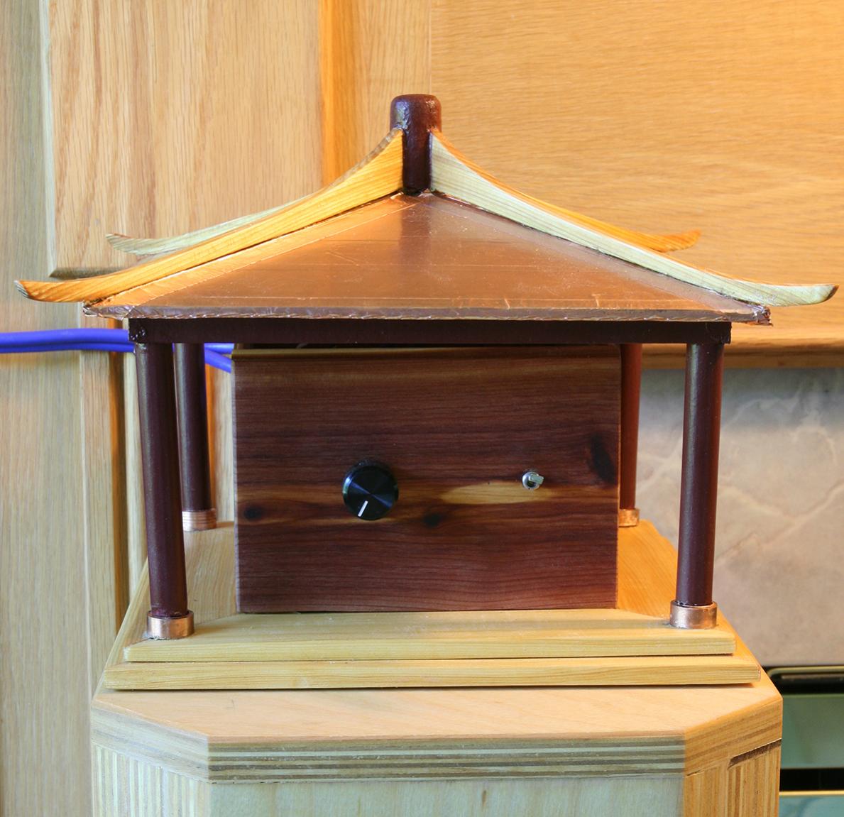

Here are a few photos of my latest 3116. I have changed the input and power caps as recommended earlier in this thread. There is a 24V SMPS turned down to 22V under the amp. The amp is mounted on a piece of 1/4" plexi above the PS. I haven't wired up a pot yet. The one in the picture is just there to hold the knob in place.
Right now I am using a Weilang DAC with my MacBook for a source. It sounds very good with my CHR70 miniOnkens. Much better than the LM1875 amp I was using. The 1875 didn't have enough power for these drivers.
Hope you like it 😀
Hope you like it 😀

Wonderfull enclosures indeed prezden! Cone looks like paper to me. Current generation drivers MA are 8ohm plus, older ones 4ohm. For 8ohm+ comparing amp specs it would be surprising, but currentlimiting is mentioned for protection in LM sheet and not very clear to me when and how you could hear that. I do know that even the tpa3110 has less trouble driving some speakers then much stronger specced sta510A amp (10watt vs 100watt)

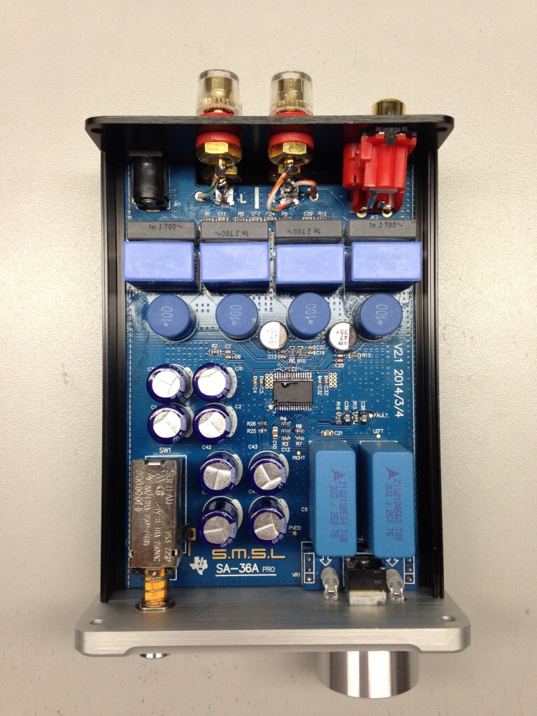

I had a little time yesterday to open up my SMSL SA-36A Pro TPA3118 amp, and snapped a photo of the innards.
I took an inventory of some of the items, especially the caps:
  • 2x 47uF/35V organic polymer cap, 8mm dia
  • 8x 470uF/25V Panasonic M electrolytic caps, 10mm dia
  • 4x Pilkor 680nF/450V MKP LC filter caps
  • 2x 3.3uF/250V Epcos MKT, 22.5mm LS
Aside from the mild turn-on thump and the louder turn-off pop, this amp has the potential to sound really good, and it is a potentially great value at $50. It is a very quiet amp and it sounds a lot smoother than the first time I used it.
I'll need to study the layout and figure how I can overcome the turn-off pop noise. I am open to any ideas.

The noise is present immediately after turning off the amplifier or a few seconds later?
In the second case, it may be useful to measure the voltage of the power supply, because I would suspect a problem during the transition below the minimum operating threshold (4.5V).
My 2 cents
If the noise is present immediately after turning off the amplifier, it is possible that power switch is sparking.
In such a case, I would try to disconnect the primary side of the power supply (leave the power switch ON, but unplug the amp from the wall) and if the noise has gone, a cap across the switch might help.
