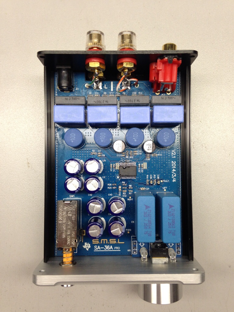

The noise is present immediately after turning off the amplifier or a few seconds later?
In the second case, it may be useful to measure the voltage of the power supply, because I would suspect a problem during the transition below the minimum operating threshold (4.5V).
My 2 cents
Thanks for the quick response Giancarlo. The power-off pop happens about 2-3 seconds after I push the power switch off on the front faceplate. I have measured the output of my Astron RS-12A regulated linear power supply to be 14VDC when powered on. It does have a large Kemet (Rifa) 21,000uF/63V electrolytic cap and a couple smaller electrolytic caps. One of the smaller caps is a Panasonic FM 2,200uF/25V cap along with a ceramic disc cap in parallel on the power supply's 14VDC output.
I use the same power supply to power my Sure Electronics TPA3110D2 amp and my Yuan Jing TPA3116D2 blue amp. I do not hear the loud, objectionable pop when powering off those amps off. Instead, hear a faint click on powering those amps off.
For me, the problem may be due to non-optimal placement of decoupling capacitors (8x 470uF/25V Panasonic).
These capacitors should be as close as possible to the chip, but they are instead very far away from the chip.
Maybe even the overall capacity is excessive.
On datasheet the decoupling capacitors are only 2x220uF.
It is not an easy problem to solve.
Maybe you could start to remove the capacitors further away from the chip, but before you do anything, wait for other opinions.

I had a little time yesterday to open up my SMSL SA-36A Pro TPA3118 amp, and snapped a photo of the innards.
I took an inventory of some of the items, especially the caps:
  • 2x 47uF/35V organic polymer cap, 8mm dia
  • 8x 470uF/25V Panasonic M electrolytic caps, 10mm dia
  • 4x Pilkor 680nF/450V MKP LC filter caps
  • 2x 3.3uF/250V Epcos MKT, 22.5mm LS
Aside from the mild turn-on thump and the louder turn-off pop, this amp has the potential to sound really good, and it is a potentially great value at $50. It is a very quiet amp and it sounds a lot smoother than the first time I used it.
I'll need to study the layout and figure how I can overcome the turn-off pop noise. I am open to any ideas.

...you can short the input, for fun short 1 channel, and switch off. is the pop the same both channels? the reduce you'll hear is discharge of inputcap, and considering how much noise the defective 1nF in output made on my boards, 3.3uF can be scary.
