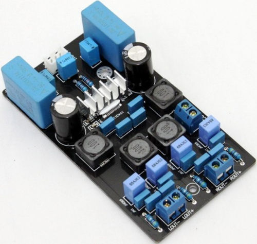

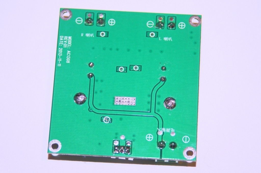

Yeee I looked at audiobah board again. If close decoupling of tpachip is important, I always wonder how audiobah board can be good. I think it is board with largest distance between tpachip and power decoupling ceramics.
(and power trace crossing under inputsignaltraces...also weird)
It doesn't. Atleast if compared to the YUANG JING boards.
Bellow is what I have measured :
Red YJ ( 81 * 69mm ) :
Audio inputs to TPA3116 inputs: 22 mm
Input of TPA3116 to input cap: 5 mm
TPA3116 output pin to bootstrap cap : 5 mm
TPA3116 PVCC to positive leg of supply decoupling cap : 18 mm
Black/Blue YJ ( 103*58mm ) :
Audio inputs to TPA3116 inputs: 27mm
Input of TPA3116 to input caps: 22mm
TPA3116 output pin to bootstrap cap : 10mm
TPA3116 PVCC to positive leg of supply decoupling cap : 17mm
Audiobah Green ( 65 * 69 mm ):
Audio inputs to TPA3116 inputs: 17mm
Input of TPA3116 to input caps: 5 mm
TPA3116 output pin to bootstrap cap : 5mm
TPA3116 PVCC to positive leg of supply decoupling cap : 11mm
Closeness of decoupling caps to the IC is important but probably not as important as whether the current loop formed by the IC+cap has any shared copper with an audio signal or analog power supply ground. This is called 'common ground impedance coupling' and its the enemy of SQ in my experience.
I'm in the process of removing caps which have their 0V into the ground fill on my board - just leaving ones I soldered myself onto the backside of the board. Thus is a 'suck it and see' approach as I can't examine where the decoupling currents are going within the fill without removing the IC from the board.
foto can deceive.
so not all are closer.
powertrace looks strange there, most take outputside if they cross?
(wiener has close decoupling, closer then audiobah I mean, but maybe grounds less separated?)
Is Audiobah same as Ybdz or 'Wiener' board?

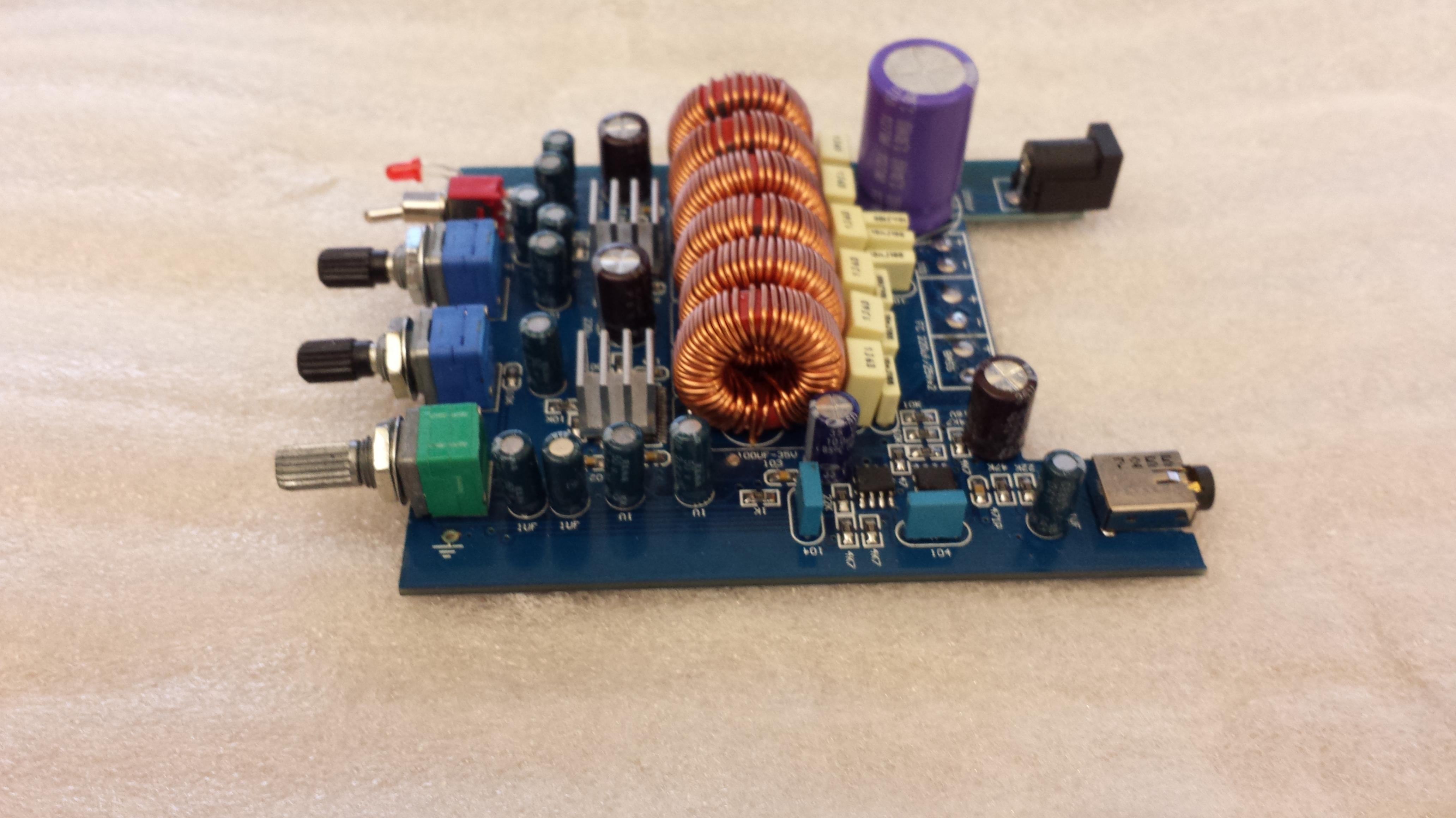

TPA-3116 D2 ebay Purchase

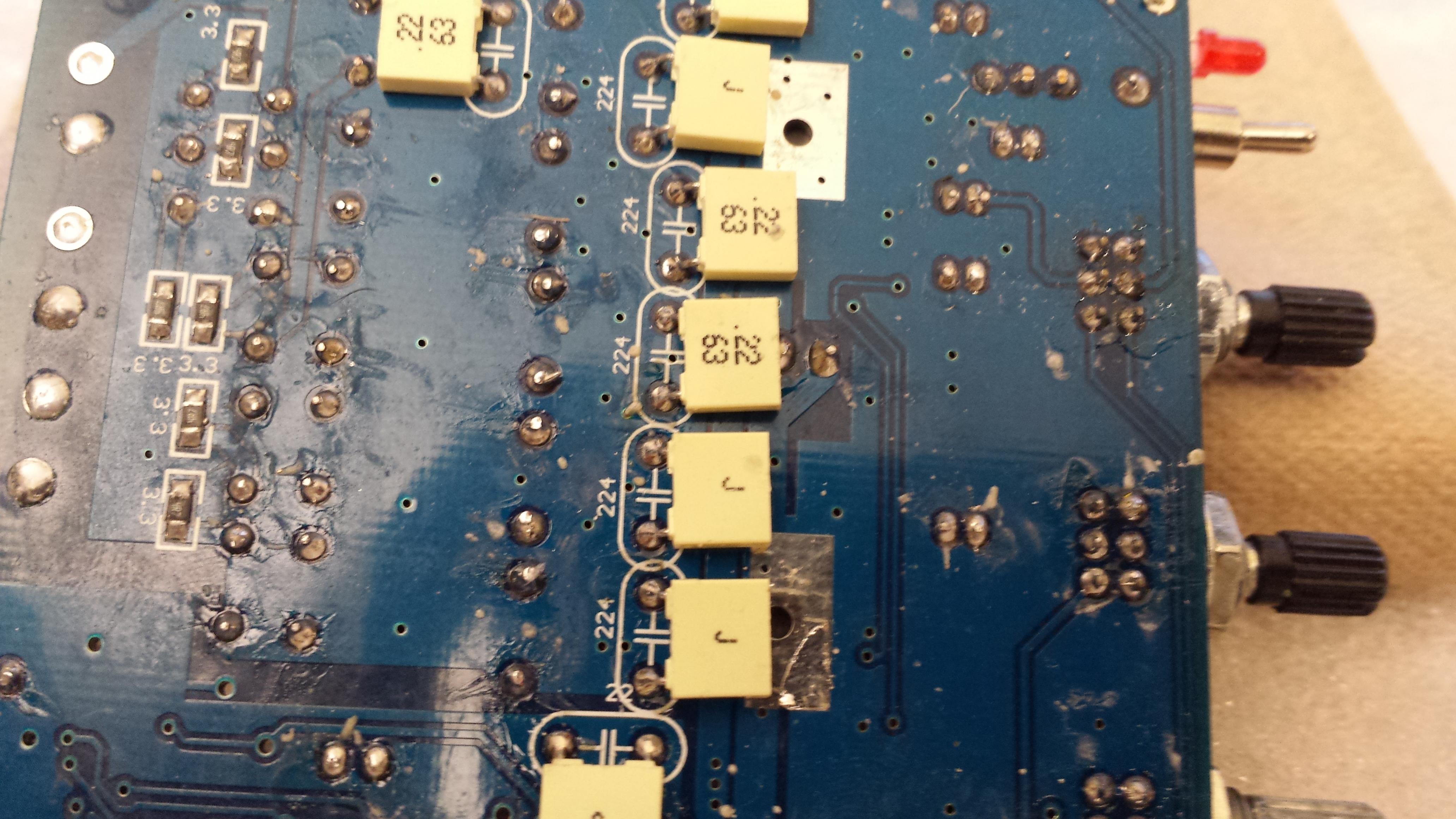

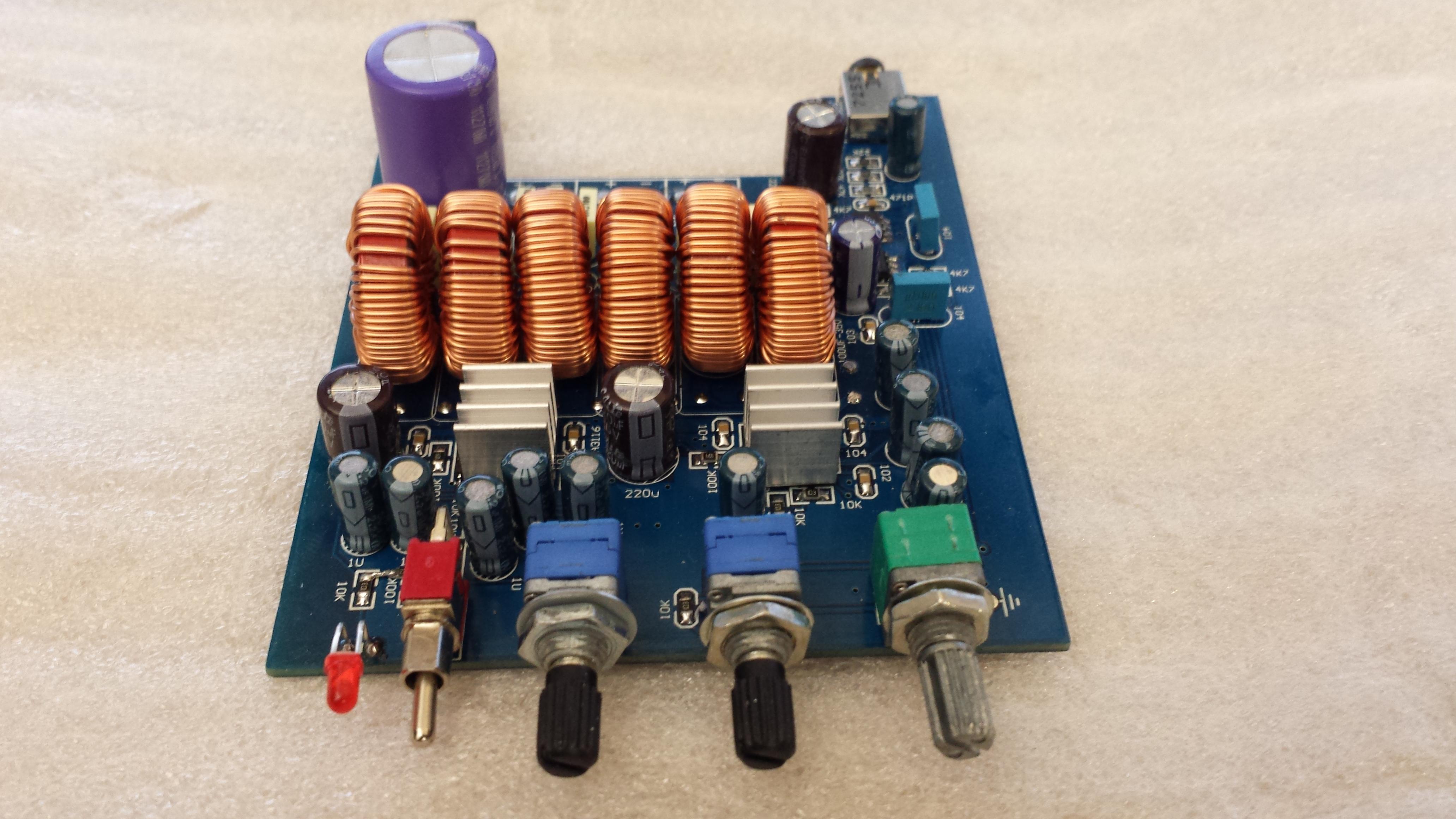

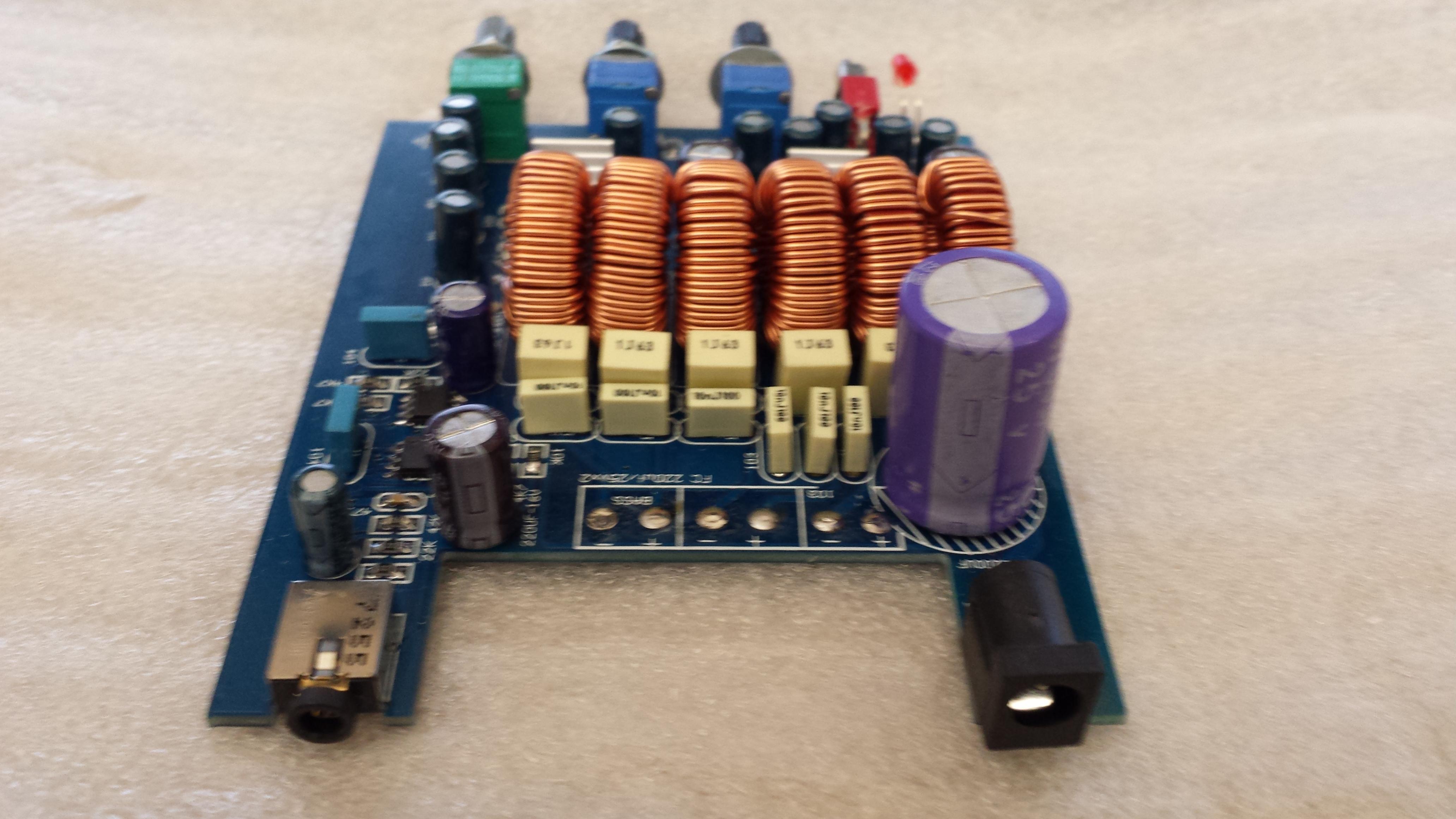

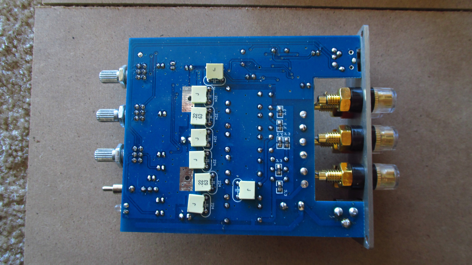

Bought this TPA-3116 D2 2.1 amp on ebay, for my DIY PC speaker system. What are your thoughts?
Looks like a right hatchet job to me. I've rarely seen such poor quality soldering on a commercially sold board and they didn't clean up the flux residue. Why the reverse side mounted caps I wonder?
like they decided to use inductors a little larger then planned originally, some elco's top also look as if vent already was used, or is it dust?
😀edit: it also looks familiar, like a board I modded and forgot to clean😀
Yeah I know how bad soldering looks because its so familiar under my own magnifying viewer 😀 Would never put one of my hand-soldered boards on eBay though....
Wow! Thats a mess, i hope it performs better than the finish on the board.
Yikes! That's a real mess. The board that ended up in my buddy's Breeze amp was in much better shape.
Aside from the poor soldering, how does the unit sound? I was actually eyeing one of these since they are about $20 cheaper than getting the finished Breeze 2.1.
I haven't been impressed with the Breeze 2.1 finished unit vs the YJ blue/black 2.0.
pots seem cheap, led ain't right--it's on any time unit is plugged in, big time spark from back panel when you plug in laptop brick, not very loud, etc.
Only thing I liked is that it will drive a sub.
agreed - could be poor PCB layout didn't accommodate for physical size of components on main side?
that said, it could still sound just fine
Certainly it could sound perfectly OK even when looking like a dog's dinner. Most of my own creations are just like that 😀

Everyone who commented pretty much confirmed my thoughts exactly. Needless to say, I have no idea what it sounds like, because I only plugged it in and powered it up briefly to verify that nothing goes BOOM ! I'm a little scared to leave it on for any length of time. I contacted the seller, and expressed my displeasure with the product and forwarded lots of pictures. I told them that the workmanship was poor (as if they didn't already know) and requested a refund. The funny this is, the seller sold all of them. I guess the saying ' You get what you pay for " holds alot of water..hahah.. lesson learned.🙄
