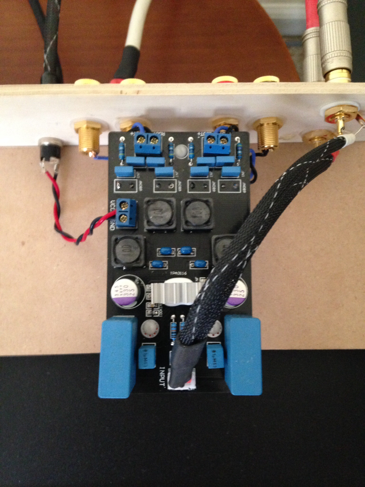

With my Audio Research LS7 tube line stage preamp connected to my modified Yuan Jing 2.0 blue amp, I can only turn the volume to the 8 o'clock position before it gets too loud in my man cave. The starting position is only 7 o'clock, so I can't even imagine what turning the gain up from 26dB to 32dB or 36dB would do. It would be analogous to my mom's 1971 Chevelle with the Chevrolet 350 V8 that used to idle at 25mph--overkill in my mind.

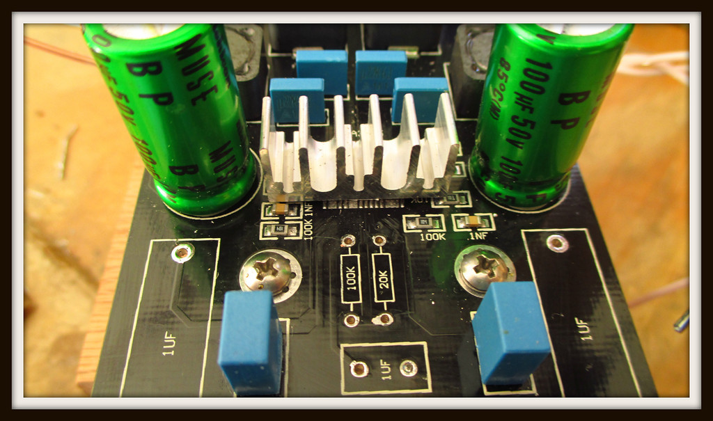

On another note, I got another YJ 2.0 blue amp, and installed the following:
- 4x TDK X7R 220nF/250V ceramic caps in bootstrap positions
- 2x Panasonic OSCON SEPF 330uF/25V organic semiconductor caps in power decoupling positions
I moved the 0.68uF film caps on the output filter to the bottom-side of the amp board to make space for the bulky Coilcraft 10uH shielded inductors on top, which I will install at some later time. I'm trying to make a change at a time to gauge what modifications make a difference with this amp.
Thanks again to Danzz for his design to accommodate thru-hole components. This is a modder's delight.
So compared to my near stock amp (replaced stock Nichicon PW 1000uF/25V) with Panasonic FM 470uF/35V caps on power supply decoupling positions, this amp sounds cleaner and "more fluid." The bass is tighter and better defined, but not necessarily deeper or lighter. Percussion instruments have more clearly defined impact. Overall, the sound has more presence and air. I really like the change for the better.
What is better for the power decoupling cap? Lower then the original 1000uF or higher say 3300uf ? I have 2 Pana FK 4700uf 25V and 2 dubilier 2200uf 35V ?
I would pick the one with the lowest ESR and/or highest ripple current.

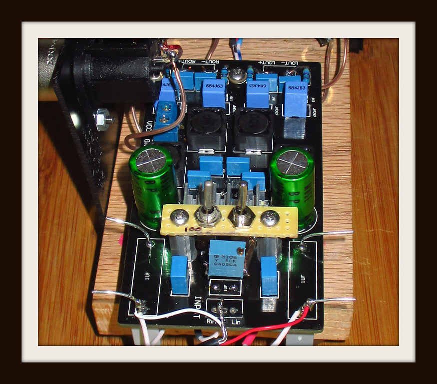

While waiting for my new inductors and Jupiter input caps to arrive, I set up my TPA3116 for switchable gain (20dB, 26dB & 32db) and for testing different values of input coupling caps (from .5uF to 10uF).
My first impression is that I prefer the lowest gain setting (20dB) with somewhere between 1.5uF - 3uF input coupling caps, but will spend some more time listening this weekend and revisit it all after the inductors arrive.
It just goes to show you how system dependent different speakers, equipment and component parts can be.
I’m sharing Rhing’s preference for smaller decoupling caps close to the chip and am now experimenting with some arrays of multiple caps off the power supply like abraxalito suggests. I’m still using the second adjustable linear regulated supply that I built last month (set at 23V) and enjoying how it's all sounding.
- Class D
- TPA3116D2 Amp
