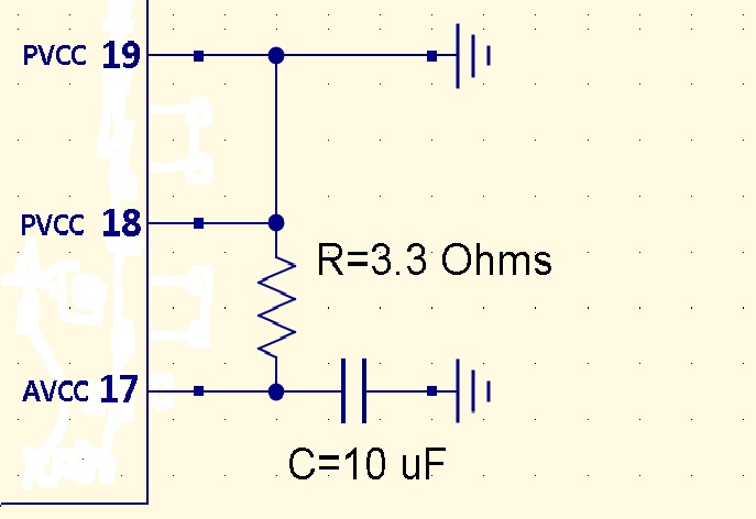

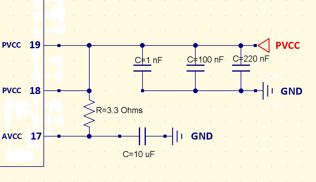

Significant improvements from separating out pin17 (analog +ve supply) from its two near neighbours which are the output stage supply. My first tweak is 3.3ohms in series and 10uF 1206 to the plane. This has brought the soundstage alive and almost killed the sibilance on voice, very worthwhile mod.

Just to get things clear, PIN 17 to resistor in series and then cap to ground like in the attached schematic ?
Cap to ground is from pin17, resistor (currently 3.3ohms, subject to further listening) is between pin18 and pin17. Thus its filtering the output stage supply to remove HF put there by the output switching transitions.
@irribeo - yes where 'Vin' is PVCC and 'Vout' is AVCC.
Thanks, I think I got it.
abraxalito and irribeo

Incidentally the connection to pin 18/19 isn't to earth as your schematic shows, its to the positive supply.
It might be - do you have a part/value to suggest? It would probably need a resistor in addition in parallel, for damping.
No the TPA3116 is my first foray into switching amps from a DIY point of view. I had a Tripath amp inside my PC going back over 12 years now and I liked the sound.

Dang, I swear I was doing it wrong for the third time now. Could not find the appropriate symbol, got distracted and voila. GND
