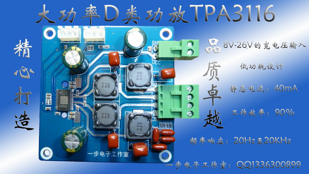

I just got two blue boards (43rmb from Taobao) delivered.
First thing I did was remove the stock (22uH) inductors and measure them. DCR is respectable, around 40mohms but at 100kHz (the high frequency limit of my LCR meter) this has gone up to 0.48ohms. Unacceptably high in my book especially as it'll be higher still at the switching freq. So I'll experiment with alternative output inductors.
Second point is there's a single ground fill used for the 0V connections, this I'll hack into to get some semblance of star earthing for the audio feed. Its rather fiddly as isolating the input ground means desoldering the input connector to break the thermal reliefs on the top side. Ground fills like this are a problem for audio quality because the ground currents get all mixed up and with a switcher there are some fairly heavy currents flowing - we don't want any impedances shared between power and signal grounds.

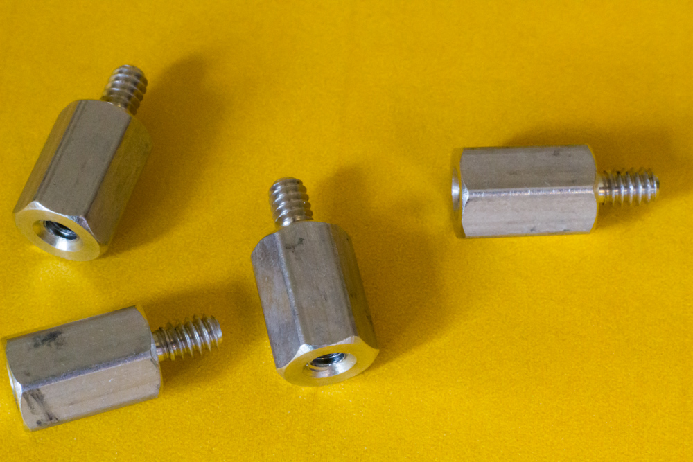

Good news, I got the Taobao TPA3116 2.0 installed into an hdd enclosure plate that I had lying around for the time being using rubber feet as the standoffs and hot glue gun for mounting.

This blueboard you mean?
Yep, that be the one 🙂 The audio input connector is at top left but its gnd pin goes directly to the plane. If you read the DS you'll see they recommend that for SE (single ended) inputs the -ve input pin should go to the gnd wire of the source as closely as possible. Whilst I haven't examined the layout in detail yet it does look as though this recommendation's been ignored, instead the groundfill local to the IC has been used as the -ve input reference.

I didn't have those at my disposal and I couldnt wait any longer 😀😀
Plus with hot glue gun, I can always peel it away if I ever need to remove anything. So its just as versatile. 😛

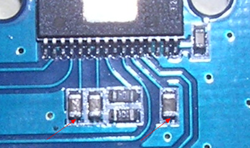

Audio input grounding mods
As I suspected, on closer examination of the inputs to the TPA3116, the ground fill locally to the chip has been used as the -ve audio reference point, meaning noise is coupled in by virtue of the fill doing more than one grounding function. Rather than hack the PCB I shall lift the two caps' 0V connections (arrowed) and give them a dedicated ground back to the connector ground pin.

Significant improvements from separating out pin17 (analog +ve supply) from its two near neighbours which are the output stage supply. My first tweak is 3.3ohms in series and 10uF 1206 to the plane. This has brought the soundstage alive and almost killed the sibilance on voice, very worthwhile mod. I rather suspect that HF ripple from the output stage easily floods the analog stage LDO reg (see DS p4 for internal diagram) so this passive filter's giving the signal processing stages a cleaner supply. I'm also bypassing the power connector to the board and feeding the ground in directly to the hexacap, meaning the switching currents aren't flowing across the groundfill now. Next up - move the grounding of the output filter caps off the fill....
<edit> Now have 470uF in parallel with the original 10uF ceramic, more delicacy of sound. Clearly this supply rail is a promising vein to mine....😛
