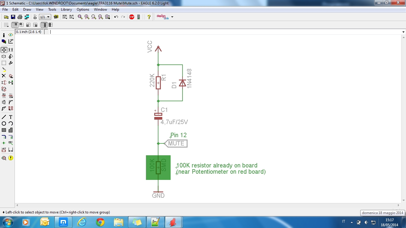

I've attached the schematic of a antibump circuit that I successfully tested on red board.
I'm pretty sure that it works fine for blue board too.
It takes only three components:
1 Resistor 220K
1 diode 1n4148
1 capacitor 4.7uF/25V
Only two connections are needed between circuit and board:
A wire to positive of power supply (+Vcc)
A wire to a 100K smd resistor (already on board), that is connected to pin 12 (mute) of the TPA3116.

On power down the mute pin will get pushed to -Vcc.
Hope it survives.
I would have put the diode across the mute input to GND...protecting it from -Vcc. (and used a 1A diode)
Even then: Max input to MUTE is -0.3V (data sheet) and only needs to go to 2V to activate.
Hope it survives.
There is already a protection diode internally in TPA3116.
I've already measured voltage on pin 12 and during discharge voltage is only -0,5V..-0.6V.
You can measure that diode with a multimeter.

My TPA3116 is ok. I've not burned it, and I've done a lot of poweroff cicle.
In any case it is possible to add another diode between pin 12 and gnd (anode to Gnd).
Dug you are right!
Thank you to have pointed out that maximum negative voltage on pin 12 is only -0.3V.
There is already a protection diode internally in TPA3116, but obviously is a silicon diode that have a 0.6V forward voltage.
I will add a protective schottky diode (or germanium diode) that have a lower forward voltage.

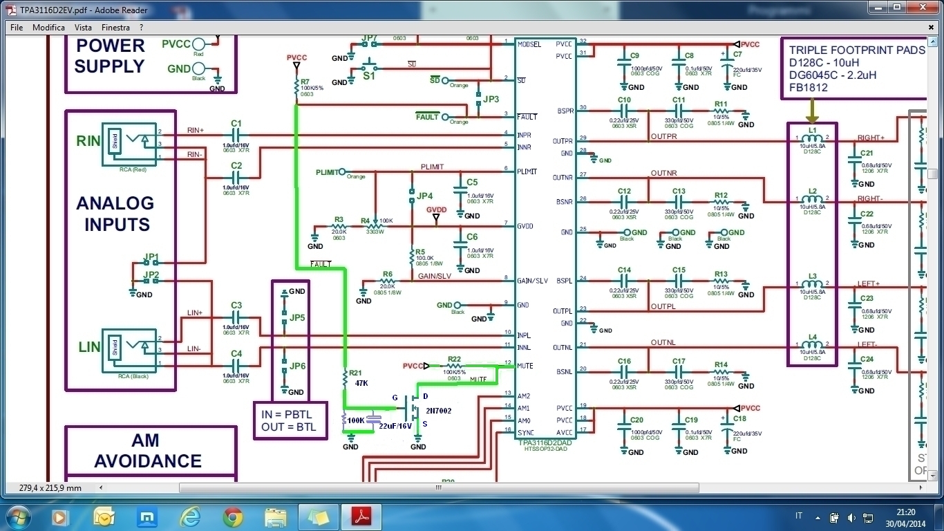

I've have attached another antibump schematic with a mosfet.
In this case there will be not problem at all on mute pin, but I've not tested yet this circuit.
What do you think?
Thank you
I am unable to find (in the data sheet) any reference to protection diodes on the MUTE input.
It may be just a coincidence that it measures as a diode and will clamp at " -0,5V..-0.6V. ".
I don't dispute your results.
On other devices when there is a protection diode clamp on an input there is usually a maximum current rating that applies to the clamping diode.
Did not find that either.
Just saying that I would limit current if reverse potential is applied to MUTE or other inputs.
Good luck.
