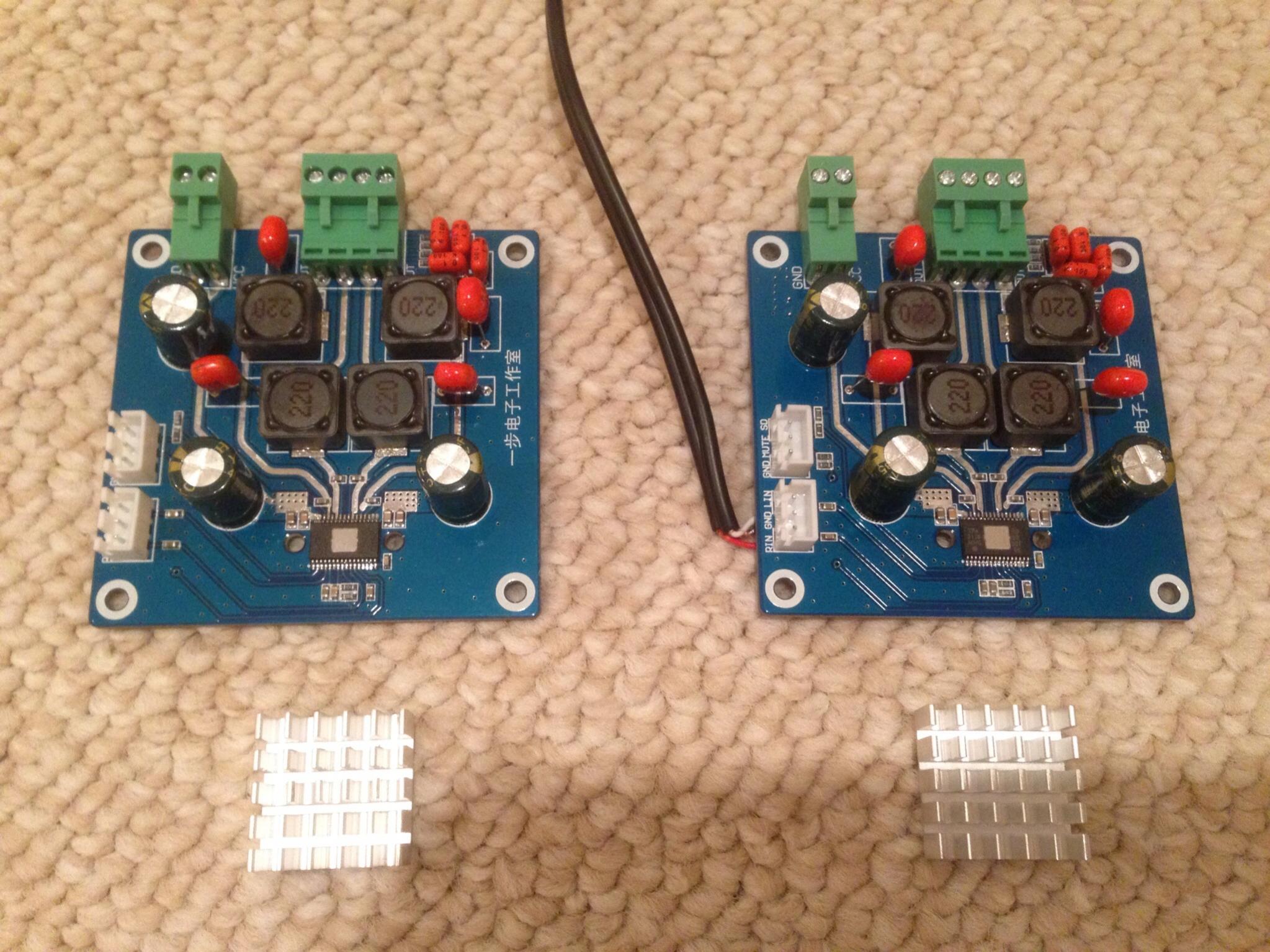

I finally got my two amps from Aliexpress after 8 weeks. It was a good price but that was too long. Hooked one of them up to my new dual chamber reflex speakers. They sound really good. Just what you expect - great bass and very clear highs and transparency. These will be part of my miniDSP bi-amp in a box setup. I like the screw terminal connectors for the speaker out and vcc in.
I got to listen to these some more and think that they are excellent sounding - just as good as the homebuilt unit that I have made from Dug's PCB. For $13.50 each - it is a steal but be wary of 2 month delivery. The cool thing about these screw terminals is that the wires once screwed in can be removed as a plug from the board and plugged into another board without having to loosen the screws. Great for swapping the board quickly or for easy assembly into a larger box. The build quality seems very good with sturdy PCB with a solid ground plane on bottom side for low noise.
The bass extension is excellent and it doesn't get warm. There is also hardly any pop when turned on if the inputs are plugged into a source.
I can highly recommend the Ybdz 2.0 board.

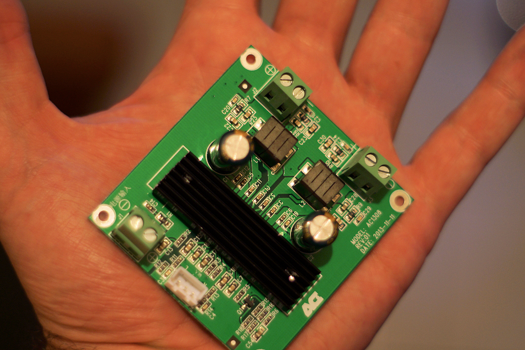

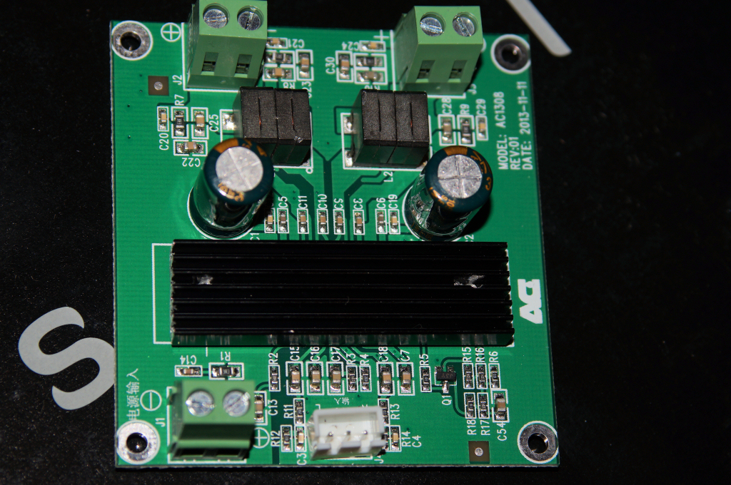

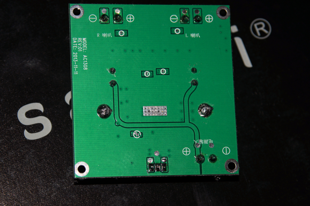

Alright, I have received my green audiobah board
You know when you have big expectations on something and then when the product arrives your expectations are not meet ?
Not the case here . The board is well assembled on a high quality pcb.
Bad news for modders that don't own a L/C meter is that there are no big or fancy capacitors introducing parasitic inductance and pretty much everything is SMD. The good news for the rest of us is that this board is 100% turn on / off pop noise free , the hiss is much lower in level than the red yuangjing board the sound is overall better and you can also get on 1x100W mono by just soldering bridges.
Now, I am really enjoying the song coming from the tpa3116 as everything is there and sounds just right.
As a modder with an L/C meter I still see 2 large capacitors introducing parasitic inductance 😉 I would not know what having an L/C meter has to do with ready made designs ?! It would be good news to have the L/C meter ? You are right about that 🙂
True, SMD is fine at most spots but does that also count for the input caps and for the output filter ? Did you also try the YJ blue board ?
