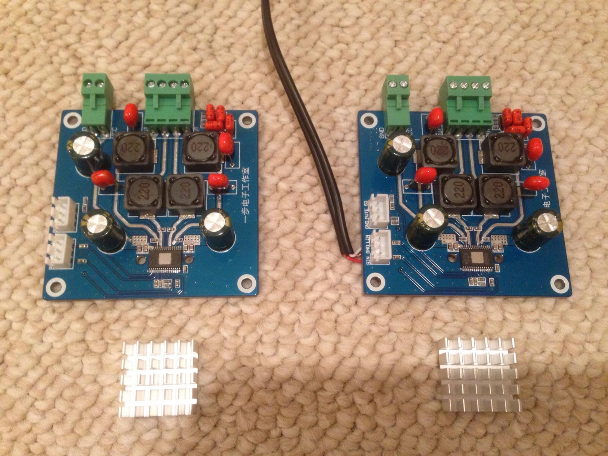

So I finally got my two blue 2.0 ChengZhi boards in on Friday after about 6 weeks time. I spent the weekend putting them in aluminum cases (first time casing an amp board). Any suggested improvements are welcome.
I will be using them to actively power my monitors, one for the left and one for the right. I built the monitors some time ago but ran out of cash for amps (spent all my money on the best speakers and dsp I could afford). These 3116 amps are such a good price! They will be mounted to the back of the speaker enclosures close to the speakers. The signal and power cables will run up inside the speaker stands to feed the amps.
After I get to listen to these for a bit, I would like to try bypassing the LC filters and use ferrite beads as suggested in this thread. I'm not entirely sure how to accomplish this. Any suggestions are appreciated. I would also like to try larger caps if I can fit them.
Even though this thread is cluttered, there is still a lot of helpful info. Thanks to those who post useful information!
Hi it would have been better to route the output cabling at one side of the case to the speaker connectors. Output cabling should be far away from input wiring/circuitry.

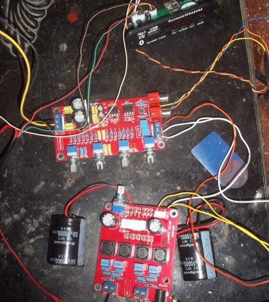

I put 2 10000uf Rubycon caps in parallel with two 1000uf caps. Now it sounds amazing. I think 10000uf is not required for this amp but I can't find good quality higher capacity caps here so I will use them. Will it burn the chip or is there any side effect of that? Please advice.
Thanks!

I don't think I have ever burned out a laptop SMPS ever - and I have had a lot over the years. They probably have built in self protection. I don't see any issue with using extra large power supply caps in the 10000 uF range - I would not worry about it.
I don't think they will burn out. But someone told me that the power supply's over current protection will kick in when too much capacity is added. Those large caps require a very high charge current.
If this happens, the amp won't power up.
But i have never tested this myself.
