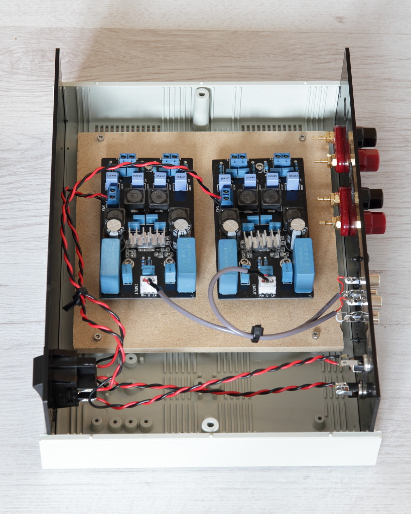

Hi, just a quick pic to show my nearly complete twin YJ 2.0 blue boards... waiting on a second pair of terminal posts & speaker wire to arrive.
In this situation using SYNC would be recommended? Currently on each board the SYNC pin [#16] has a 10K R > 1uF > GND... To connect the boards I would need to run a wire from between 10K R & 1uF on the Master board, then connect the wire before the 10K R on the slave board? Also, on the Slave board, best to replace the 10K R with a 0 Ohm jumper?
Also thinking of setting the gain to 20dB, so will need one 5.6K R and two 51K R for the Master/Slave voltage dividers. On the Master board, I remove the 100K R and leave the R2 open...
Thanks in advance.
Paul

The set up looks good! I am doing the same thing. You are running the boards in stereo mode, I presume?
I ordered two of the green boards (the "Audiobah" ones) from China and I plan to set them up in PBTL (mono) mode using one 24 V swtiching PS. I am not sure whether I need to syn the two boards under the circumstances. I will try it out and see if there are problems.
Yes, they're running in stereo, these are to be used for a 2-way OB project... Thought about using two in PBTL mode for a pair Eminence Alpha 15A, but only require mid / low SPL. ~32Watt will be plenty. I do like the idea of using these to create active speakers, mounting them directly to the back of the OB 🙂

If you don't have bass, you're probably running just the coupling caps. Put another 10kuf+ at the VCC (DC power in) input.
The amp won't be impressive without it.
