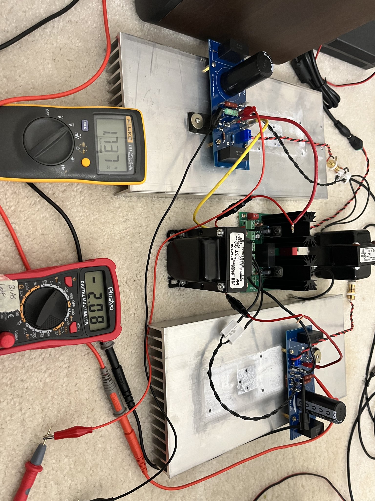

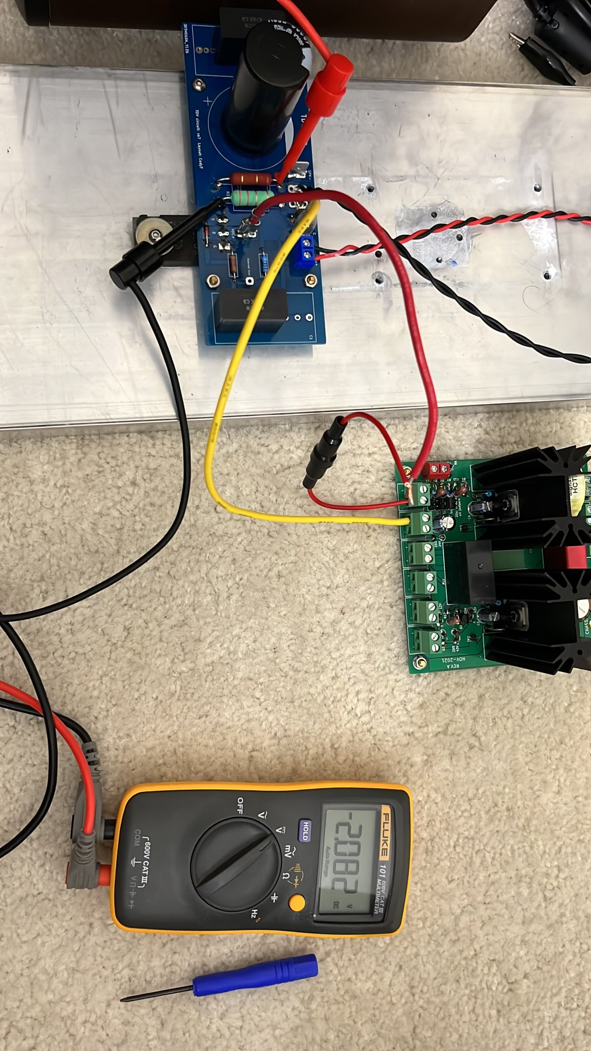

I was missing the 18v zener Z1 per the CodyT/ra7 schematic on this amp so got that delivered today and was able to power up the amp.what??!!
Thanks Eric for all your help. I replaced one of the 2.2R with 3.3R and now I get 2.095vdc voltage drop with the total resistance of 1.3R so very close to 1.6A bias and yes my klipsch too are rated 8ohm and 97-99db sensitivity 👍With 1.75A bias your output power into 8 ohm will be 12W.
What I had told you is that my goal was to have a 10W amp into 8 ohm therefore my requirement was a 1.6A bias
If you want 1.6A simply increase both your 2.2 ohm resistors
Glad it’s working 👍
I did hear the music too 🙂

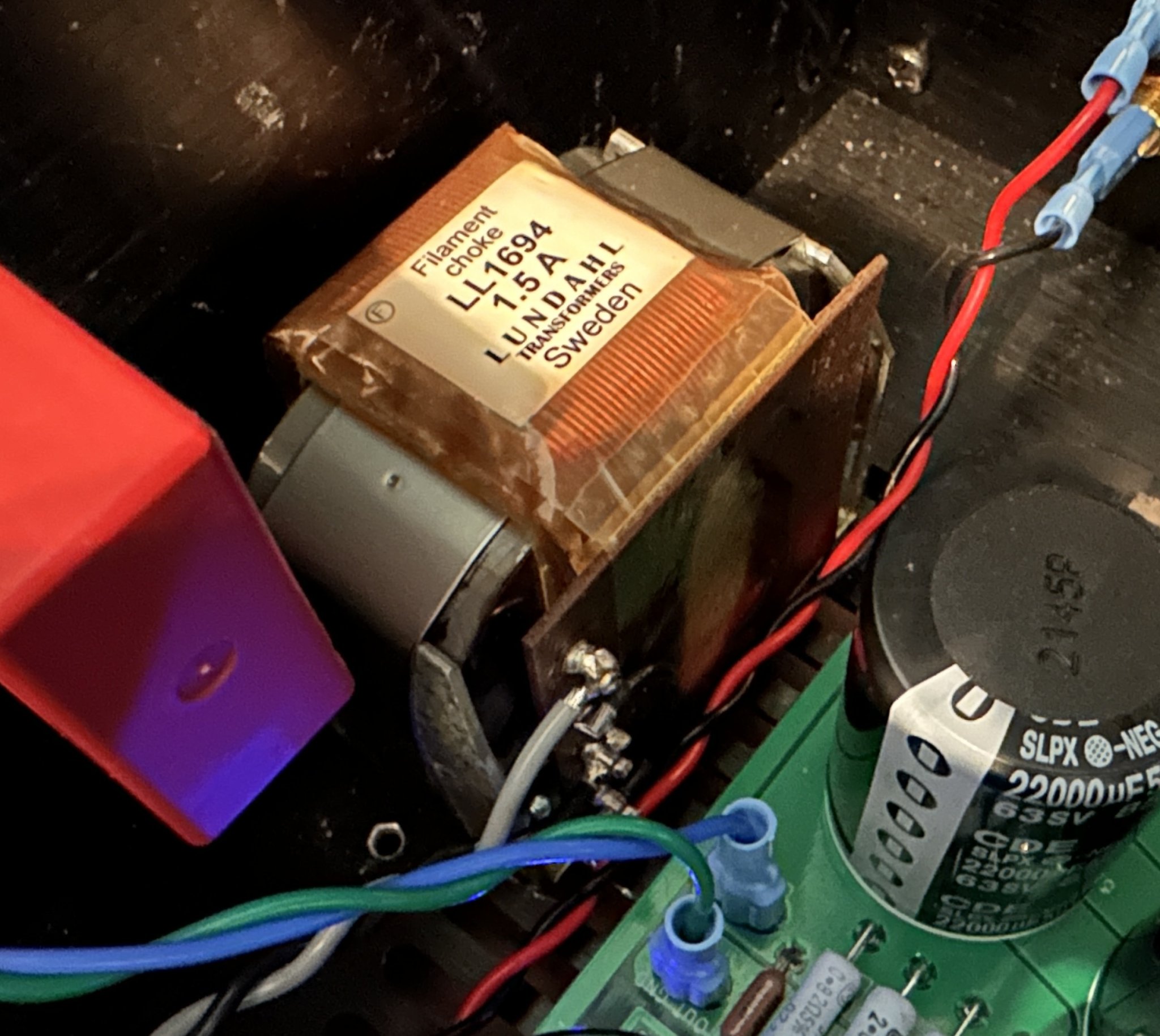

I decided to fiddle with my TDV and swapped in a pair of Lundahl LL1694 for my Hammond 159ZC, raising inductance from 60mH to 160mH. Another neat thing about the swap is that I was able to drop my bias resistors and rely exclusively on the DCR of the Lundahl’s (1.8R). The extra inductance has filled in the bottom end nicely and tightened things up a bit. A nice improvement overall.
I wouldn’t recommend using the Lundahl’s unless you already know the amount of resistance you’re after for your specific devices and can work with the 1.8 DCR these specific chokes offer. I’m lucking enough to have a somewhat matched pair of 2087’s, which made things a bit easier.

Nice! With just a choke, it makes life easier and also provides a low output impedance.

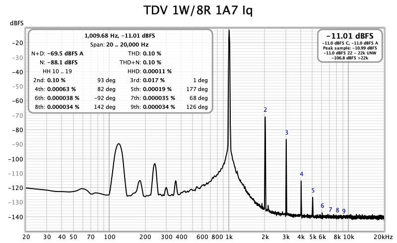

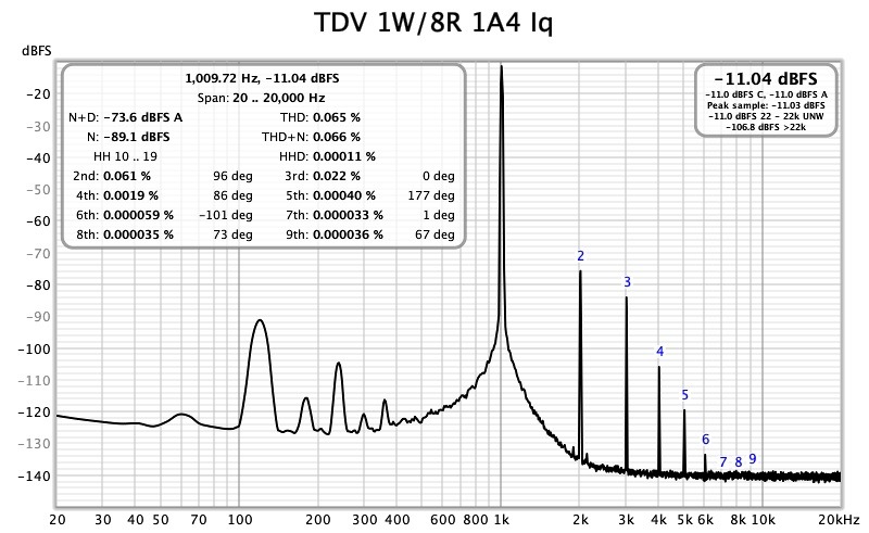

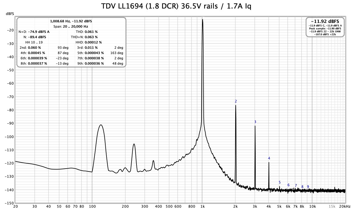

I've done a bit more tweaking and have settled on some preferred operating points (for my specific devices). With the 159ZC's I was using rails around 26v and 1A4 Iq and I really liked that combo. With the LL1694's, I settled on a 28v transformer, getting my rails to 36-37v and a final Iq around 1A7. This lands me at roughly the same THD and spectra as the previous operating point, but the additional mH's and power have really transformed the bottom end. It's the same palpable bass and midrange, but with some serious grunt and control. I'd call it my absolute favorite in terms of the LF sound and definitely near/at the top for HF and overall sound. Granted, its not apples to apples, this being a follower and driven by a tube pre (whereas most of my other amps are common source.)

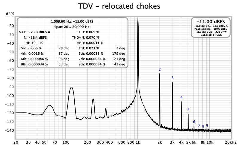

All in all, a successful experiment. At some point I'll have to tackle the PSU harmonics. I imagine there's not much PSRR to speak of, so maybe a cap multiplier would help. Of course I can't say that I hear any of that noise, so fixing is not especially high on my list.

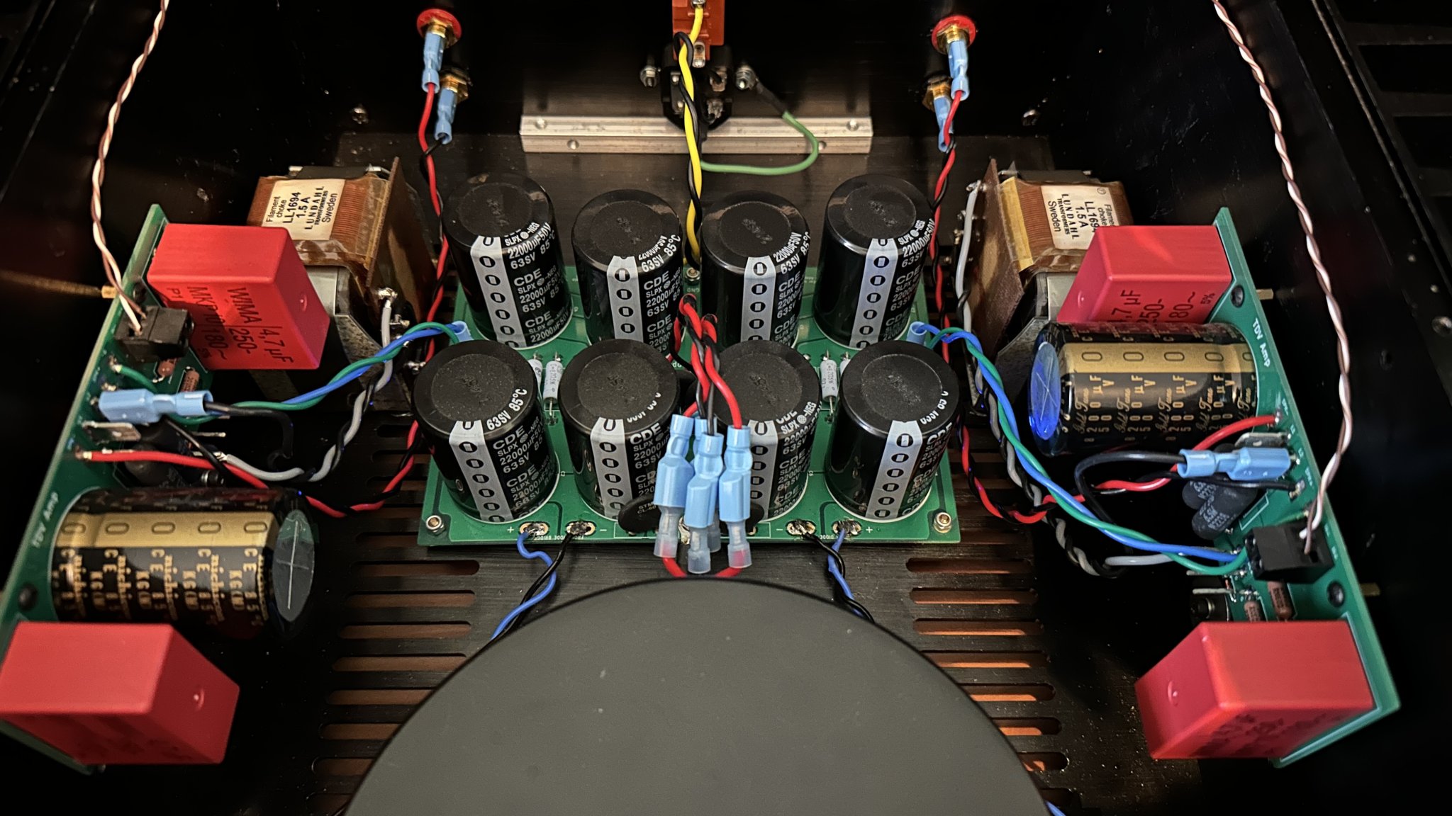

One way to lower the power supply ripple is to change the CRC filter to CLC. That is what I have in my amp.

Mine have the power supplies "flipped".

Thanks for the ideas regarding supply noise. I do have a pair of chokes I could try for CLC, but space is at a premium in this specific chassis. I'll start thinking about flipping the supply too.

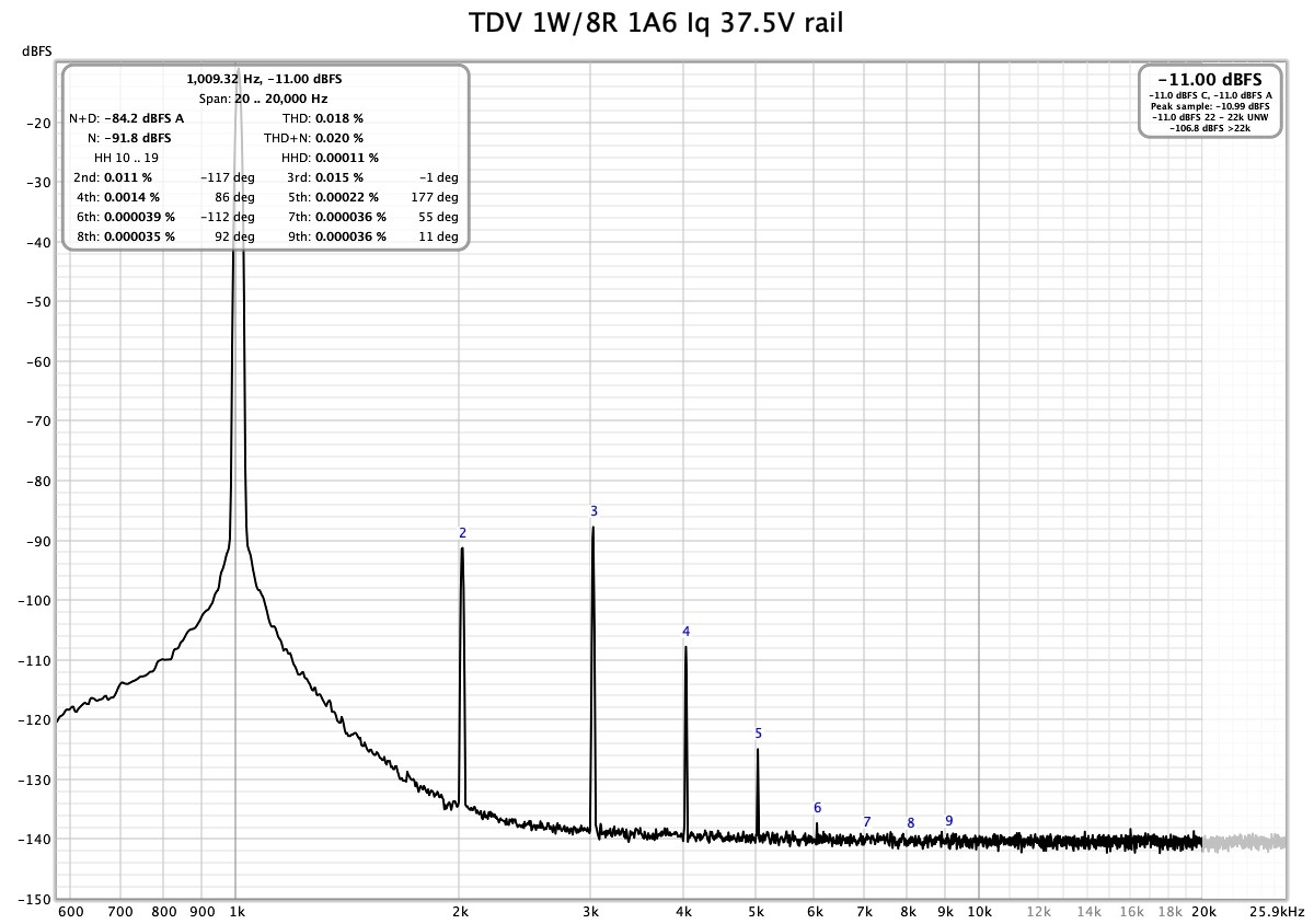

Hey Cody, what power level into what load is that spectrum snapshot? If it's 1 watt into 8 ohms, that's a great THD for this type circuit.

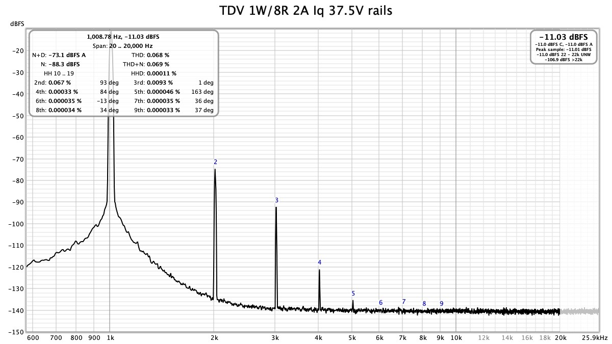

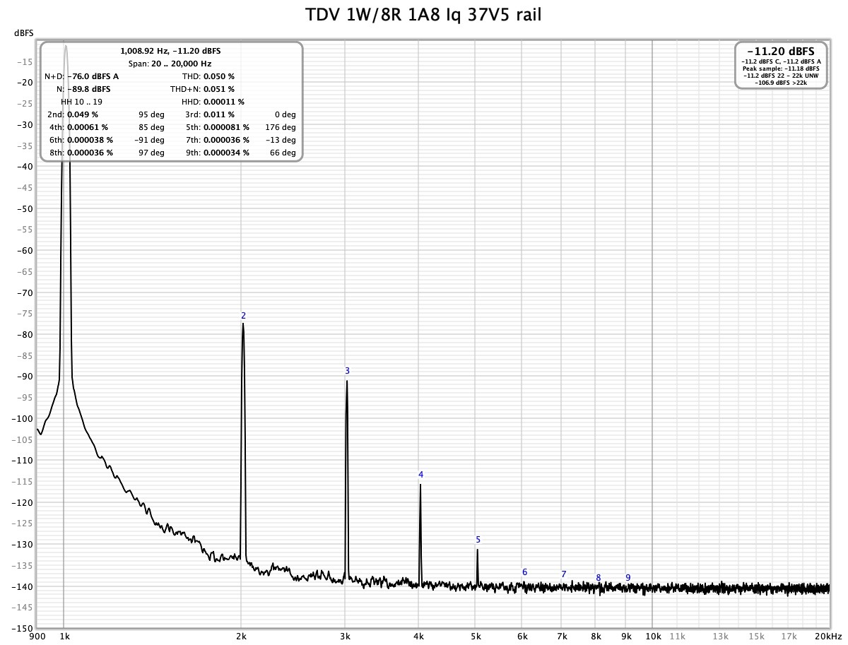

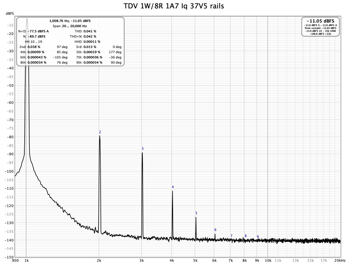

Thanks @Cinco! The spectrum is 1W into 8R. I've tried a number of different operating points and have seen as low as .018% and as high as .12%. This middle spot has been my preference, probably somewhat based on the 2nd to 3rd ratio. The distortion spectrum is nearly identical to what I'd settled on with the smaller Hammonds, but I much prefer this new configuration.
I'll have to take another look at the 193U's – those are nearly the same as the Lundahl, but with even more inductance and current rating. The main reason I chose the Lundahl was because they fit the designated spot in my chassis. I'm not necessarily convinced that the fancy nature of the lundahl's improved sound quality, but rather the simple increase in inductance and voltage. Who knows though.
Attaching all the distortion shots I've taken. All are with the Hammond except the last.
