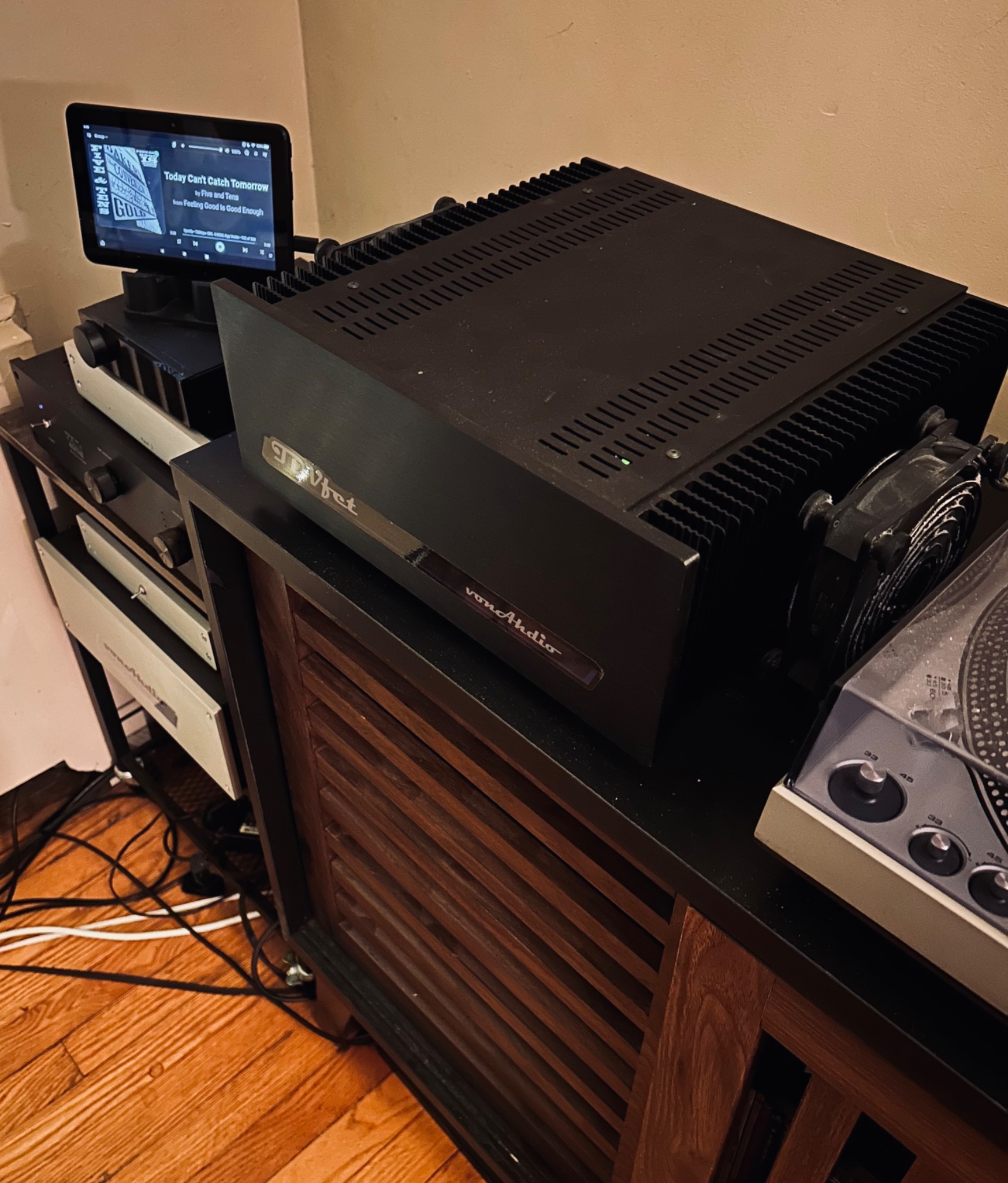

I’ve been cycling through a handful of my power amps in the recent weeks. My TDV stepped up to the plate today. I heard something new in a familiar song this evening. THAT is the sign of a good amp. :nod:

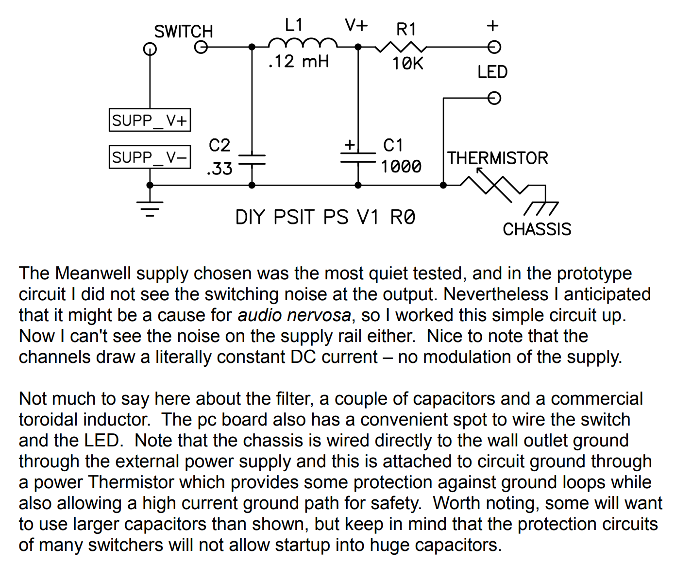

Yes, that’s how it is typically done with a linear supply. I am less certain about the Meanwell though it looks like it should work. You could try it and report back. I don’t have experience with the Meanwell supply. But others here do. @Ben Mah , have you tried this? I am wondering how the chassis can be connected to earth ground as well.
Congrats on your build! How does it sound?
I have never used a SMPS to power an amplifier.
Here is the specification sheet for the Meanwell:https://www.meanwell.com/webapp/product/search.aspx?prod=UHP-350(R)#1
Looking at it, it looks doable as long as V- is ground.
From a practical point of view, power supply output ground and audio ground are the same thing. An amplifier has a source such as preamp connected to it. Usually the preamp power supply/signal ground is connected to safety ground. The preamp's safety ground is therefore connected to the preamp out ground and then through the interconnect to the amplifier signal ground, which is connected to the power supply. So the amplifier ground is safety grounded through the preamp, and since the amplifier ground is also the power supply V-/ground, the power supply is also safety grounded. I hope my logic is correct. So a direct connection of the SMPS V- should work and from a safety point of view should be done rather than rely on a connection through interconnect to the preamp.
However I have not used a SMPS to power an amplifier and I am not an expert on this subject. The above are only my amateur diyer thoughts. So seek confirmation before proceeding.
