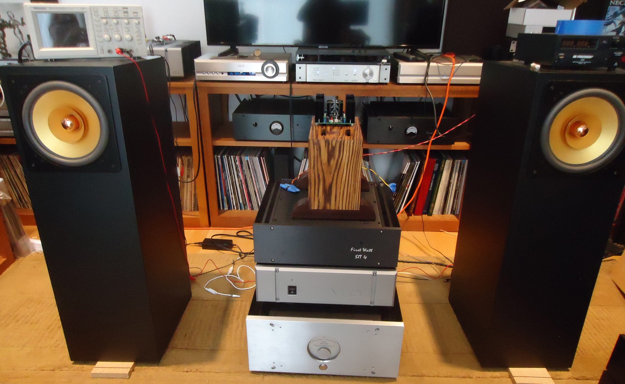

So, I got to hear a SIT-4, which is a Tokin amp in common source mode (i.e., it has voltage gain too). Absolutely glorious sound. I want to hear it in the TDV chassis. It should be relatively easy: just put the choke on the drain pin and apply a little feedback.
Ben has reported that he prefers his followers to CD mode VFET amps. For sure, the follower will have less distortion, but the SIT-4 has such a glorious sound that it will be worth the experiment.

Here is a photo of the stack we listened to. Bottom 2 are Tokin SIT prototypes, middle is SIT4 proto,So, I got to hear a SIT-4, which is a Tokin amp in common source mode (i.e., it has voltage gain too). Absolutely glorious sound.
above that is small version of Beast w/ 1K Jfets, top is ACAmini.

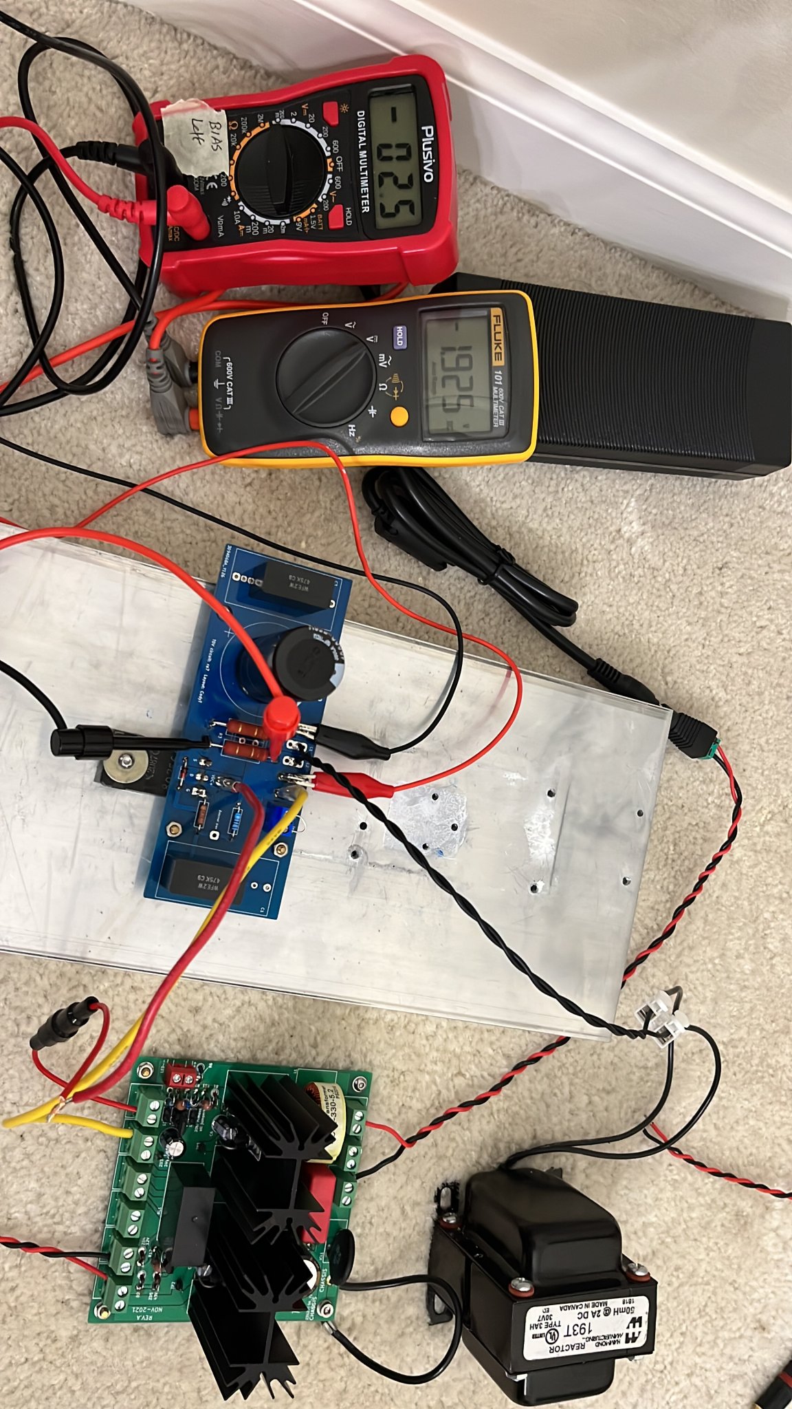

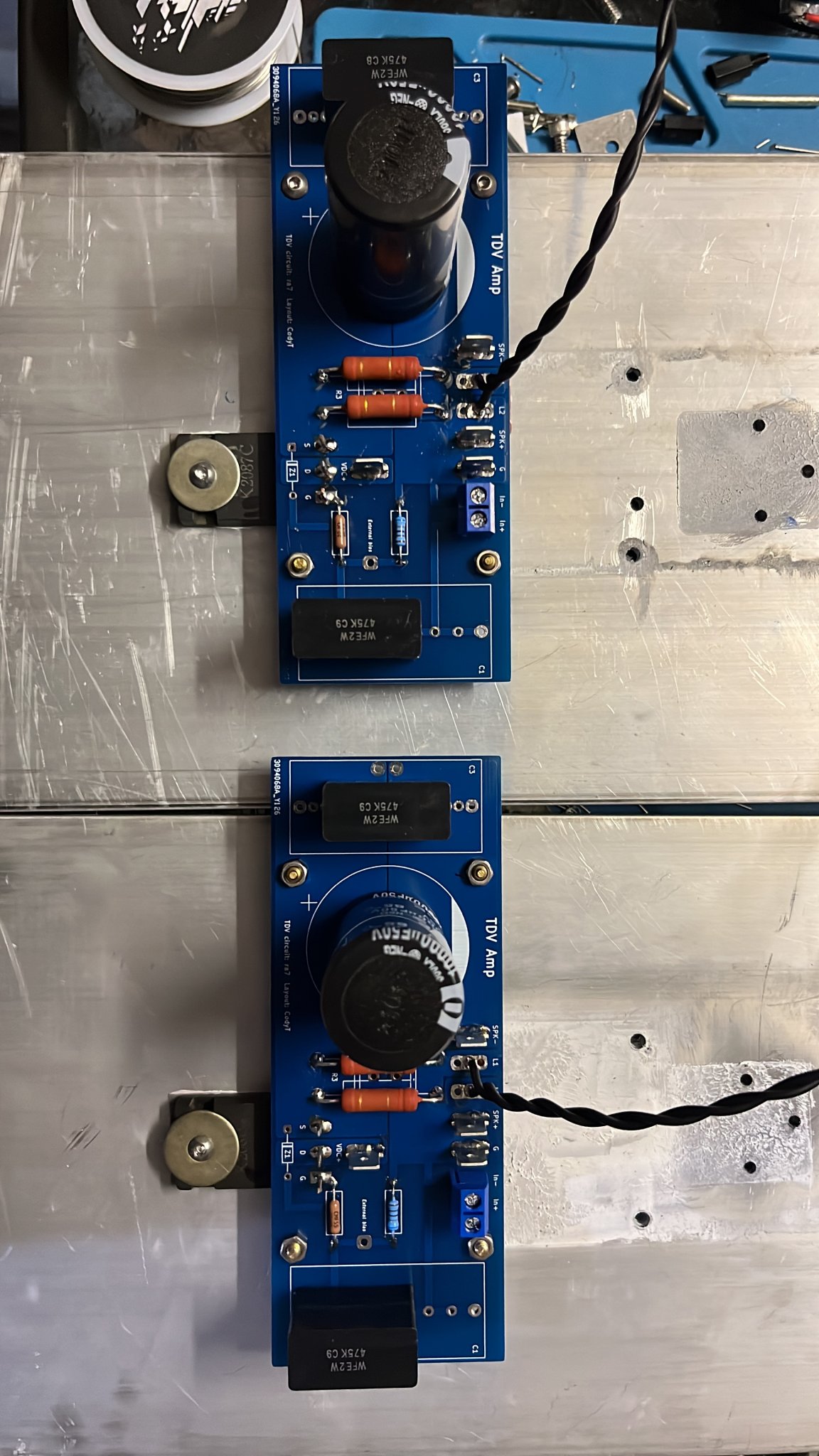

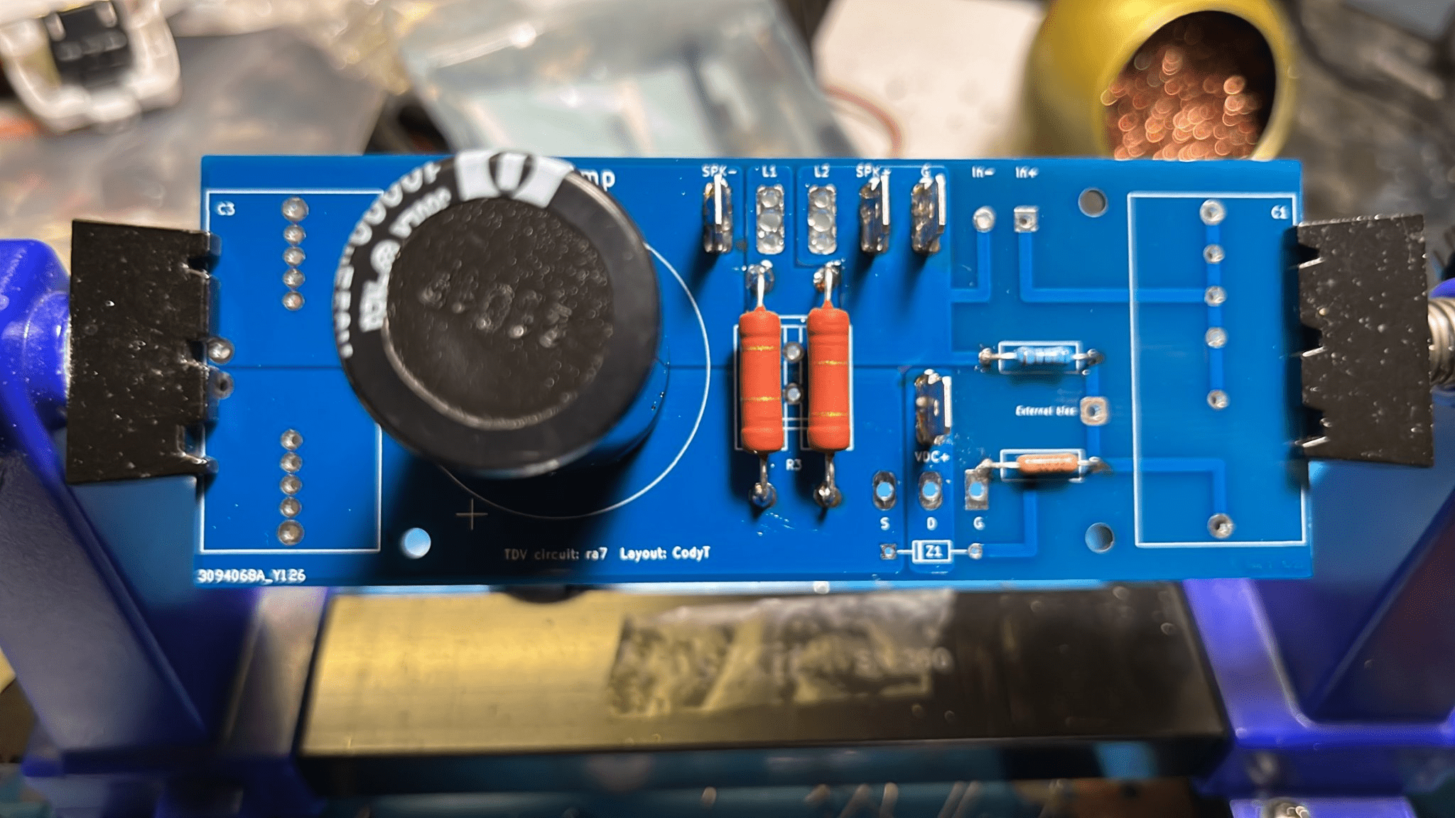

My progress so far and I went with suggestions from ra7, CodyT and Eric looking at my parts bin what I could find to meet the schematic. Used 22R, 6.8k and then 2.2R *2 for R3. Will solder a 220/3w resistor across the spk+/- as per the original schematic instead of 470/3w suggested as I have these resistors with me.
Will be using 2 of the 4.7uf film caps and then a 18v zener diode. I am going to repurpose the 193T from the LU amp as well as the 24v 5A smps along with the Tuba filter 🙂
Done with the boards except for the zener diodes.
