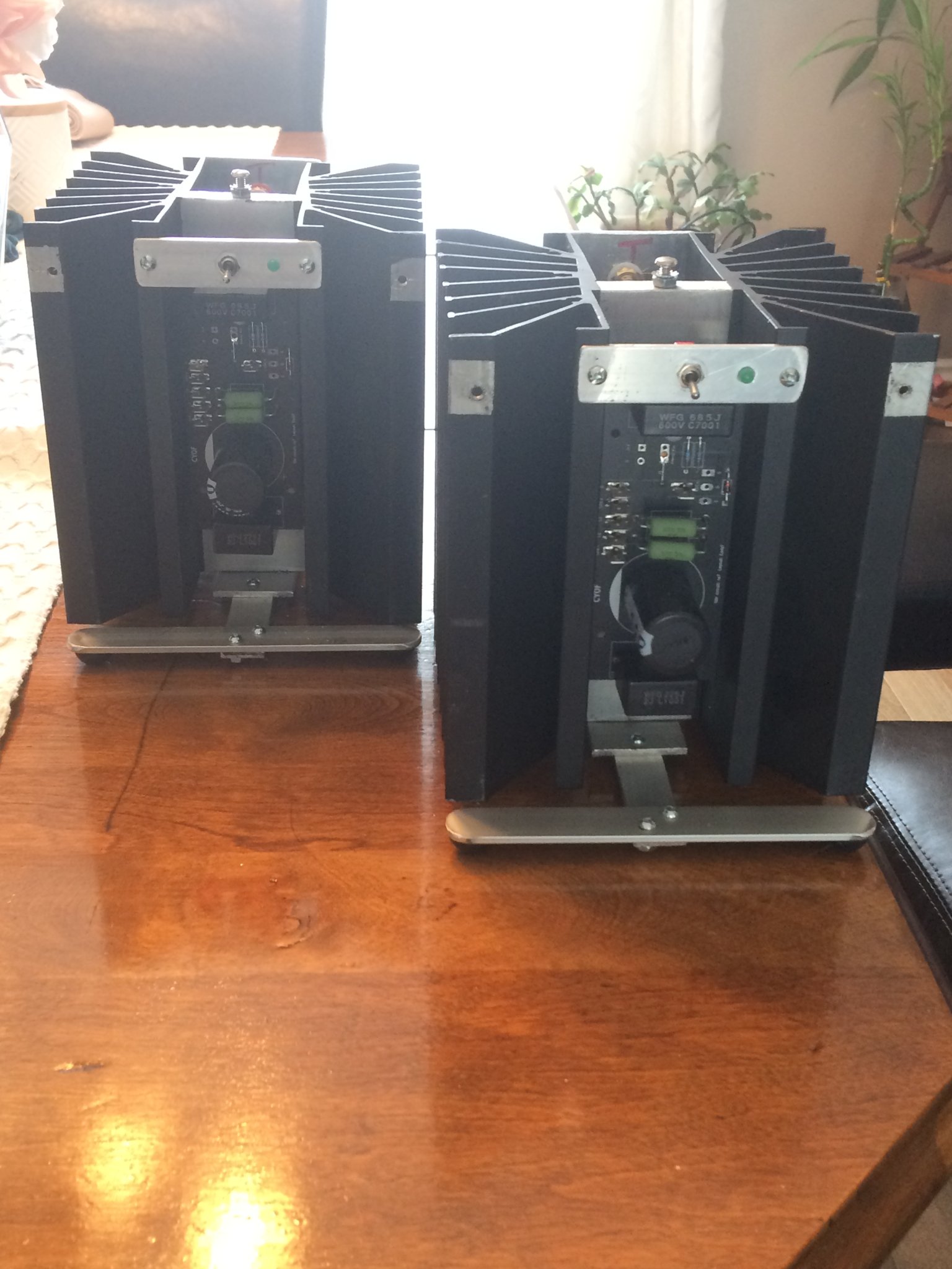

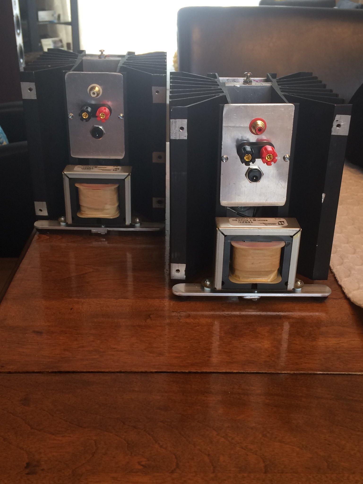

Just for fun, below are pics of my TDV monoblocs. Physically they are done, I kept the rugged industrial look, what’s left is the wiring. I’ve never heard a VFET/SIT so I can’t wait.
This design comes from the idea that I had some 0.44c/w heatsinks I wanted to use (6.5” x 6.5” x 7” high) so I managed to have the heatsink being the amp...nothing else needed except the power supply.
Each monobloc will be powered by a 24Vdc, 5A smps + Mark’ Filter.
Thanks to all who made this possible 👍

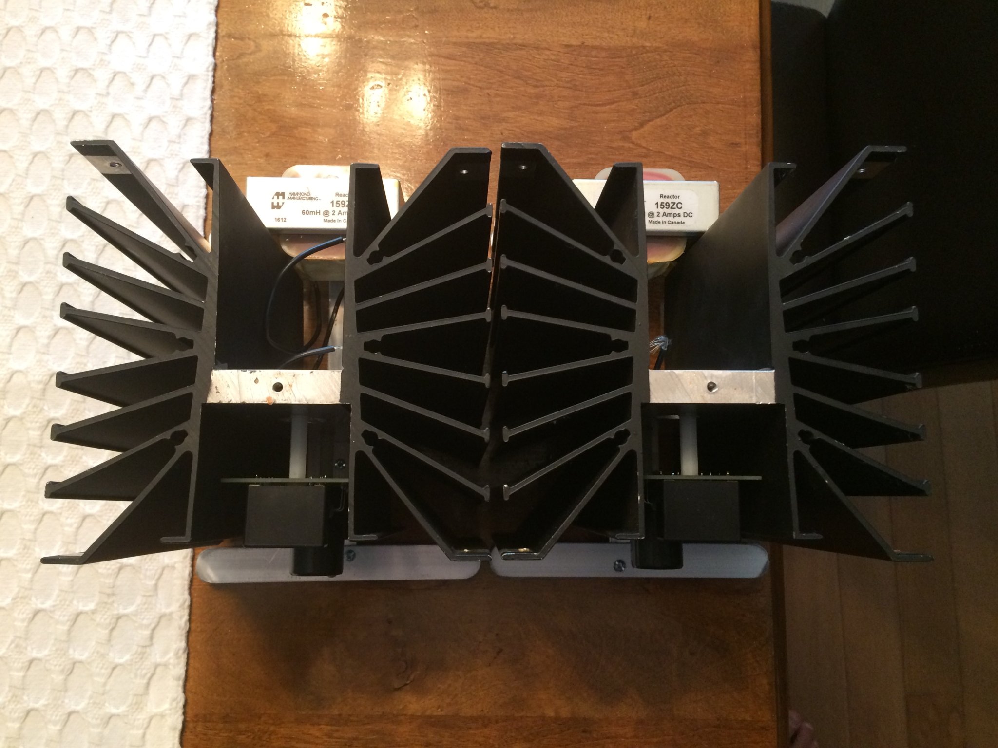

Older pic showing the top view
Eric
Eric
Where did you get these wild heatsinks?
It’s a member of Canuck Audio Mart who has a bunch for sale, each heatsink is $4 usd...Where did you get these wild heatsinks?
